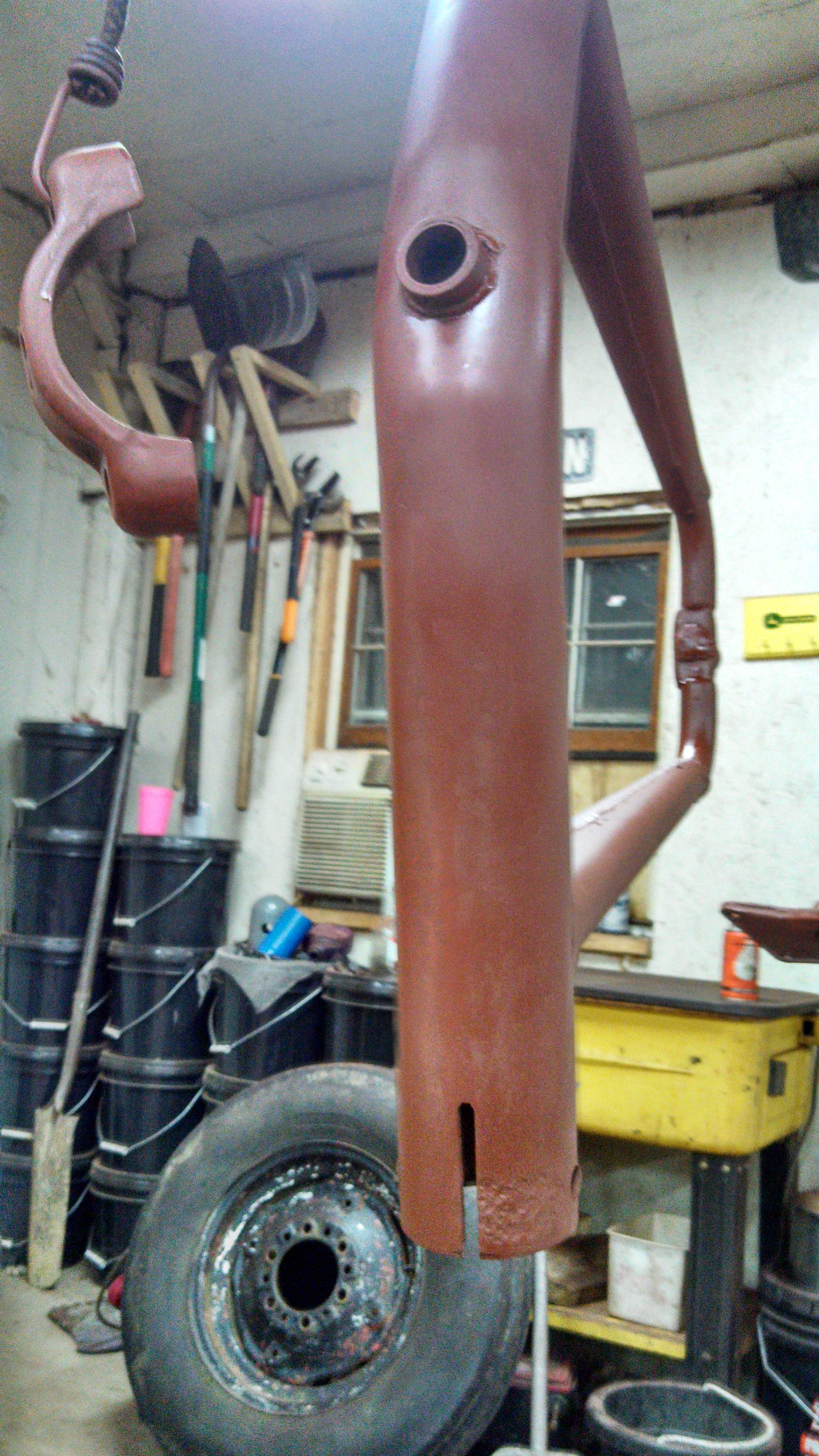

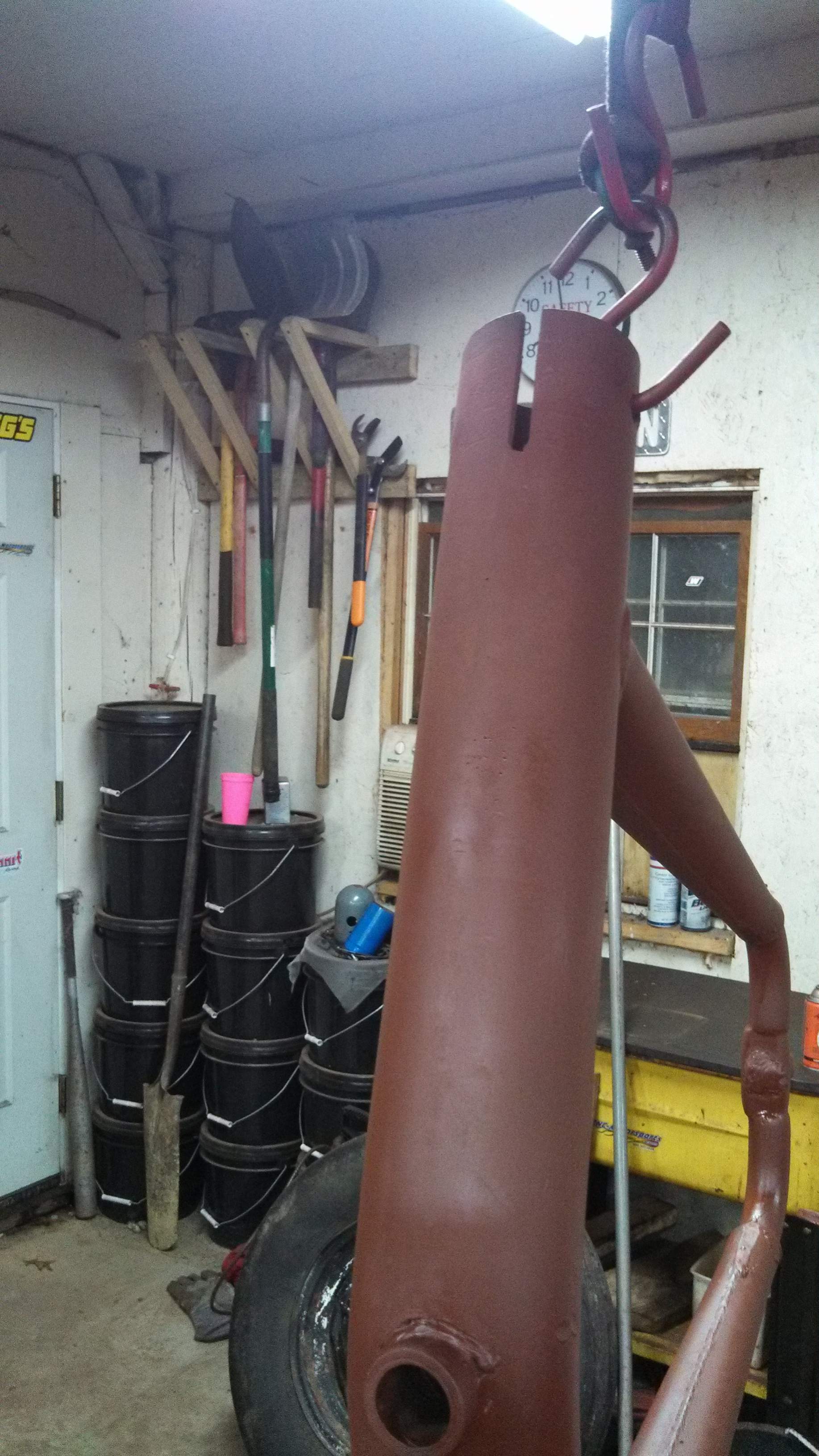

Nice job never know they were split.
Sent from my iPad using TractorByNet
   / IH 300 Utility....My new project #102
yep.. they all got their issues. even the U channel ones. they can get tight when rusted.
#103
LD 1
Thanks. The pics really dont to them justice. The shadowing/glare makes it look like there are lines where the weld stopped. Not really a good pic. I'll have to get some more, now that I have got a coat of primer on them...
Any of them have to be better than spending a day to get apart. Tube in tube with tight fit just sucks.
I like the style that is two heavy pieces of steel bolted together. The 2040 dad had as well as the 8n are like that. :thumbsup:
