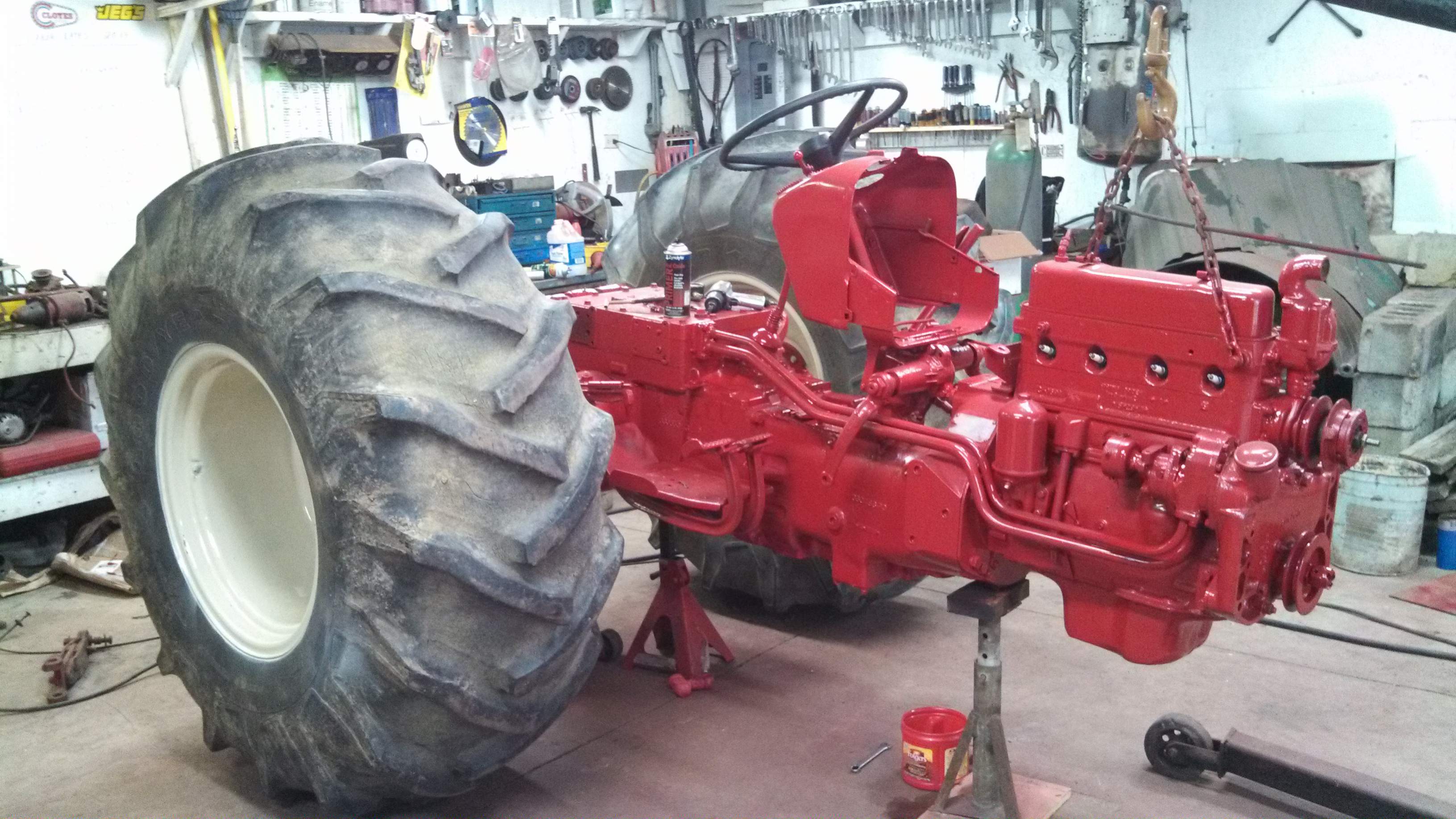

and she might float too!
   / IH 300 Utility....My new project
#92
Certainly lots of air in there.....hmmmmm
#93
Just looked at a chart.
tires would hold 107 gallons of water @ 75% fill, so about 143 gallons of volume each tire. Total of 286.
Thats about 2300# of floatation there. Given the mass and the water that would be displaced for the rest of the tractor....it might be close. But I certainly aint gonna test it out:laughing:
   / IH 300 Utility....My new project #94
I think it looks good
kind of like a pulling tractor without the HP

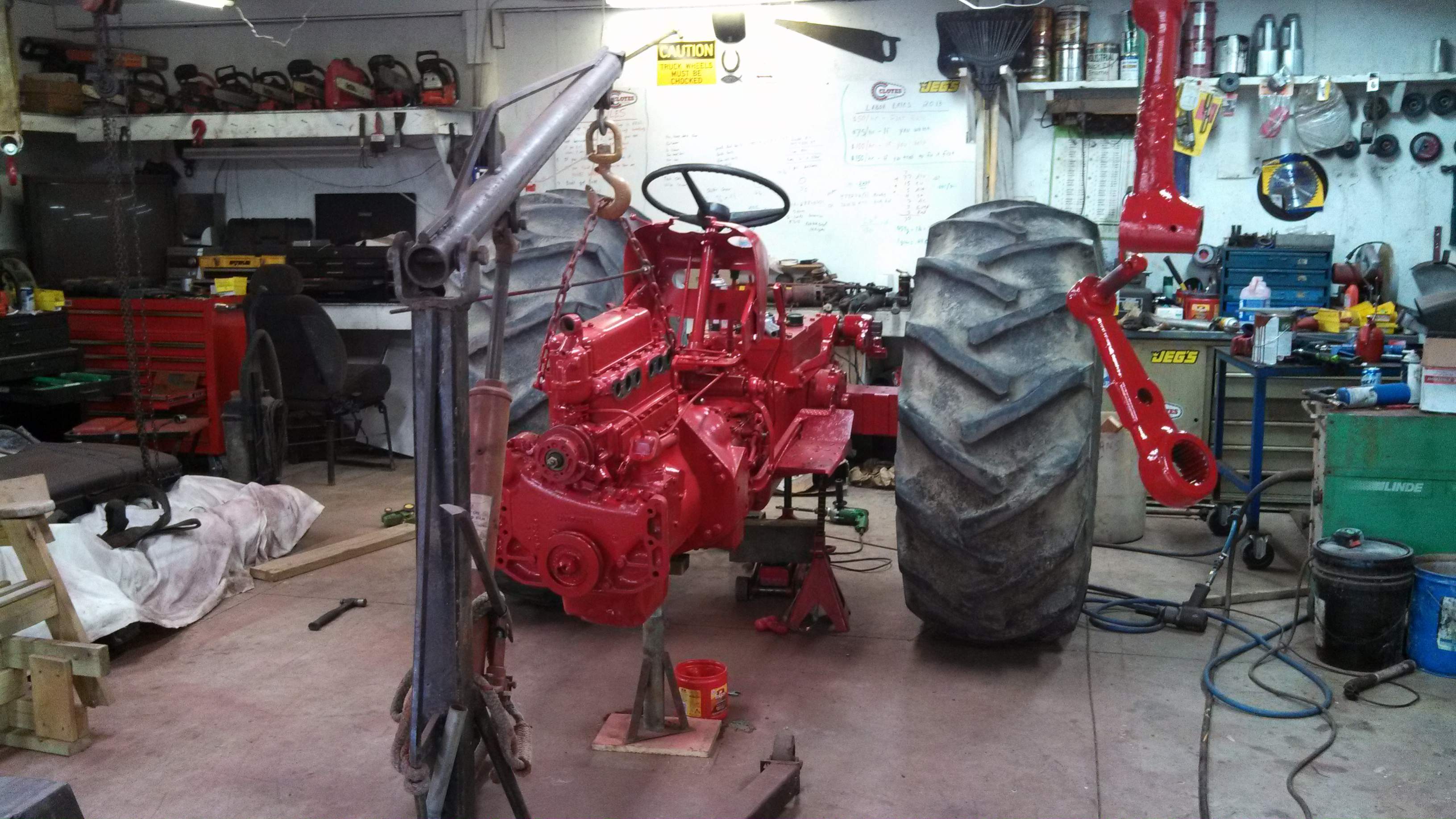

No some guy scrapped it for him. They were going to take it with the tires, but was too tall. So they deflated the tires (and thats why they were off the beads when I got them), but still not low enough.
So they left the tires.
I ended up going to NAPA to see what they had.
Not much, but will make it work.
All of their 9/16 "bolts" were even a smaller hex than mine, @ 3/4". And all of their 5/8" bolts were only 7/8", But they did have 2 lug nuts that were 5/8"-18 and 1-1/16 head. And I had 5 at home already. And they are getting 9 more for me in the morning. They were only a few bucks each.
So I decided to use studs. Their selection of them was slim too. They had 6 that were once style, and take a 5/8" hole to be pressed into, then they had 6 more that were a tad shorter and needed a 21/32 hole.
So I got all of them, and got them installed and tires back on with only 3 lug nuts in one and 4 in the other for now. The other two holes in each tire, instead of getting more studs, I am just going to use 5/8-18 all thread that I have a ton of. Will drill the holes and tap the hubs and then put a jam nut on the back side combined with a little loctite.
So going from 8 bolts that were 9/16, to (6) 5/8 studs and 2 all threads in each wheel, I figure it will be just as strong if not stronger.
I also turned the wheels around to make em set wider to give more room for operator and hitch stuff. So now I wont have to modify the fenders also. And its still under 8' wide. Its about 7'7" now, otherway it was 7' on the money. Either way, too big for my current 6' cutter, and I am wanting an 8' twin spindle anyway.

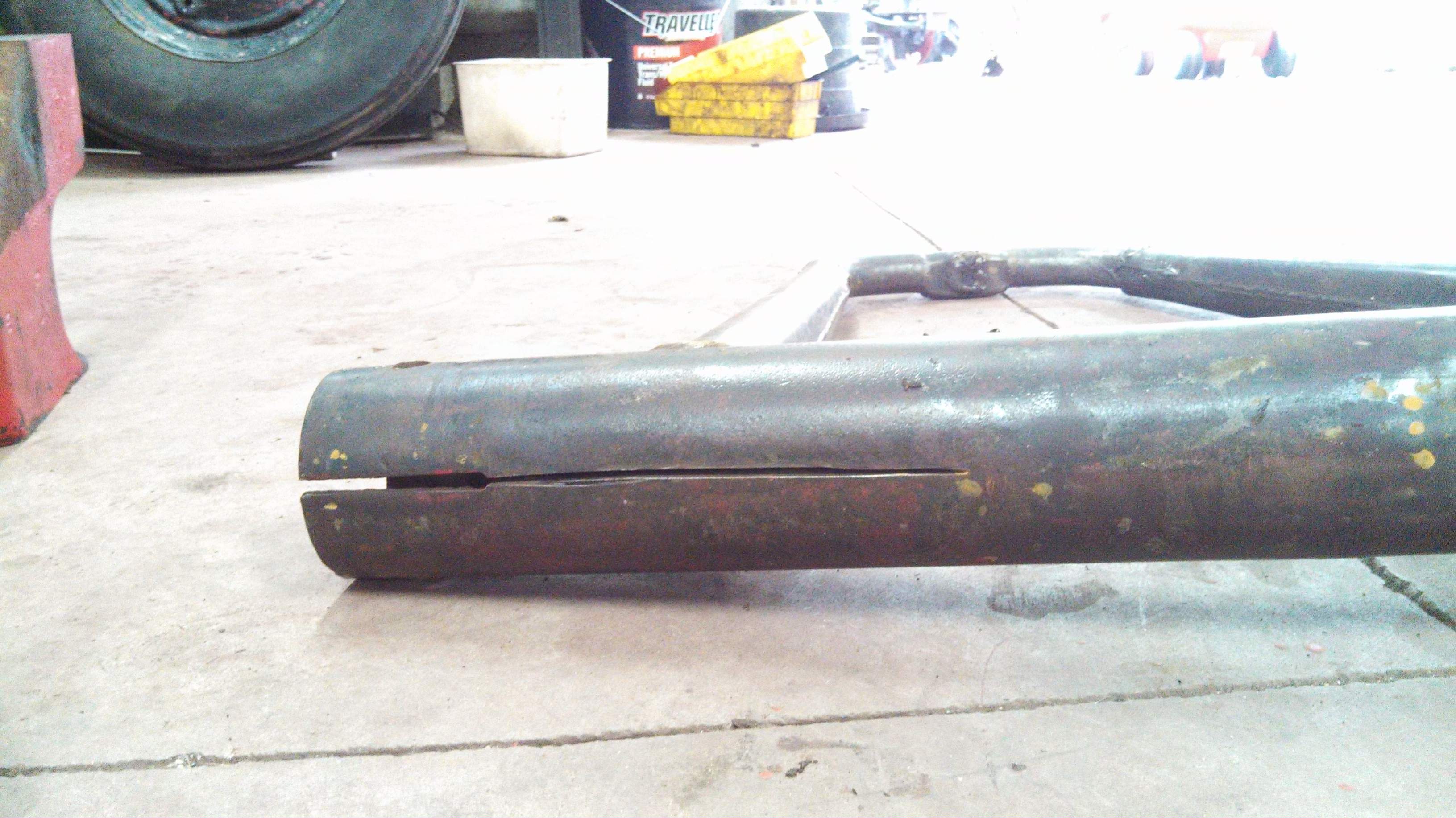

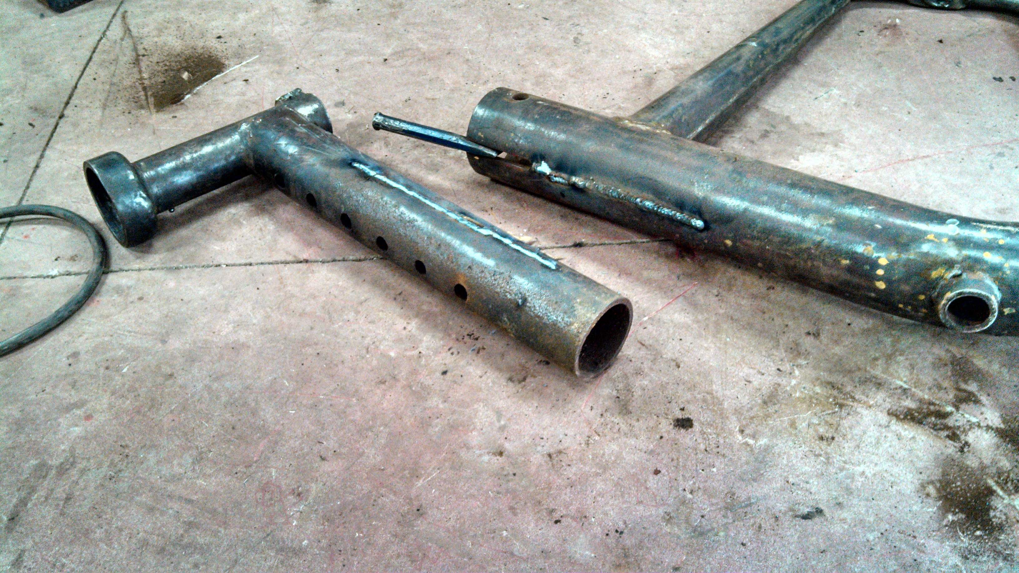

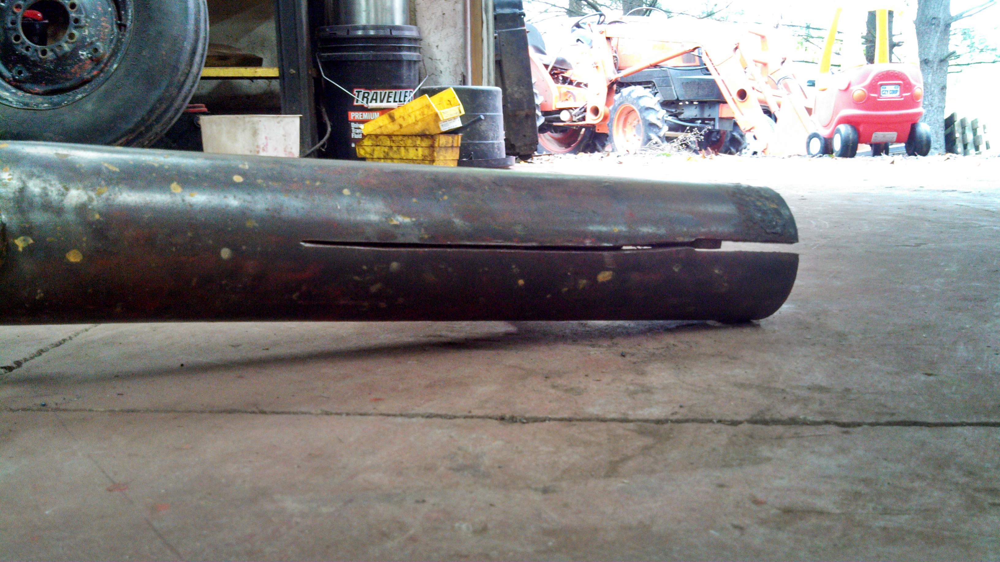

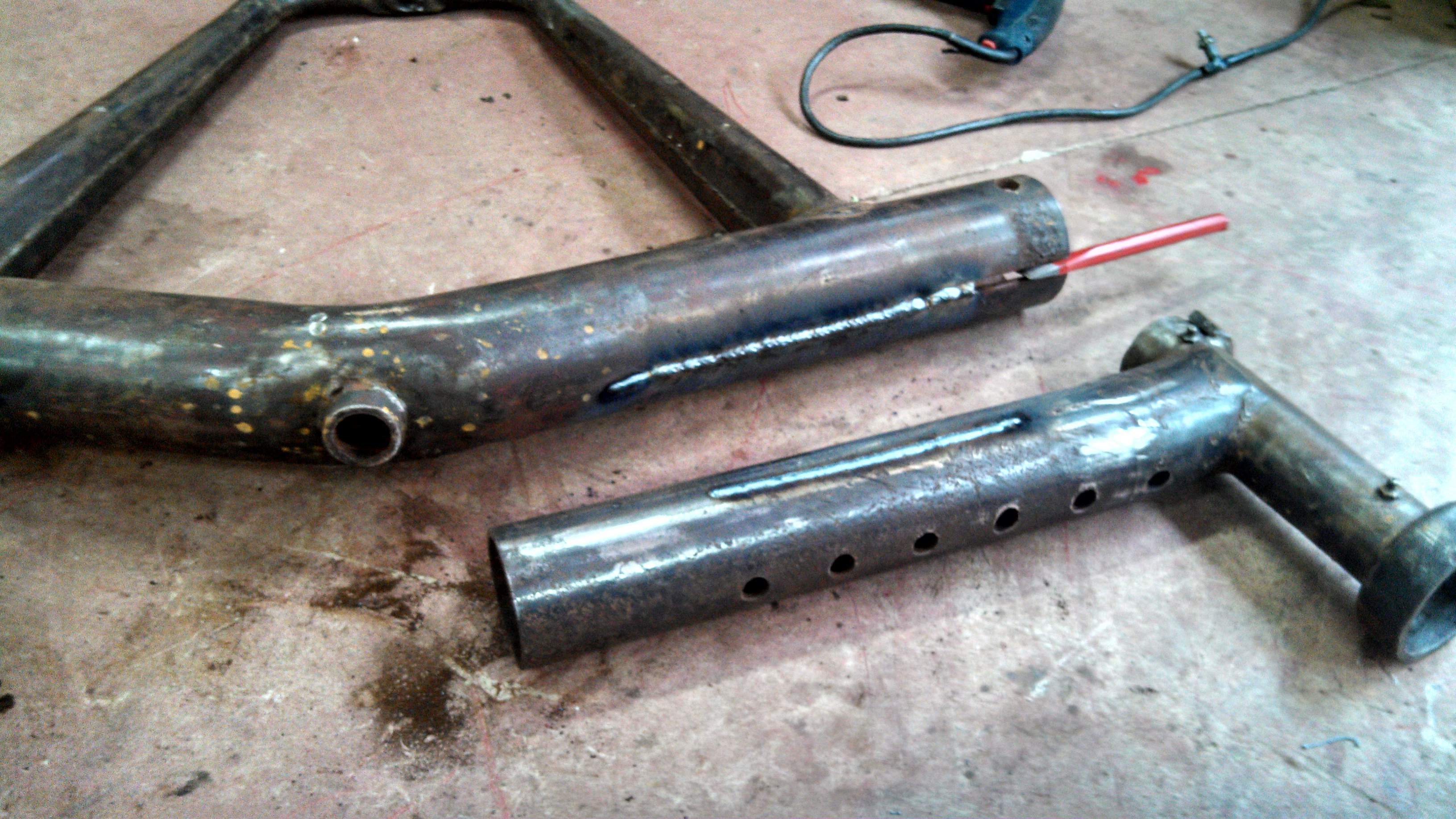

Some more updatdes:
Started on the front axle yesterday.
Pretty much took all day to get the adjustable axle tubes out of the main outer tube. I had to slit the tube more with a grinder and slicer, use chisels for wedges, and lots of twisting and banging and I got them apart.

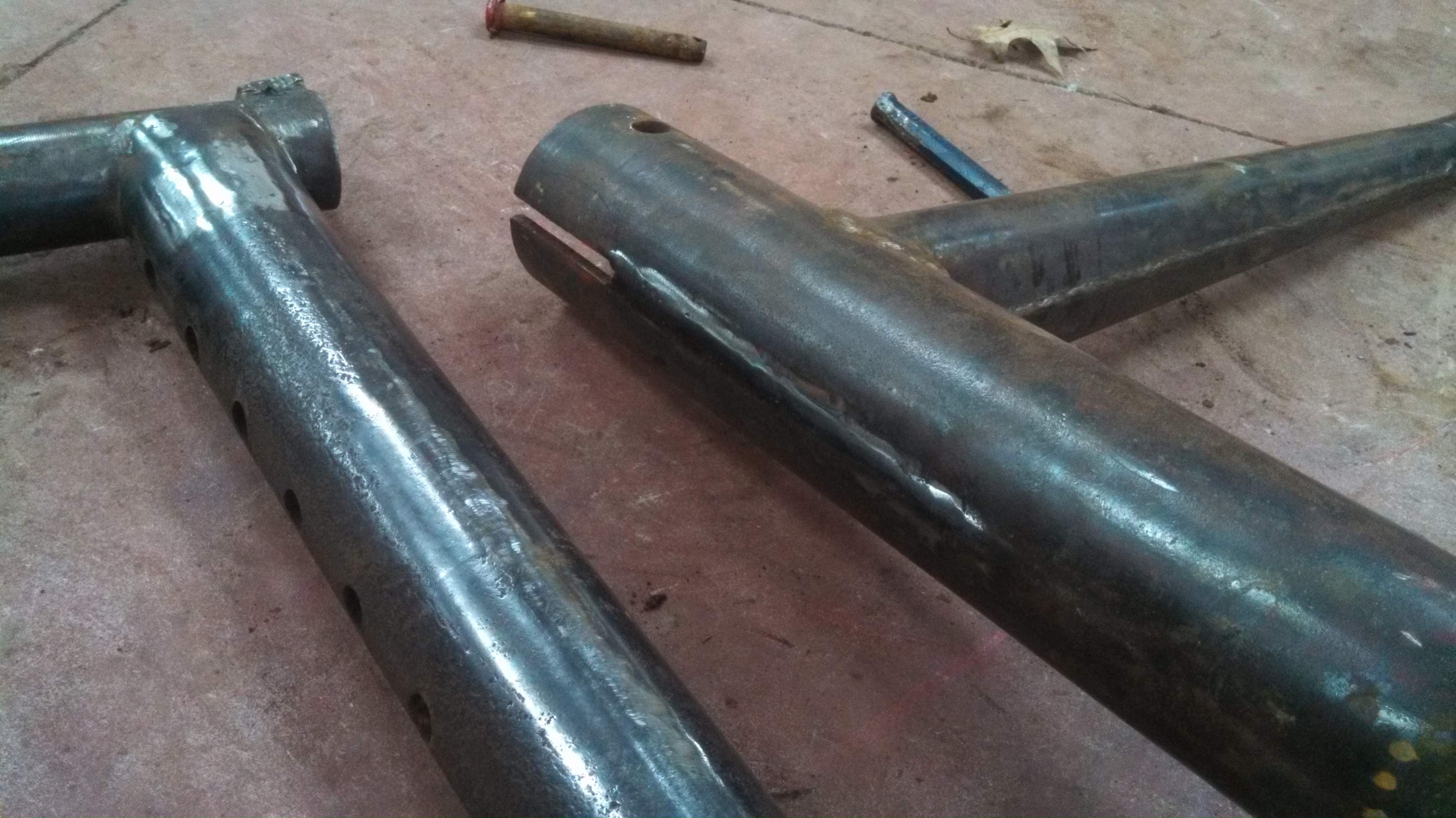

So today I got them all cleaned up:
Re welded the tube back together, with a chisel in there to open it up some before welding to counteract the shrinking effect.
Also had to weld the inside tube also cause I got a little deep with the slicer. And since I am going to widen the front, the slice would be exposed
And all cleaned up so you cant tell

Looks like a good place to use never-seize. You never know when you may want to change the width again...
#100
That is certainly the plan. Them puppies were rusted in tight. I can say I really dont like tube in tube adjustable axles.
