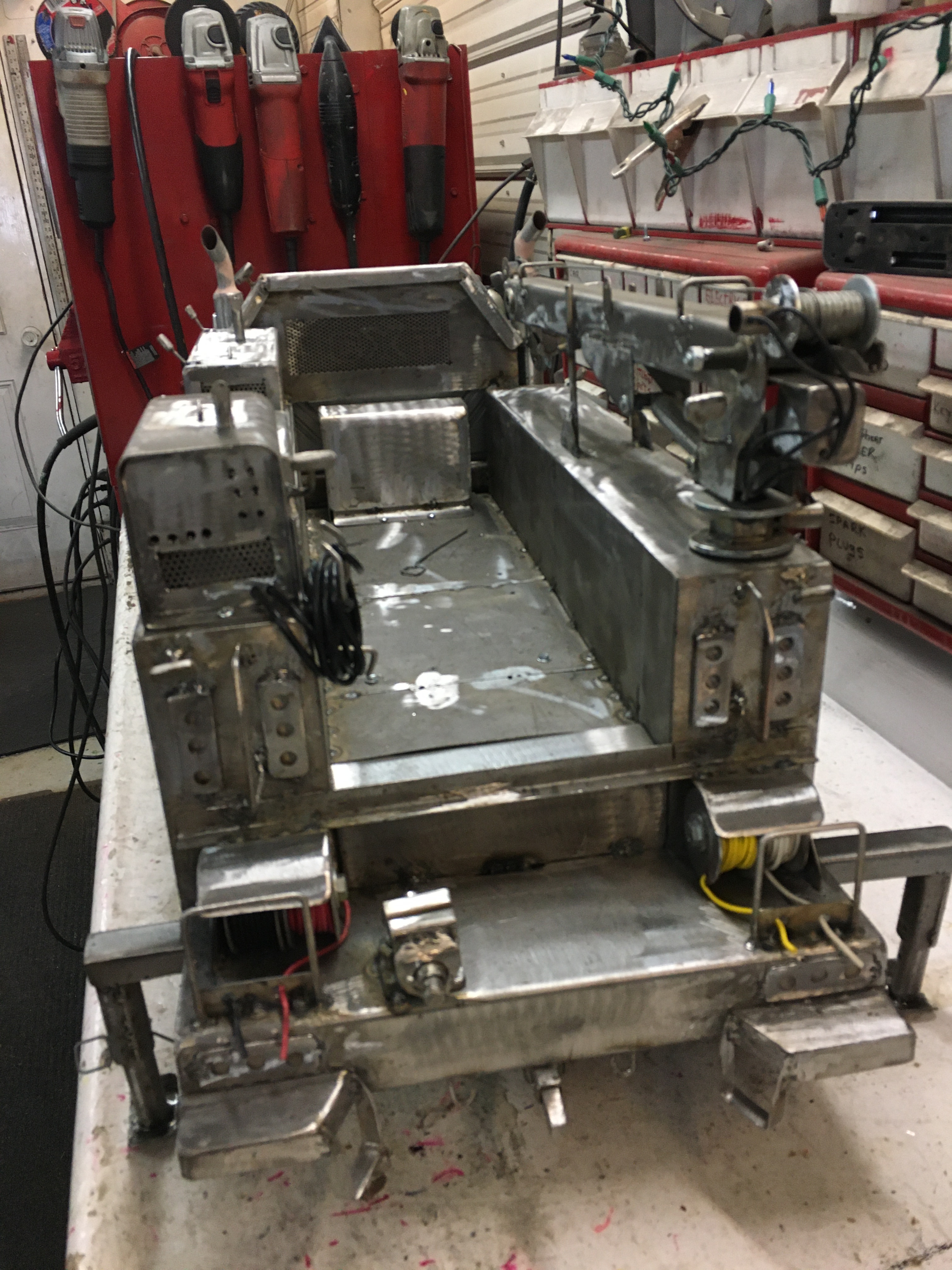

Haven't weighed it yet ??
Back to the service truck and will get it roughed in this week. I added a rear bumper, tail lights, rear steps, a work vise, 4 lube reels, 8 more spot lights, a Welder and a aux fuel tank and a air compressor unit on the left side of the box. Also a light bar behind the cab. Now I am working on flaring the rear fenders. Next week I will return to the double trailers grain semi. IMG_2861.JPGIMG_2862.JPGIMG_2863.JPG

You must be Tigging everyting what size torch are you using ? My buddy has a micro or jewlers tig it's tiny but can get into some spots where you would could never thought you could weld . I luv the service truck.:applause::drink:

I just have a cheap little 135 amp welder and use .030 flux-cored wire. Could never afford a nice welding setup. Thanks as always for all the kind comments. Making toys isn't interesting for most people so glad some of you enjoy seeing them. I finished the parts today and started filling the rough spots. I should get the service box sanded and primed tomorrow and I'll share the next step photos. It will look much nicer and cleaner then.

I'm surprised that you can get that clean and splatter free weld from a flux core welder.:thumbsup::drink:
