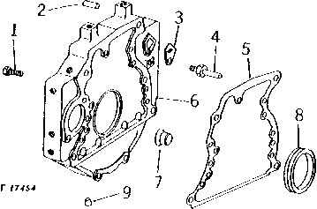

Your problems sounds a little extreme for this to be the source of the problem, but it is worth looking into: Check your ignition timing. An engine that has its timing significantly retarded can generate a lot of extra heat. This may not be the whole problem, but it might be a contributing factor.
There's no timing mark on this engine. Believe me--I've looked. The only way I can adjust it is to set for max RPM--other than make sure the point gap is correct.
There is a timing mark on the flywheel that can be viewed through timing hole in flywheel housing by removing cover(parts key 3) Have you checked rad cap to be sure it holds the correct pressure??
