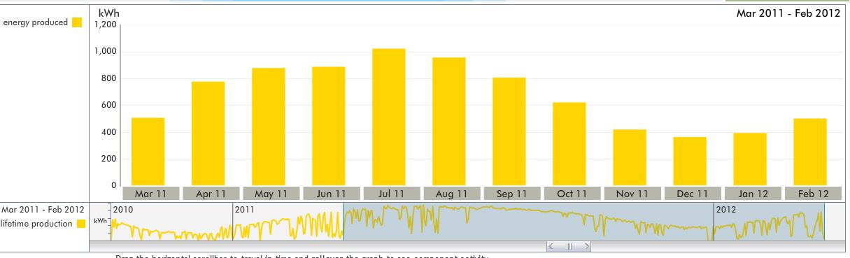

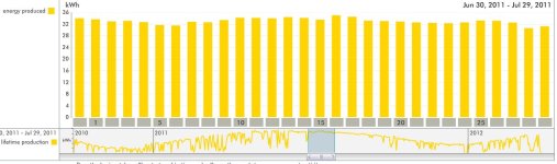

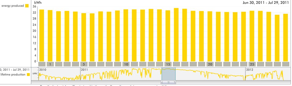

I figured out how to get back online for our solar. Here is graph of past year, and July 2011. At the bottom of both graphs is an overall lifetime; ours goes back to September 2010. Scale is not good, but can see trend.
One thing I did not see mentioned here....
We reroofed just before the panel went on... We were due anyway. But, as much as we like our results, I would hate to reroof and have to pull these panels up...

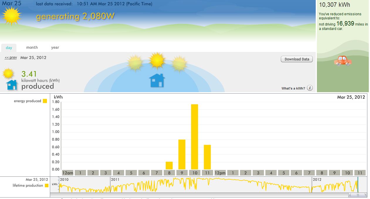

Today, so far. Overcast with sprinkles here and there.
