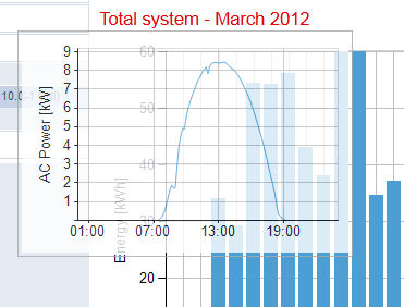

Here is a good example of a "good" day. As LD1 says, you only get the peak output around noon.

Yes that is my TOTAL rate. It works out the more you use, the less it is per kwh too. But my TOTAL rate averages 11 cents right now. That is the TOTAL of my bill/kwh usage. My last bill was 2396kwh usage and $251. That is about 10.5 cents. And up until about a year and a half ago, it was consistantally 8 cents. Than around november 2010, it started creaping up over about 6 months to the ~11 cents I am at now. And it has remained pretty stable for the last year. I track everything on an excel spreadsheet. For 2010, total yearly usage was 23,607 kwh and 2011 was 23,128.
Even as efficient as those inverters are, look at the WHOLE. You say you have a 6.4kwh system and are on pace to do ~700kwh this month.
We have a little over 12 hrs from sunrise to sunset in march. Using my mentioned 10 hours, and 30 days/month, that would be 1920kwh. Even only using half of the 12 hrs (6 hours) a day, should land you in the 1150 kwh range, yet you come in at ~700kwh.
Now I know that the first few hours and last few do little. I understand that. And understand that mid-day is optimal. I am not trying to dis-credit anything here. Just mearly pointing out how difficult it is to figure these things when you look at a system that is "rated" for X.X kwh, it is hard to correlate that to REAL WORLD numbers. With your system and sharing the info, we are better able to get a REAL Idea of what the production is going to be. Now we know it takes a 6.4kwh system to produce ~700kwh in march and probabally ~1000kwh or so in the summer.:thumbsup:
Knowing stuff like that makes us better able to calculate cost of payback more accuratly than trying to use what the pannels are "rated" at.:thumbsup:

And thats probabally a pretty realistic figure. They break it down by month. And according to Rob-d's chart, it appears his 6.4kw system is on pace to do 600-700kwh this month. And the pvwatts site lists a 5kw system producing 507kwh for march. So thats probabally pretty close to real world #'s.
