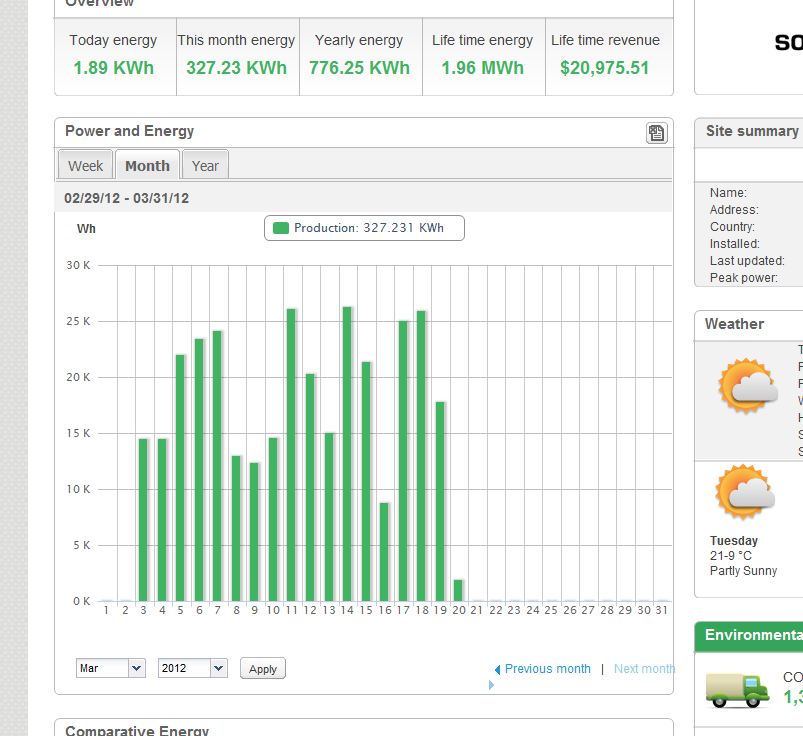

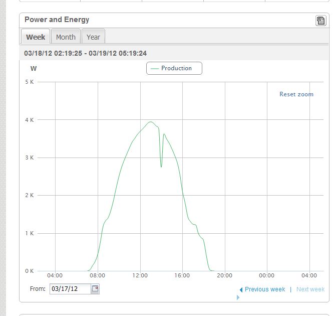

I installed a 9200 watt grid tie system last year. So far I have been very pleased with my low electric bills, and we are not yet in the prime generation "season".
I was one of the last to get a PA state rebate before the money ran dry. However today the reduced price of the panels offsets the money that I received from the state.

First, batteries are rated in cycles, that is, the deeper you cycle and the number of cycles determine how long the batteries last. So someone like me who has an off and on grid system that is greater than the power they use only employs the batteries when the power is down (3 or 4 times a year for me)
Batts have been in 6 years.
cost me ~1.6k
My intertie is 6.4KW
My off grid is about 1.8k with about another 3.5k going in this summer.
The intertie was free the rest of the system cost me about 15k and another 5k this summer, take 30% off both for rebates (~ 14k total cost)
The microhydro and wind will come in under .5K cost.
All electric except stove (gas) about $30 to $40 a month.
No AC, only need AC about 10 days a year.
Heat with oil, going to alternate energy this summer.
Rob
