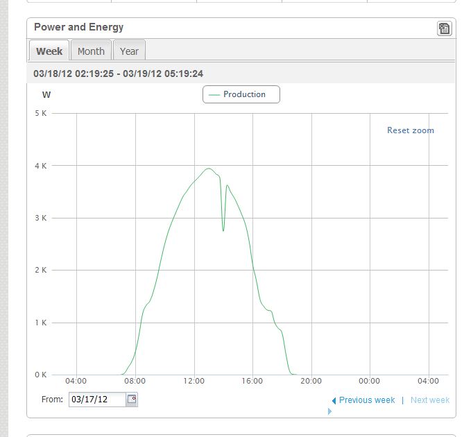

Here's two screen shots of my intertie. SolarEdge1 is my monthly output so far this month. The second pic is an analysis of one day (Mar 17). So I also have a screen that shows all my panels and I can immediately see if something isn't correct.
I don't really have to check my system but it's nice to see what's going on. I like the SolarEdge because it's an MPPT. For those of you who don't know what MPPT is, let me explain.
MPPT stand for Maximum Power Point Tracking. It optimise's the power from the panels voltage and current and gives the best power that the panel can produce... constantly so you always get the most out of each panel.
On my off grid system I have separate chargers that do the same thing. Solar is making leaps and bounds, today's system is much more sophisticated than even two or three years ago and things will only get better.
So today I'm adding panels to my off grid system that are the same size as my 6 year old panels but more powerful.
