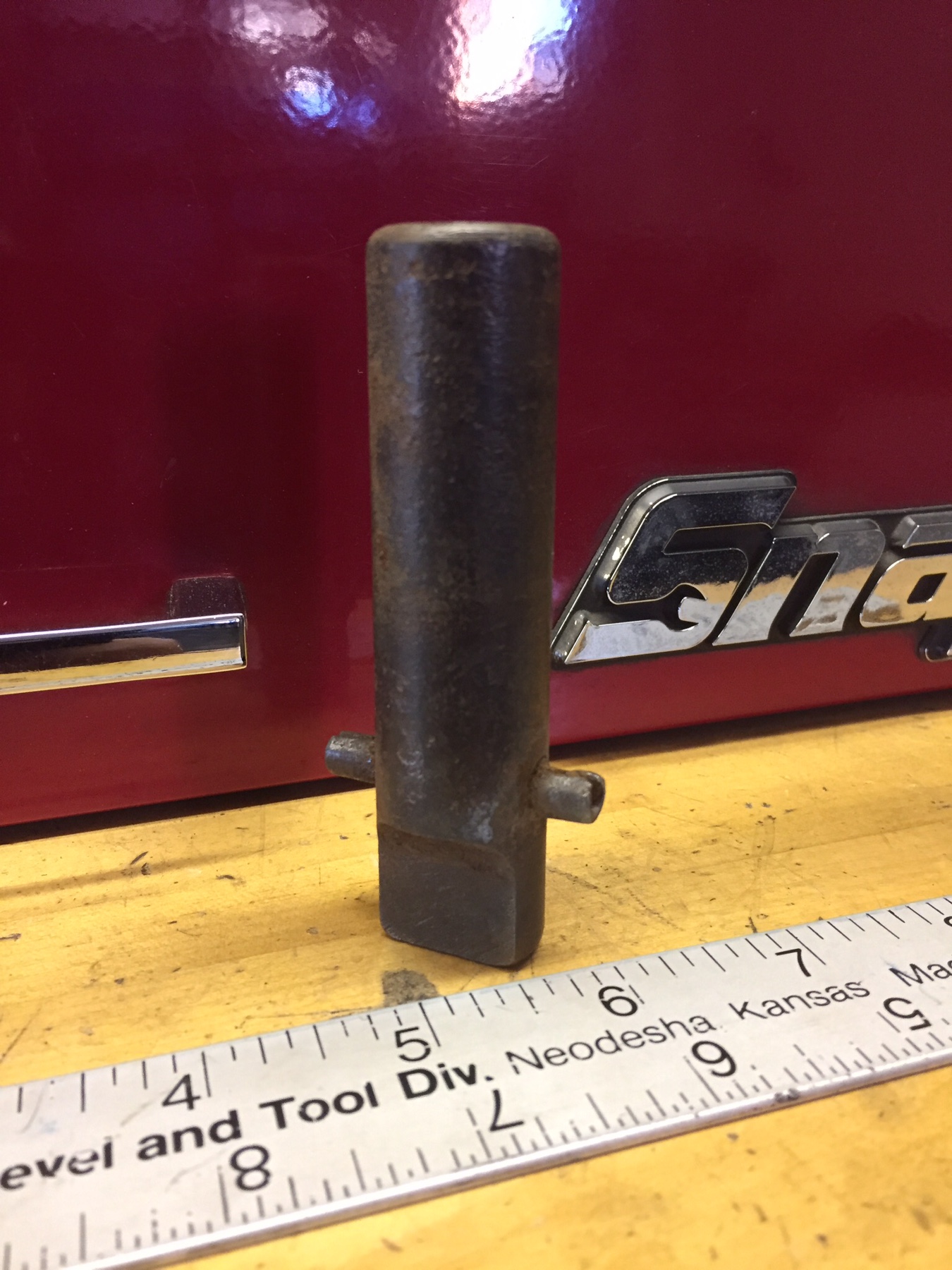

If I recall correctly the Fords (1950's era?) had a quarter turn pin that inserted from the bottom that didn't require a clip on top.
I'll check my parts room tomorrow. None of those tractors still here but for some reason I can picture the pin.
Terry
   / I'm doing something wrong with this drawbar right? #12
Okay. I couldn't wait 'til the morning and I just went out to the shop to check my stash.
Found the pin I was looking for. You guys with the older Fords can correct me if I'm wrong. THIS is what I recall using for securing the swinging draw bars of the 1950's + or - era.
Terry

if that was a ford draw bar you have it in backwards. the hole for that end is the same size as that pin on a ford drawbar. I think that hole is for whatever you are going to pull with the tractor.
   / I'm doing something wrong with this drawbar right? #17
Good call. I think you're right.
Must have been a flat bar with no offset on the implement end for him to insert it that way. Still not the proper drawbar, though looks too skinny.
   / I'm doing something wrong with this drawbar right? #18
I do join the others saying the draw bar looks to be installed backwards and also it is not as thick as it should be. It may not have the strength it needs to support the vertical load that can end up on that draw bar but even if strength is not an issue the slack is. It will allow the draw bar to move up and down a lot and for some implement no issue but if you have a trailer or pull sprayer on there you will get a lot or can get a lot unless the front is is heavy enough to keep heavy weight on the tongue. Also with that slack in there the draw bar is lower on the pin end than it should be so what ever you are pulling probably will not set as level as it should. If you must use the draw bar for a while do get it shimmed to take all the vertical slack out.
