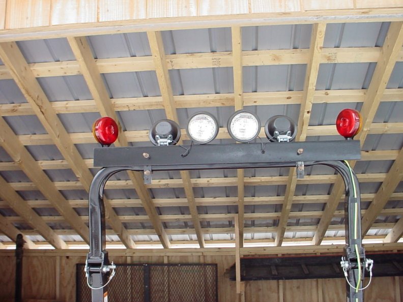

I went through the same thing trying to install lights on my ROPS . I wasn't really concerned about there integrity, But any time you modify something that has been engineered your on your own if you have any problems.
I don't plan on getting rid of my tractor anytime soon , but if I and when I do I don't want that to be a issue.
My solution was to take a piece of angle iron and mount the lights on that. Then I picked up a set of U bolts at the local NAPA store.
I still have to cut the extra lengths on the bolts and brackets off before the spring when I put the backhoe on.
I have included a picture to show how I solved the problem.
Good Luck and I am sure what you decide will work well.

ROPS lights
