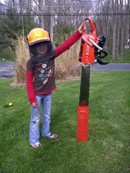

I know a guy who builds 7900s out of used Makita 6401. He puts on a 7900 head, new 24" bar, new chain, warrantees it for 2 years and sells them for $500. Mines not one of his, I found out about him later.
