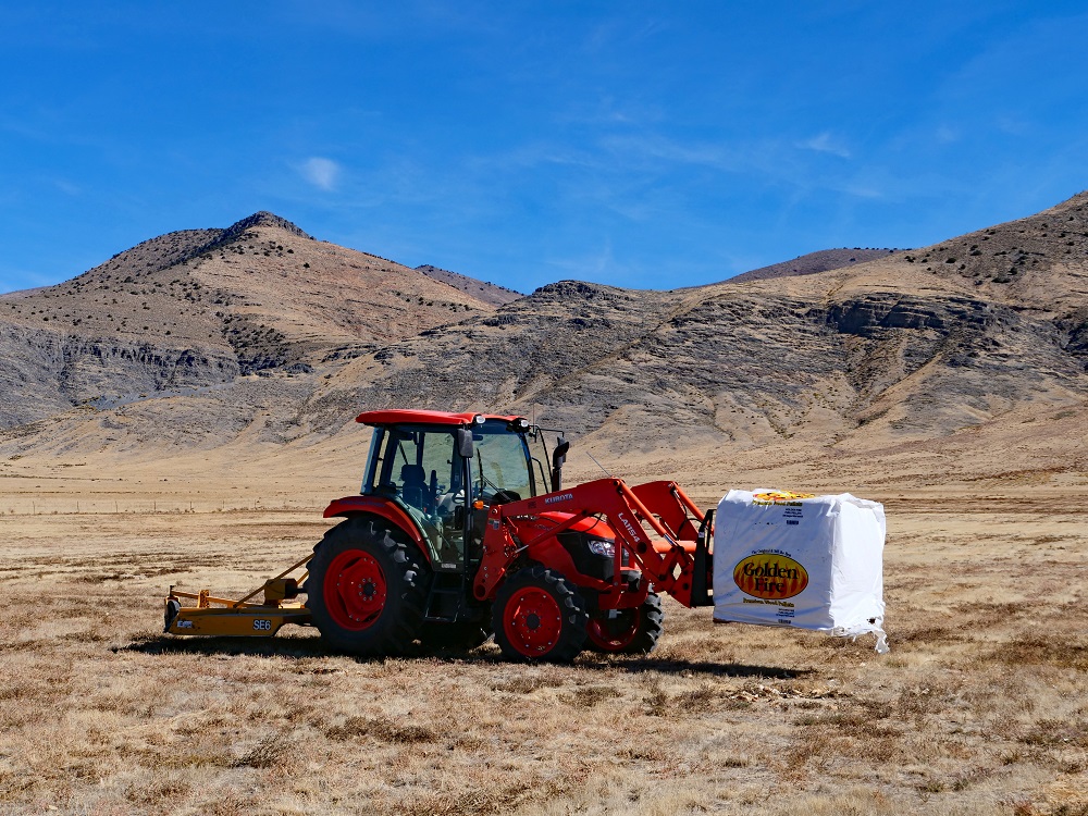

I unload pellets for my pellet stove with my Kubota M7060HDC12. Each pallet weighs 2000 lbs. The Kubota lifts it - but just barely. That's a lot of weight way out in front of the front axle! I have to have the mower on the back, or else trying to lift the pallet just lifts the rear of the tractor. Even so, I have to have 4x4 engaged because there isn't enough weight on the rear of the tractor and the rear tires just spin. The front tires need to be aired up to at least 30 psi because essentially the entire weight of tractor and pallet is now on the front tires. Maneuvering with 2000 lbs on the forks is VERY awkward! I'm glad I have to do this only once a year!
You need to consider getting a MUCH bigger tractor than my Kubota - or a dedicated off-road forklift that will carry the load close to the wheels!

I agree with desert eagle. My M7060 lifts a ton of pellets off my F350. No cab but the rear tires are loaded. I would not want to drive off road with that load even low to the ground. Strictly off the truck right into the garage. It’s a very level short trip. My son works for a tree service. They use a large skid steer like a fork lift. I know they lift way more than a ton with that under some terrible conditions. Not too safe but they have to do what they have to do.
That's interesting, I haven't had my M4 long but it has the 1154 loader and it doesn't notice 2k at all as far as lifting it (an IBC tote of water). I absolutely wouldn't drive that kind of load off road as you said but it didn't notice lifting it onto a stand for a gravity feed system.
