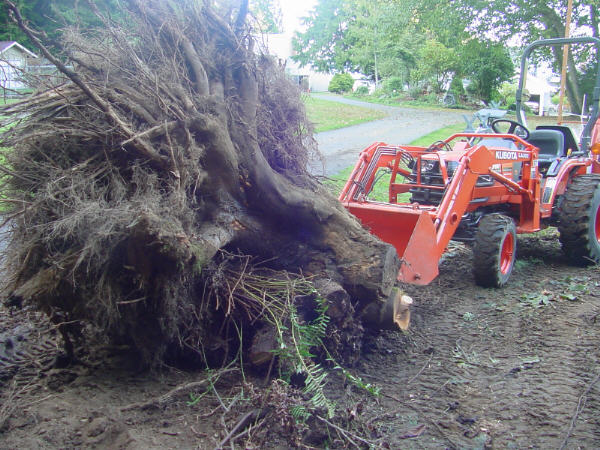

Well, I hope to get at the first of them this weekend.. Much thanks for all the good advice. I'm hoping I dont' unearth monsters like in those photos!!
I have a feeling that my excavation will be complicated by the rocks in this area. I can't dig a hole for a sapling without hitting mega rocks it seems.
