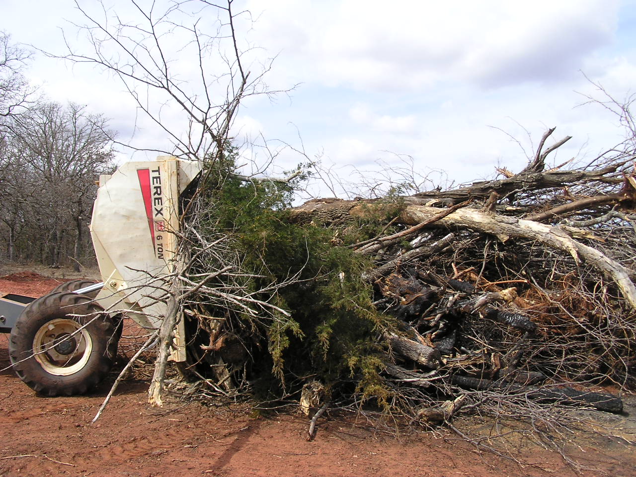

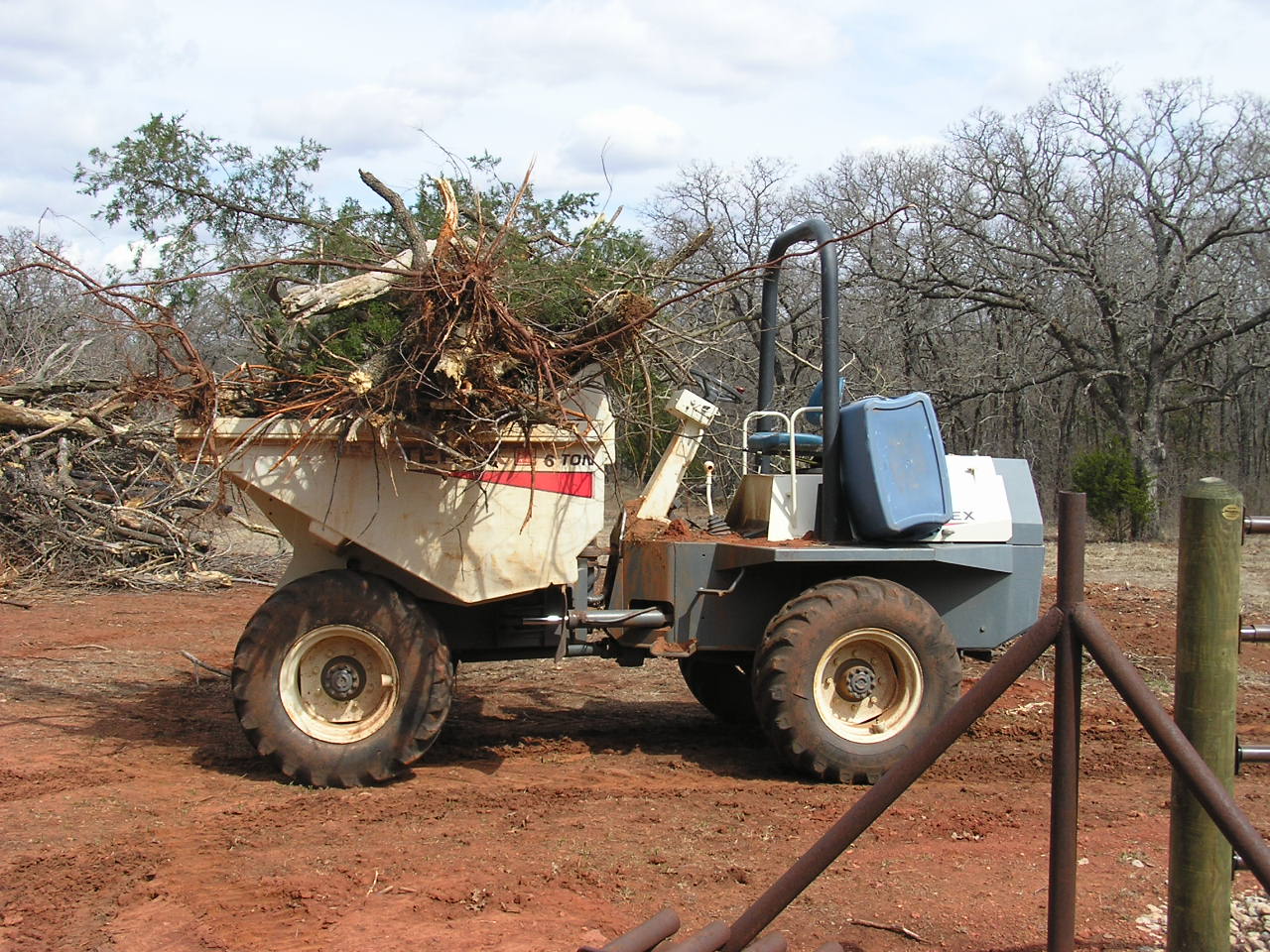

   / I'm without my 422 for awhile....... #6
I don't mind using my wheelbarrow, but it is 4WD. :D
