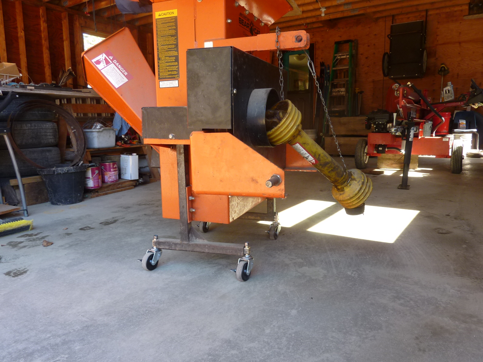

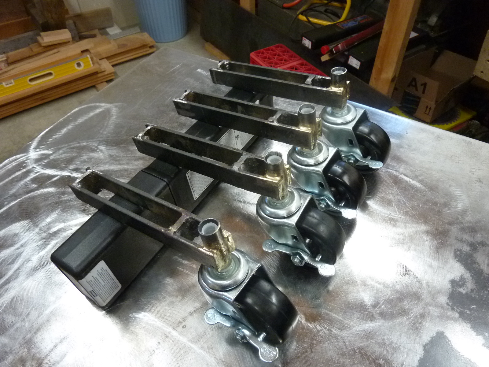

These are a little different might spark an idea. They slide into the square tubing frame on my chipper.
gg
