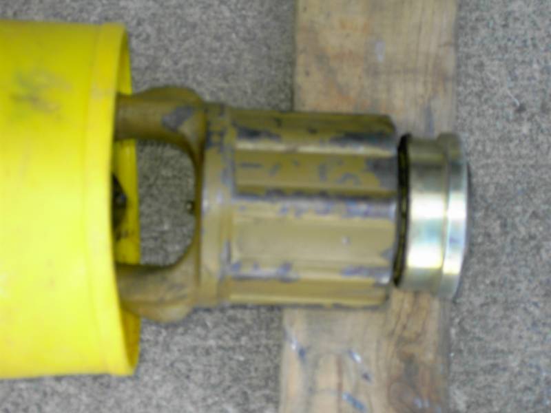

Unfortunatly, it has the pin-type disconnect and not the collar-type disconnect. It is a bit of a pain to get your hands behind the clutch on tractor-side of the PTO because of the shield around it. I'll try to post some photo's in a little while.
It's a bit worrysome to me though. I put it all together and tilled a short patch of garden known to not have any boulders, but it does have some loose rocks. I had the slip clutch bolts very very loose and it didn't slip a bit. I'm thinking it should have slipped even some?

Here's a picture of the slip/ratchet (?) clutch thingy that came came with my 'tiller. Can anybody what it is and what it's suppose to do? /forums/images/graemlins/confused.gif

....... another view

That is in fact an over-running clutch, but they're ordinaily affixed to the tractor's PTO spline - typically with a roll pin. When you take the PTO-driven implement off the tractor, the ORC generally stays on the tractor.
But as I stated before, if you've got a live PTO/2 stage clutch - or a hydrostat for that matter - there's no reason to use an ORC.
//greg//

An over running clutch should not be used on a tiller. It basically is worthless. The overrunning clutch is typically used when you have a mower on the tractor when your PTO is transmission driven like on the older ford tractors. If you didn't use a ORC you could put the clutch in but the tractor would keep moving forward. A tiller would stop pretty fast and not force the tractor to keep moving.
At least that is what I know of a ORC.
murph

That is in fact not an ORC. It is not possible to twist the female spline while holding the clutch body; it does not over-run. It is a uni-directional torque limiting clutch as I described earlier. If driven in the wrong rotation , it provides no driveline protection.

I believe that the torque limiting clutch needs to be installed as close to where the damaging torque input would be in most cases, the input shaft to the gearbox. You would also get your telescoping PTO shaft protected by installing it that way. I've never seen one installed at the tractor end of the shaft (that would leave the PTO shaft unprotected from the torque).
<font color="red">Weasler</font> has some PDF info that you can check.
