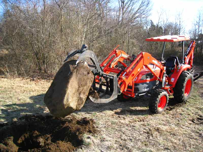

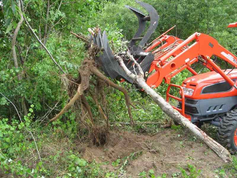

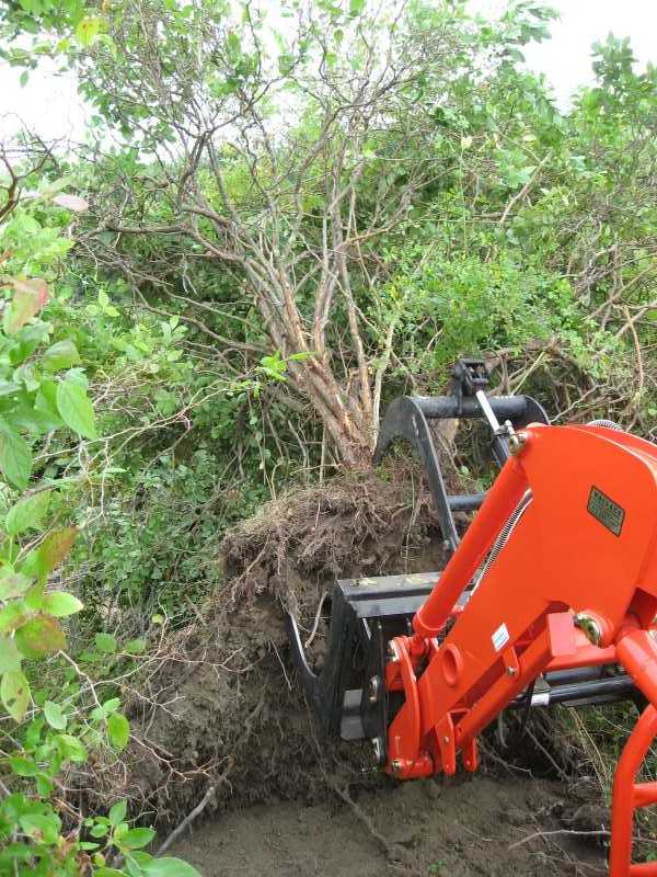

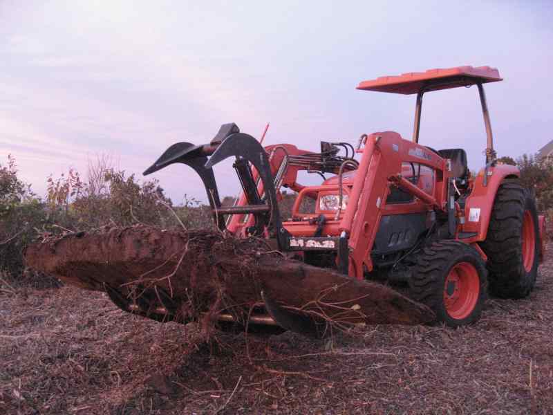

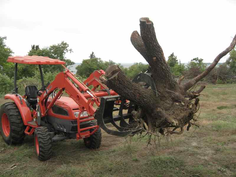

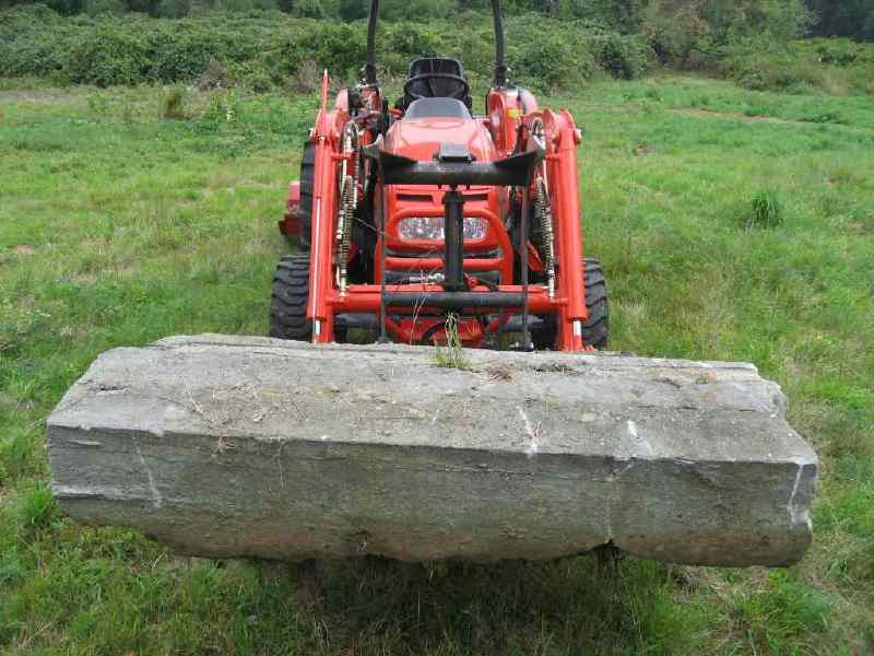

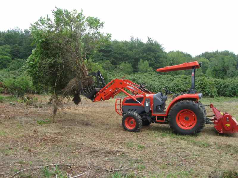

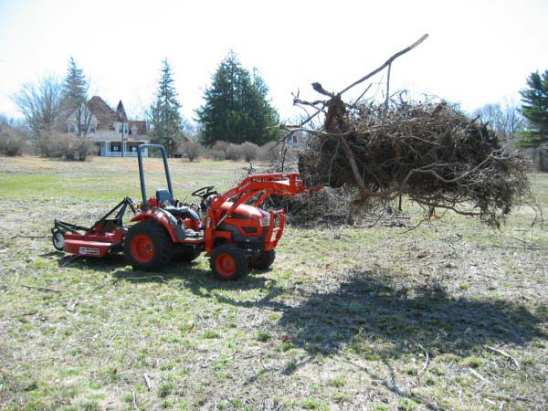

There is a substantial difference in price between the 48LD and the 60LD. You don't mention the actual grapple quote but I think guys are getting quotes of between $850 and $1050 depending on the mount plus shipping. I'm sure Millonzi and dealers are recommending larger grapples for a 50hp tractor. I just haven't been convinced that a larger, heavier, more complex and significantly more expensive grapple gets you much more capability than the 300lb 48LD. I've posted a bunch of photos elsewhere in TBN.
Here are some things that a 41hp tractor with a loader (KL401) about the same as a JD400x or a Kubota LA853 can do with a LD48. The last photo shows the amount of brush I could grapple with a smaller tractor and same grapple.
