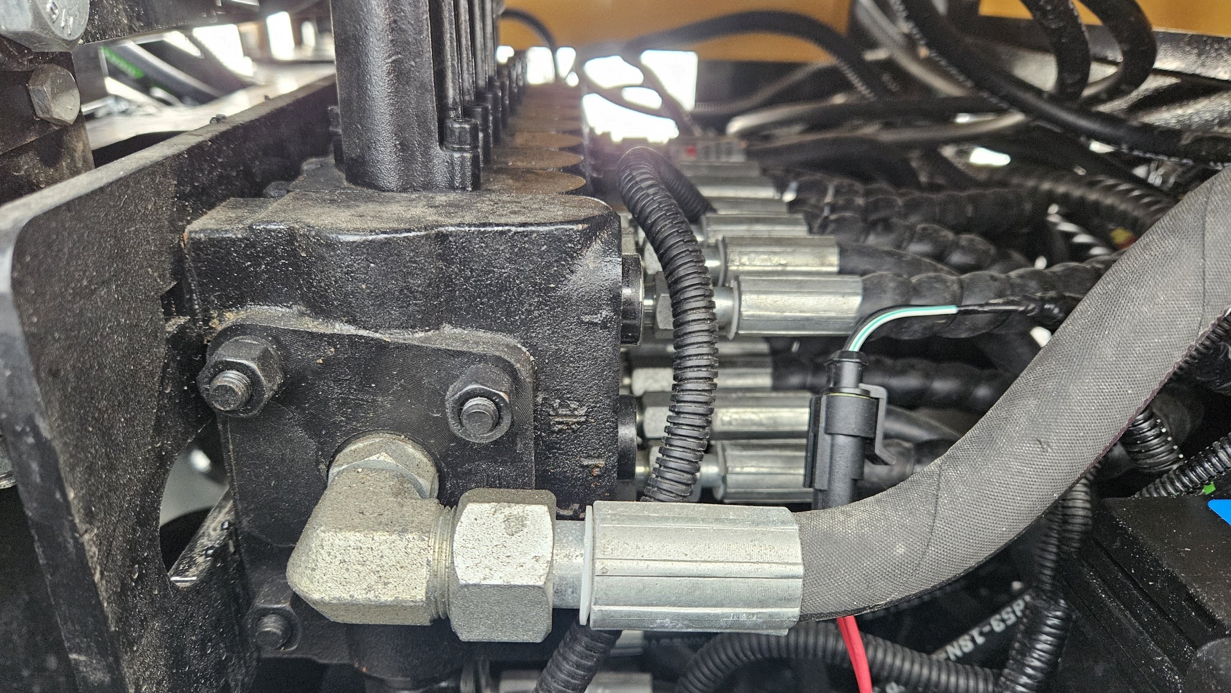

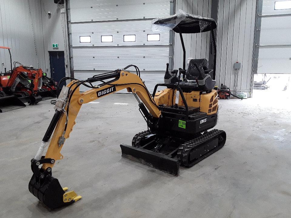

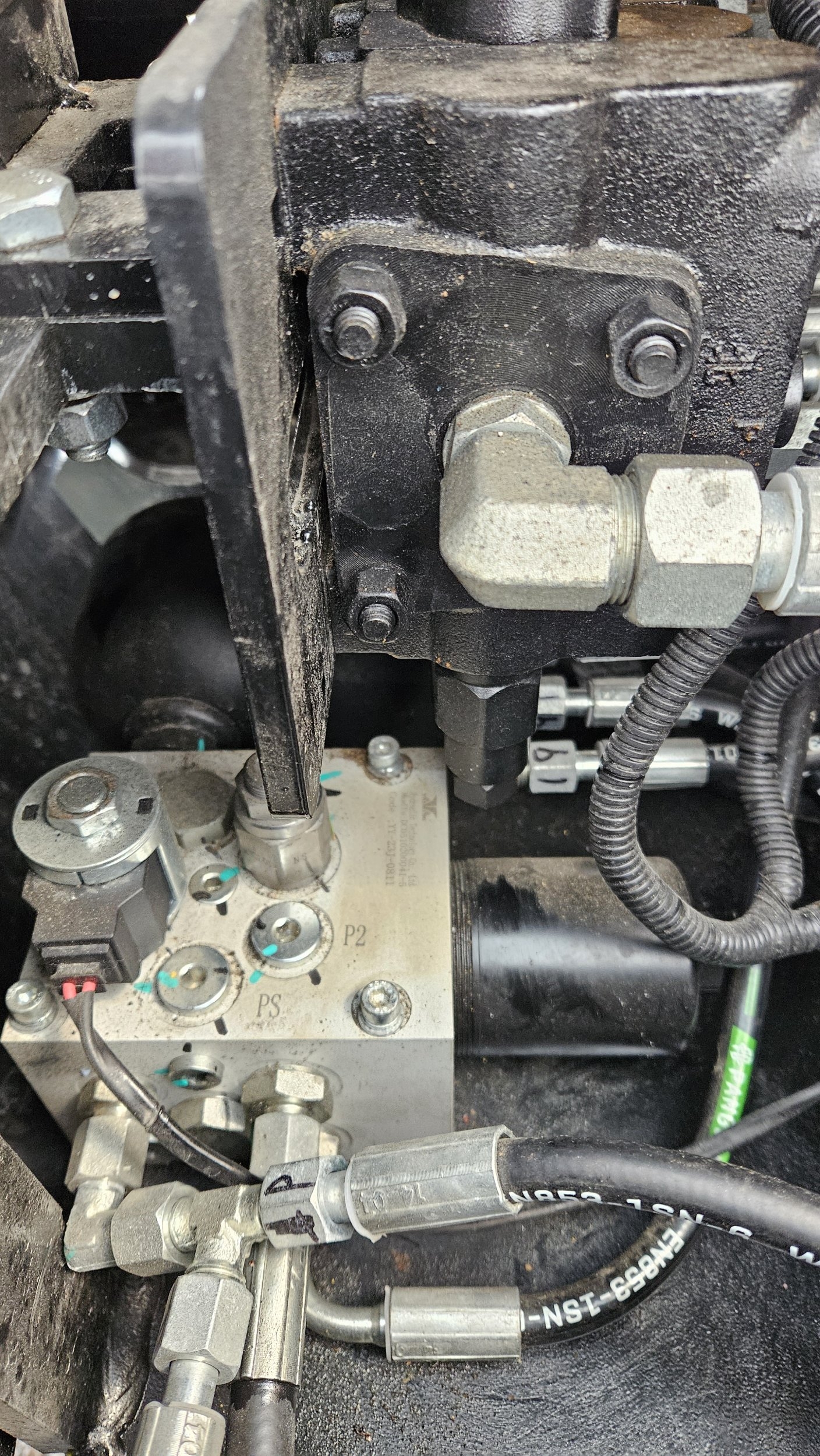

I opened up the Diggit EM15 and here are some more pix.
The main stack valve looks like others on these 1-ton-ish machines. It has 8 spools, with 4 of them actuated by servos. Wheel motors, blade, and AUX are direct-acting, with the boom, dipper, bkt and house pivot all handled by the arm-rest servo valve joysticks. AUX and blade are operated by foot pedals.
A hydraulic accumulator is used with the pilot circuit to maintain control in all conditions.
As for the sheet metal on the house, workmanship is disappointing. One of the side panels is hinged, but it can't be opened until another panel is removed. Panel removals are necessary to get at the battery. Overall internal accessibility is not bad, however. No need to remove ROPS or console, as with many other machines.

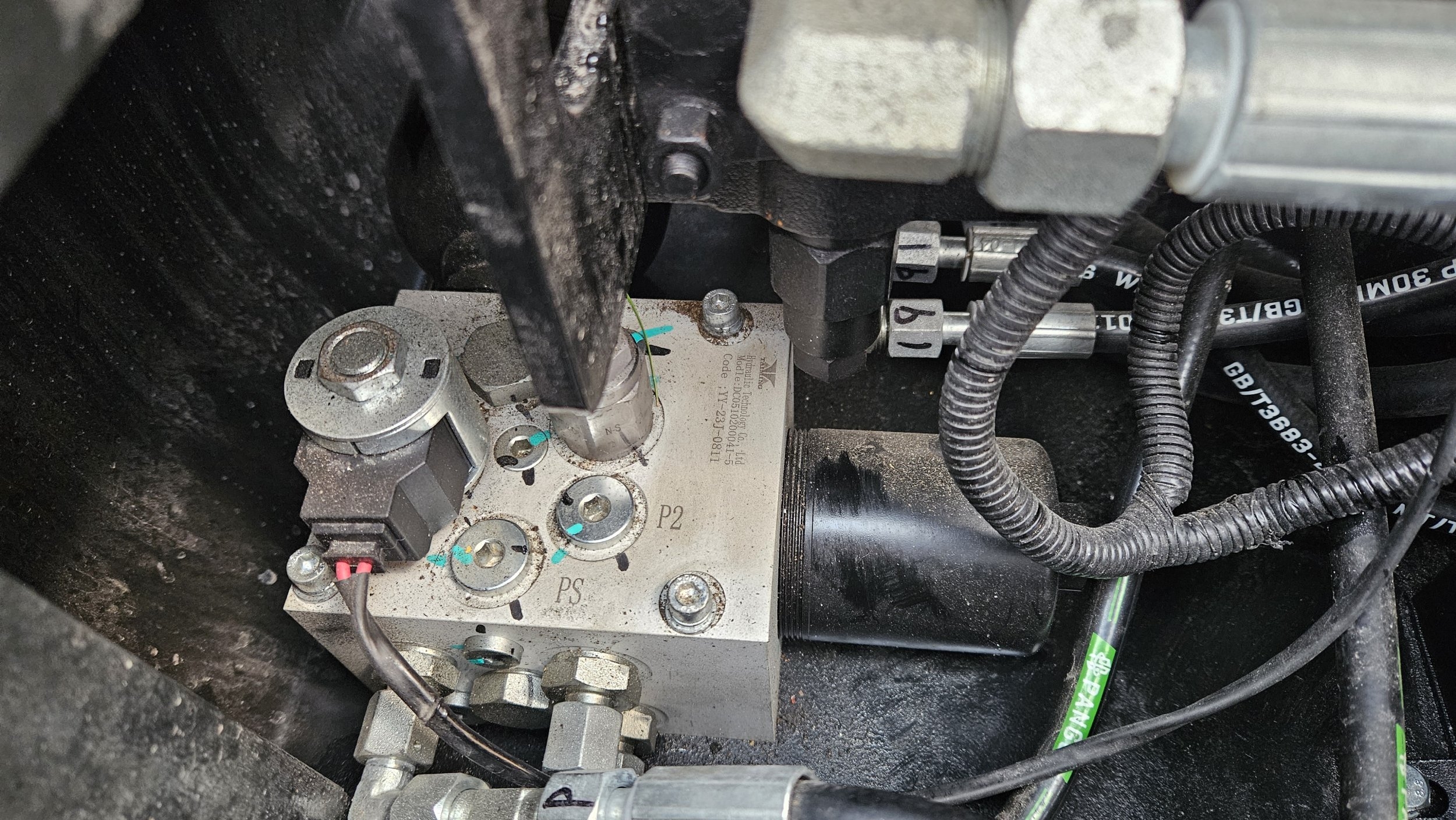

New user here.

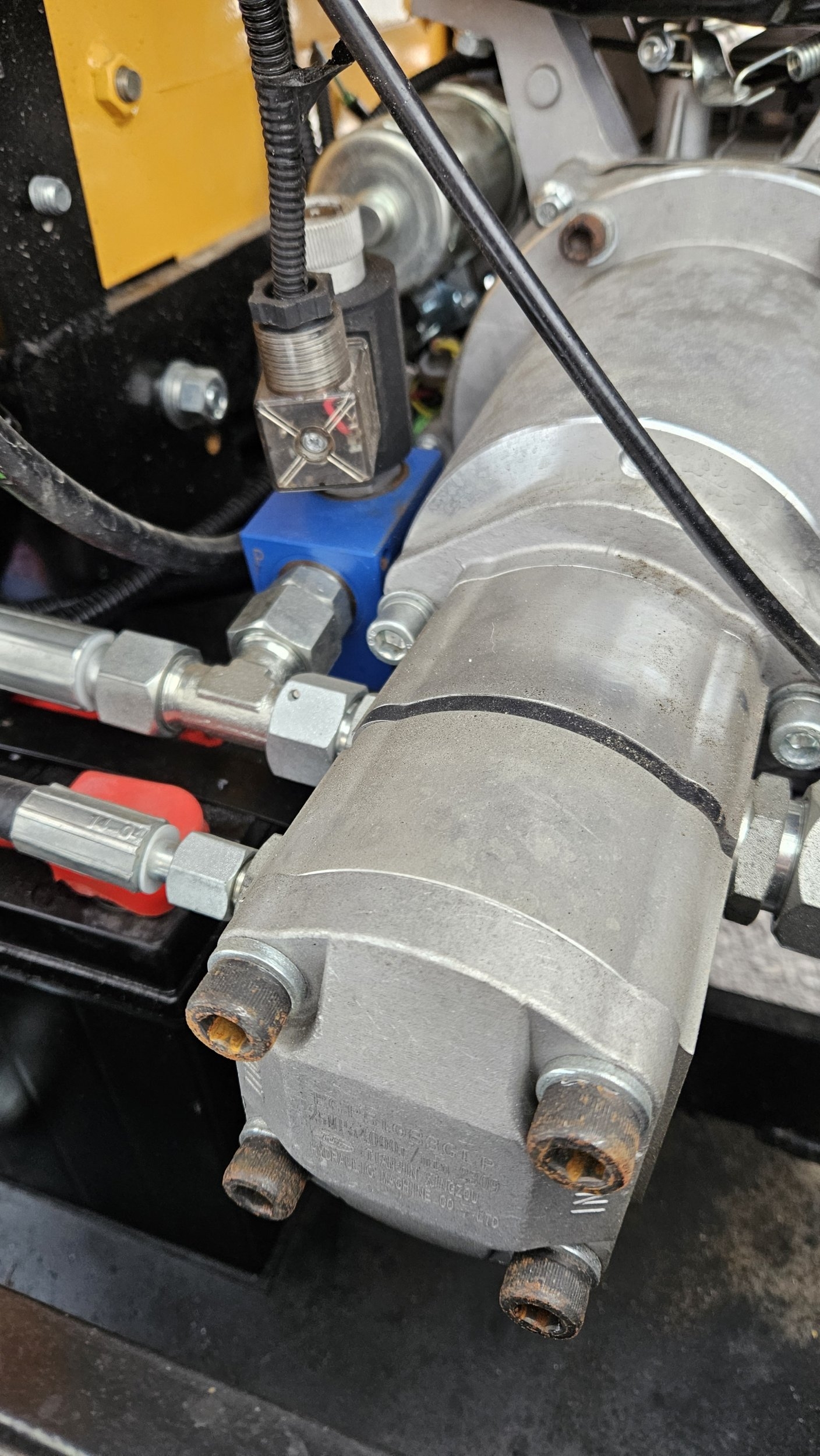

Just bought a Diggit EM15 from an auction in Alberta. All in, delivered in Montreal, for 8000CAD or 5900USD.
Took a few pictures of the internal of my unit to compare to DFKRUG's ones in post #540. It has dual pump with the outboard stage going to what seems to be a priority flow diverter to the joysticks with integral safety solenoid valve and accumulator. Does anyone know what is the black threaded cylinder on the right? Could it be a filter?
Besides the pump, you can see they also installed a blue safety solenoid valve to prevent operation of the tracks, blade and aux when the operator's console is up. That solenoid valve dumps the pump output straight back to the return line thus rendering the non-joystick spools non-functional.
The EM15 looks almost identical to the LeKing KV13Plus. Anyone know if LeKing is the actual OEM for the Diggit?
First project is to install a filter and oil cooler in the return line. Second is to build a manual thumb which I will convert to hydraulic comes next winter.
