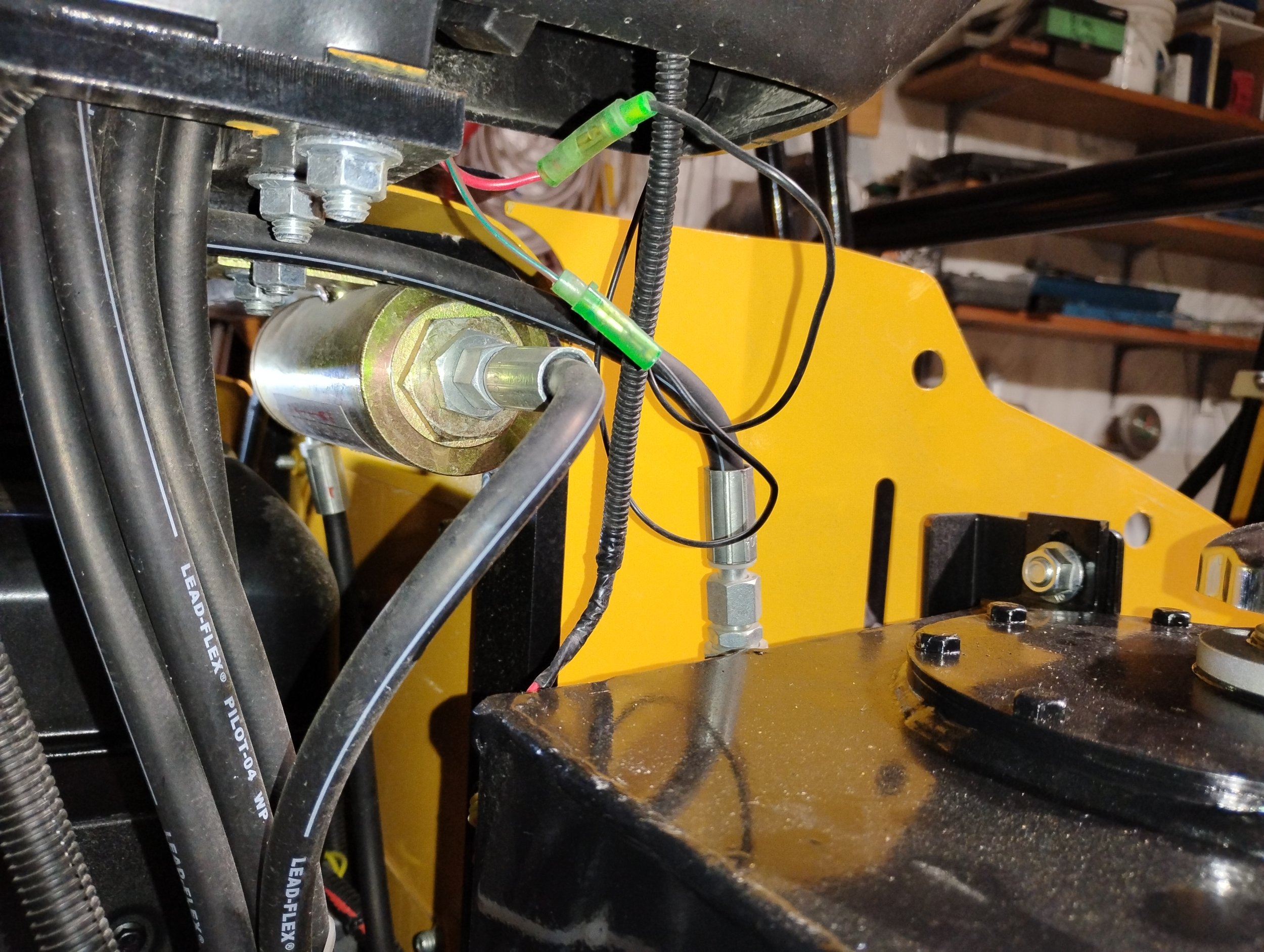

I changed the hydraulic fluid and did find a return line filter inside the reservoir but cant find a part number or a replacement. The fitting is 1in NPT fitting. Do you think this filter is adequate or should I try to add an external one.
There is an external filter for the pilot circuits but I don't know what a PN for that filer is either. It has a suction screen in the fluid reservoir as well.

The return filter you found is probably inadequate. You really need a 10-micron filter, which is widely available and pretty inexpensive. Zinga is often the maker of the spin-on cartridge, and you should get a spare or 2. I posted my installation above, in the early part of this long thread. Glad they have a return filter on the pilot circuit. I have seen some pix of that, but my friend's EM15 does not have one. Can you get a photo?

I think my pilot circuit filter is on the pressure side and I took a few pics but I have not opened that up yet.

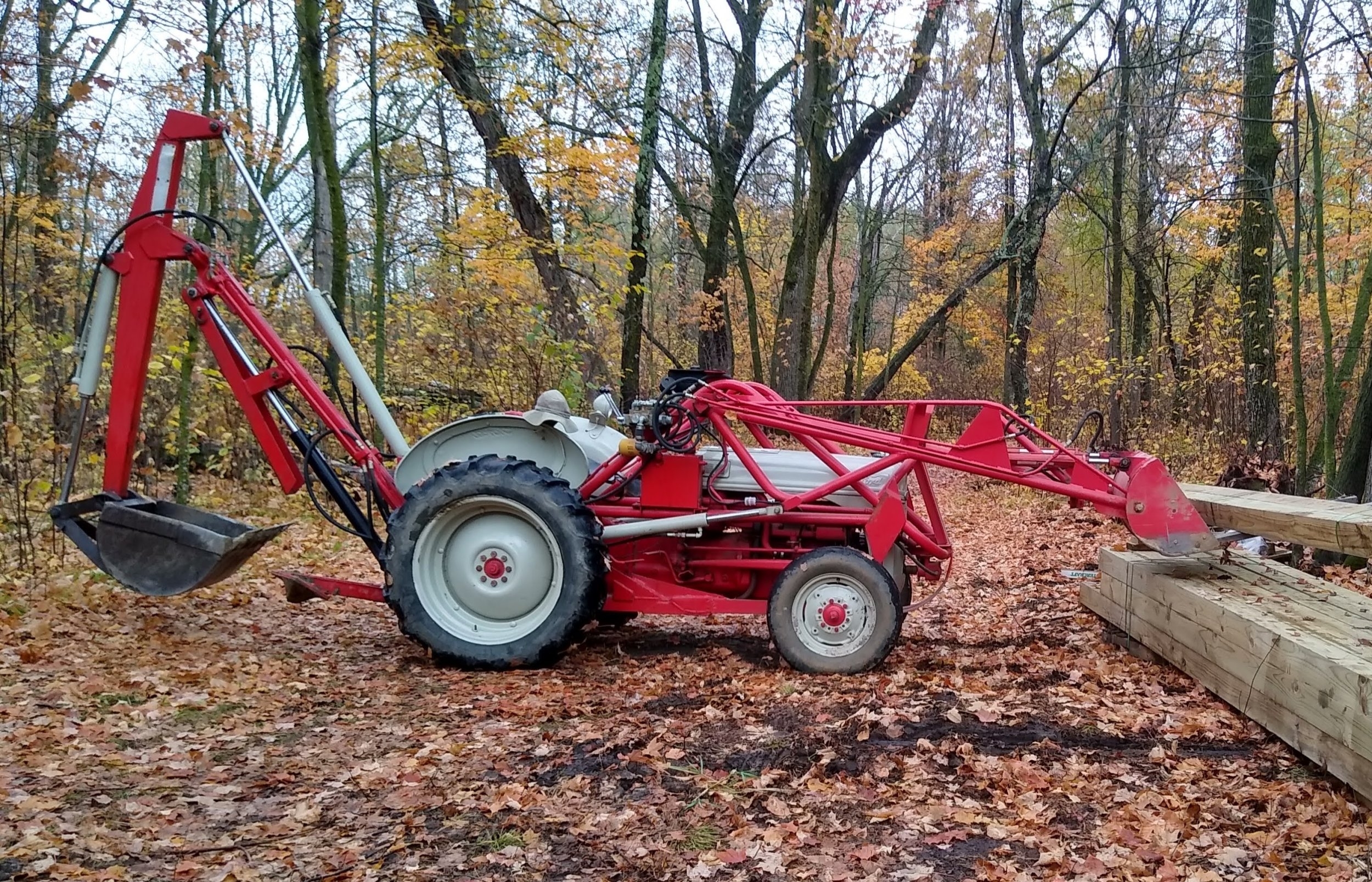

As a reference, I have had an old 1948 Ford 8n with a Sherman backhoe for over 30 years and that has a single stage, lower flow pump. It moves much slower but it's quite smooth and still has plenty of power. That think has dug A LOT of dirt over the years! I know much of that smoothness comes from the heavier weight, but it's still much smoother than my Miva.
Yeah, that filter is in the return part of the circuit, draining to tank. That is good, but what is the spec on it, and how do you find replacements for it? At least they addressed this critical need. I would change to a known and serviceable 10u filter setup like what I did above.
Thx for posting the filter pix. I will check again the local EM15 to see if it has this somewhat hidden filter.
