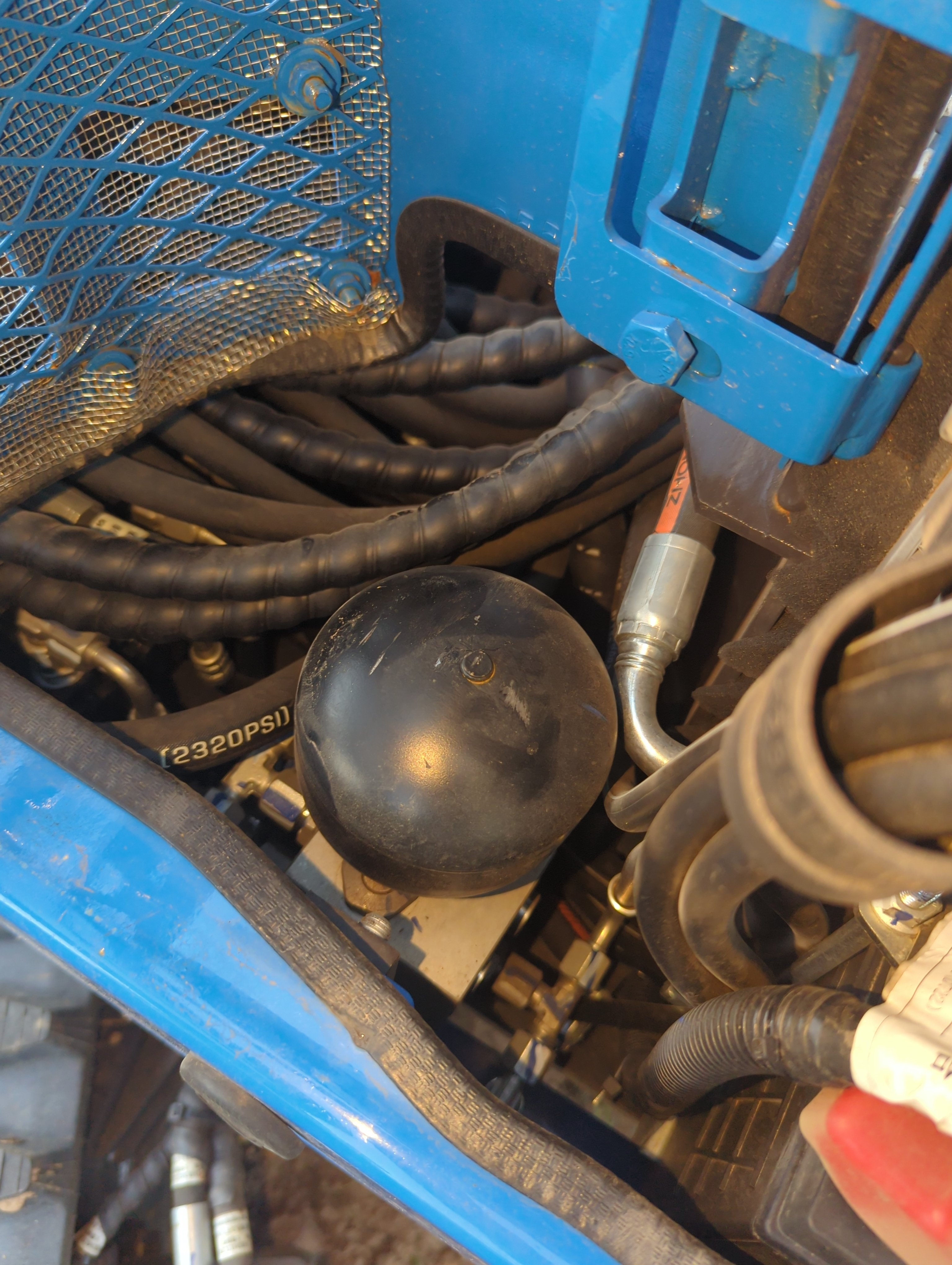

Yes it has a hydraulic cooler and since it came with spares I assume there is a suction and return filter in the tank. I have looked around inside and not seen any other place those filters could go. When I get the chance I think I will put in a better return line filter just for the ease of changing it. There is also an accumulator stuck in there.

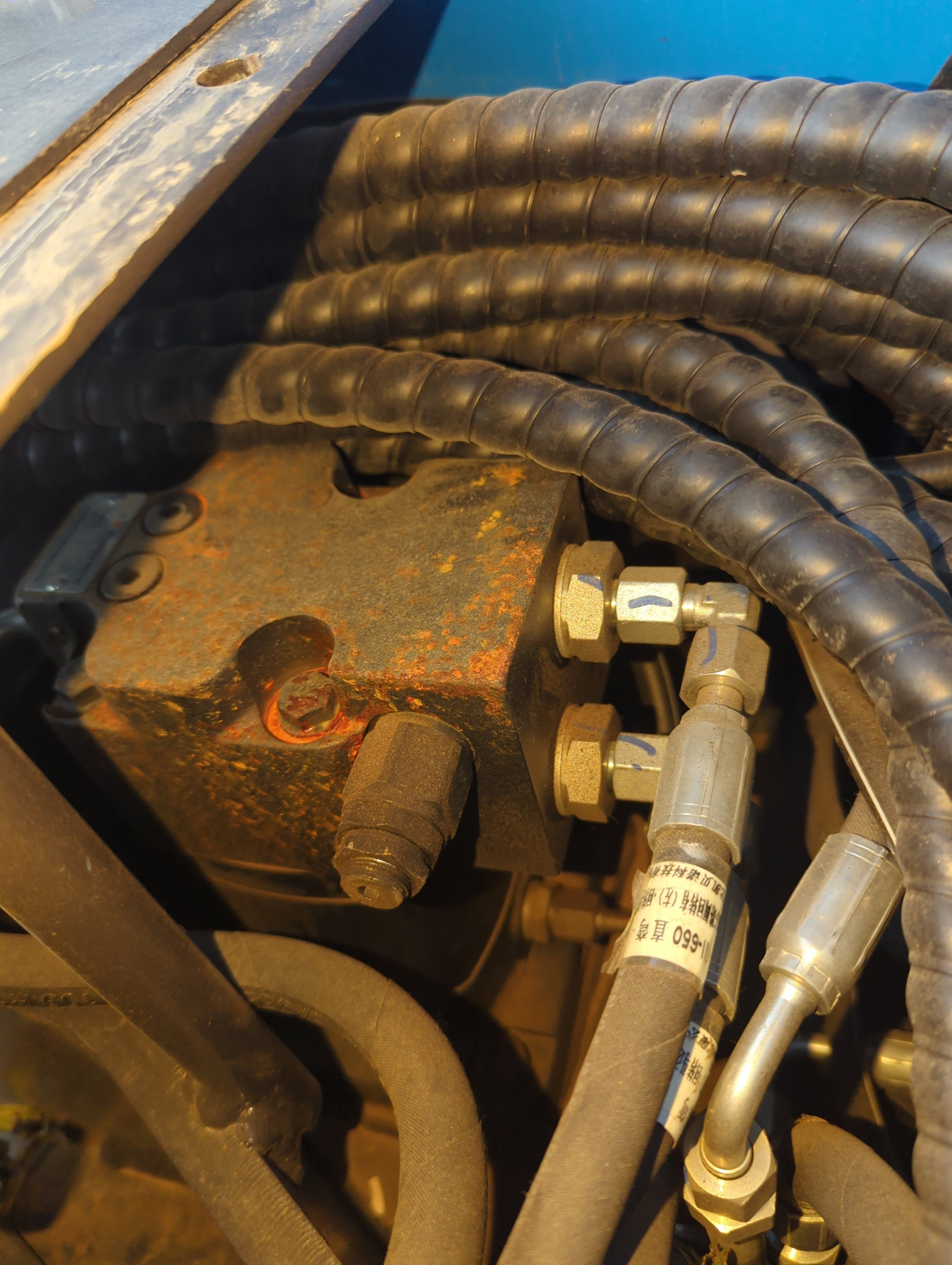

I have a quick question does this swing motor does it have a cushion valve on it? The smaller BS12 has a swing motor that looks like every other one I have seen pictures of and only has two lines on it. This one has two lines coming from the spool stack and one large line that looks like it goes to the end of the spool stack. At the bottom there looks to be a case drain but I did not trace that out and see where it goes.

What is in the last photo you posted? Is that the house rotation motor? I see two hoses that connect on the right, and what looks like an adjustable relief valve in the middle.
The RV is a good sign. Look on the other side for its twin. That would indicate double crossover RV, or cushion valve. You will just have to trace the hoses to confirm what you have.
As for case drains, the house motors on the smallest minis all seem to have the fitting on the top center, but only some have a hose connected there. Yours is a bigger machine with more serious motors.
Accumulator is for the pilot controls. You need to locate both RVs for the main and pilot valves. Nice to do all this before it is all dusty in there.

After looking closer there is a second RV. They appear to be built right in to the motor. There are two lines from the spool valve going in then one large line heading back to the end of the spool stack. The small line at the bottom of the motor turned out to lead to the grease zerk that is used to grease the gear.
Good news. You seem to have cushion valves on the house rotation motor.
Next, look for the 2 RVs for the main and pilot hydraulics. At least the main one, and maybe both, will be at the entry side of the main hyd valve stack. You could even have a 3rd pump.
The 2-4T Chinese minis often seem to spec their main stack valve RV at about 2900psi. Pilot RVs may only need 1000-1500psi, but I have not seen anything at all about that from any maker.

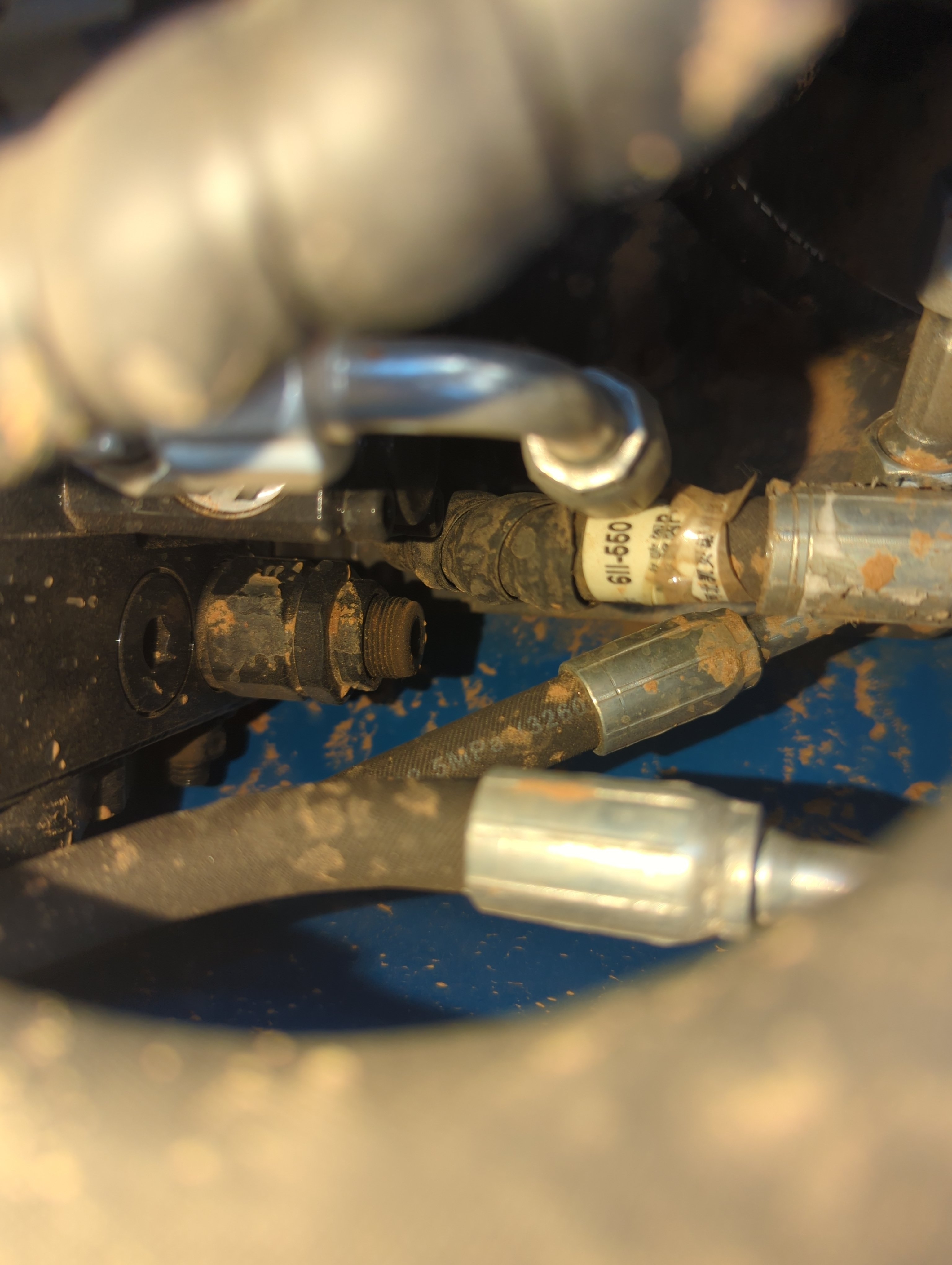

After looking around I have found one RV on the main valve stack. There appears to be a place for another one on the other end of the valve stack I think. On the pump there appears to be two adjustments and the hose leading out of that section goes to the pilot controls. Any idea why there would be two adjustments for the pilot controls?
This picture if of the RV on the valve stack.

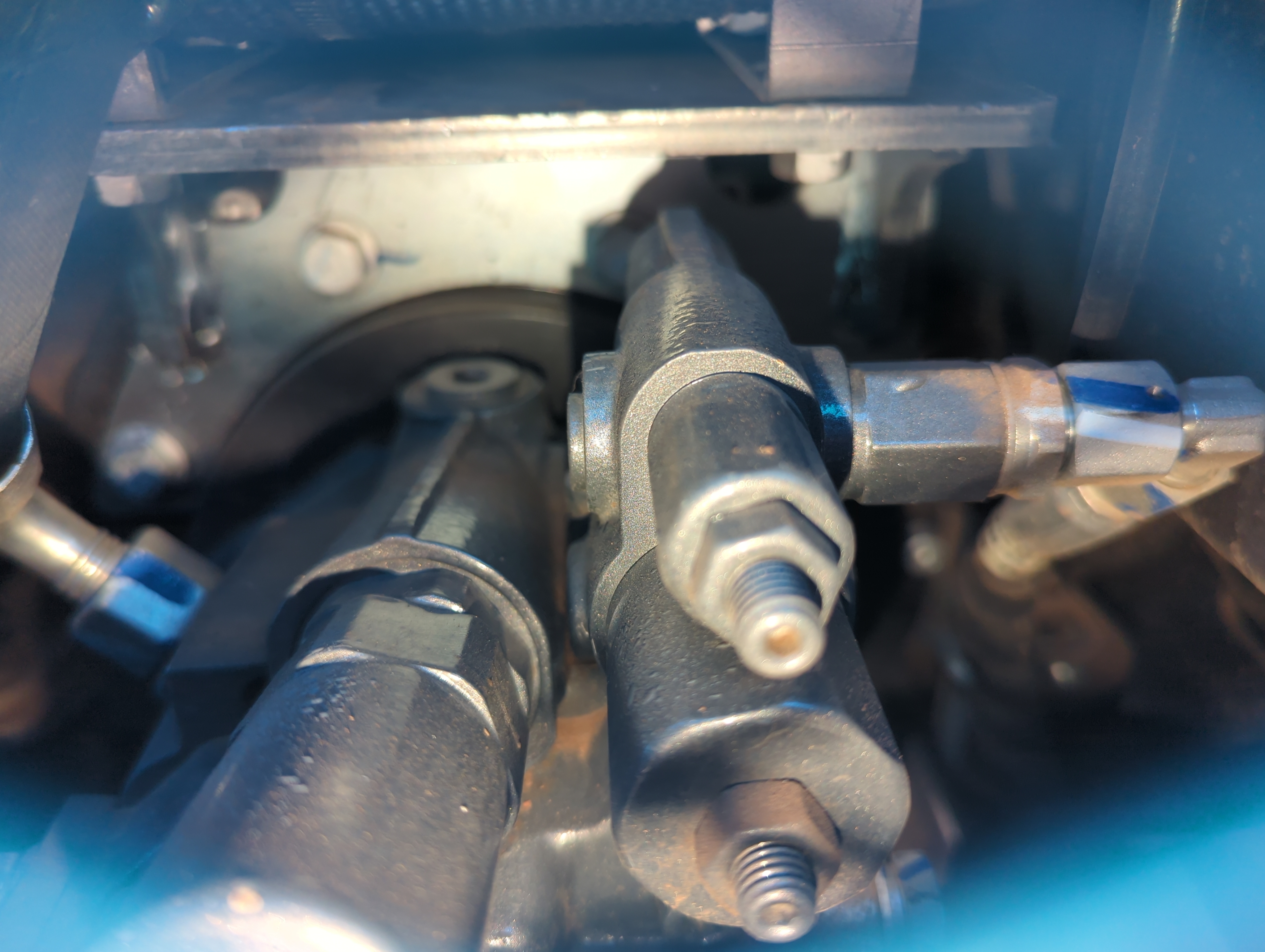

Here is a picture of the pump body. There is a large soft line that comes in to the pump from the bottom of the tank. Then there is another smaller line that comes in from mid tank that you can see on the left. I would guess that is a return line for the RV? Top right has two adjustments screws and the line is smaller and heads off to the pilot controls. Below that is the main output of the pump and heads off to the valve stack. Any ideas on why two adjustments on the pump? I am going to have to get a pressure gauge and some adapters so I see about checking everything out.

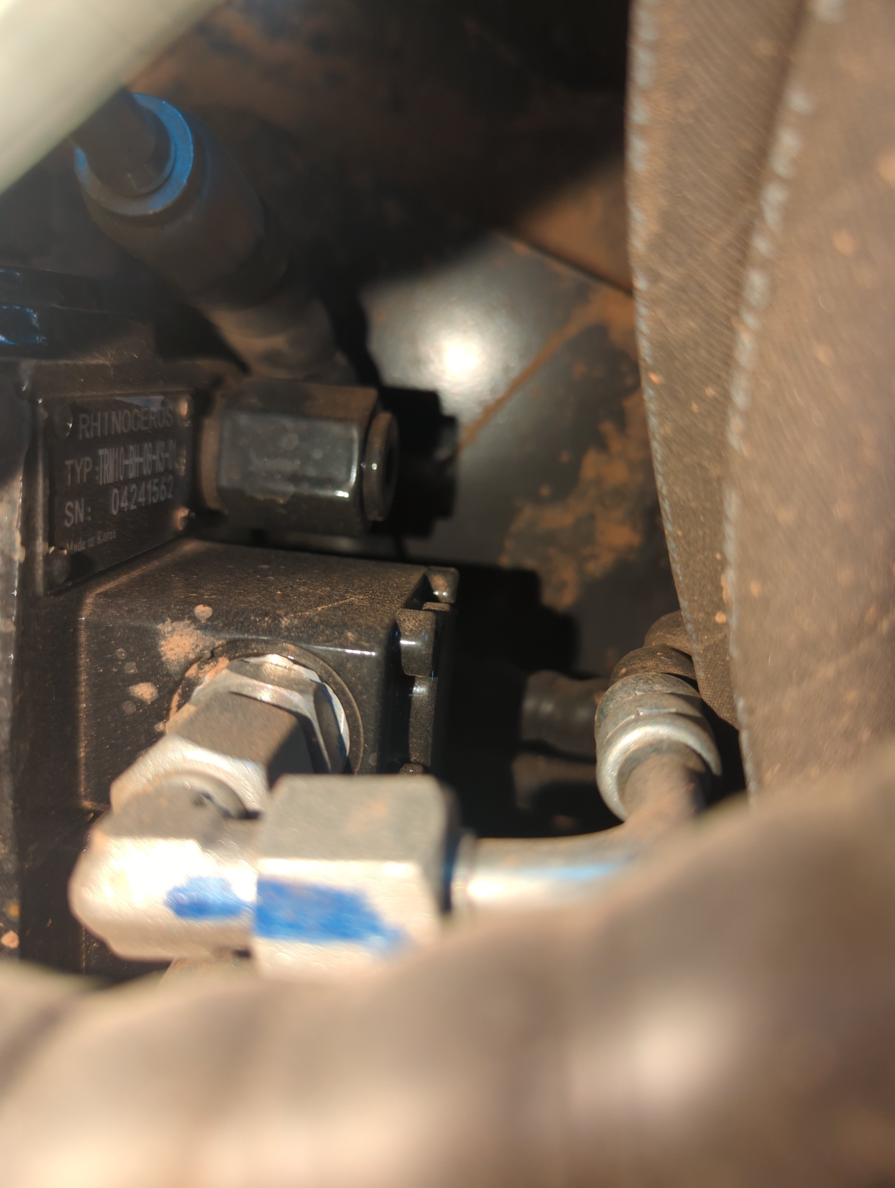

A lot going on there. You need to "reverse engineer" your hyd system.
I see a name plate on your second photo. It says, "Rhinoceros", which would indicate the Xiniu company, aka Rhinoceros, aka Shandong Landworld. That is where I got my XN08, and it seems to be one of the better makers. Yours might be an XN20. You may want to look at photos and compare.
Yeah I am just going to have to trace it out and lay out a schematic. This is really more of a preventative measure as nothing has broken yet but I would like to understand exactly how it is supposed to work so when something does break I can troubleshoot it.
