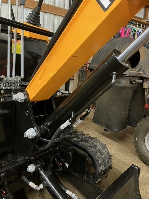

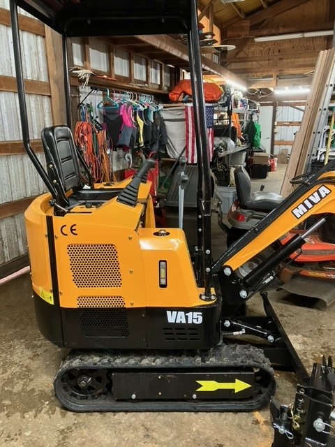

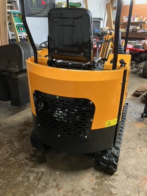

New to the forum, new to excavators, and just bought my first one.
Miva VA15
First off, Thanks for this Great thread. I have learned a ton. I have a long way to go, since I have no experience with excavators or hydraulics.
Got the excavator home and immediately changed the oil, took pictures of all the parts/equipment with ser. numbers, started installing rubber floor mats, and tried to figure out what I had.
I have several questions that I hope someone could help with:

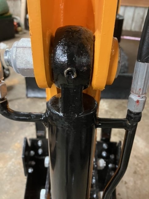

1. Installing a hydraulic thumb, I assume the red lines on the hydraulic lines should match up? Can I just attach the lines, or do I need to try and put fluid in them first? Do I need to bleed the air out some way when I turn the cylinder to protect the lines?
2. Any suggestions on how to extend the exhaust, there is nothing to attach it to. Should I just buy a new muffler?
3. Does anyone know what size zerk fittings I need to replace the painted ones with? Are there different sizes?
4. There doesn't appear to be a drain plug at the bottom of my hydraulic tank. Should I pull the line, syphon, suggestions? (I haven't removed the side cover yet, seems like you have to remove everything including the ROPS to get it off.)
Thanks in advance for your help.
   / Importing and modifying a new mini excavator from China
#1,460
No bleeding of lines required.
Best way to deal with muffler is to lengthen manifold and route it outside the house. I posted how I did it in Modify thread.
Re hyd tank, best to remove suction filter and clean it out.
