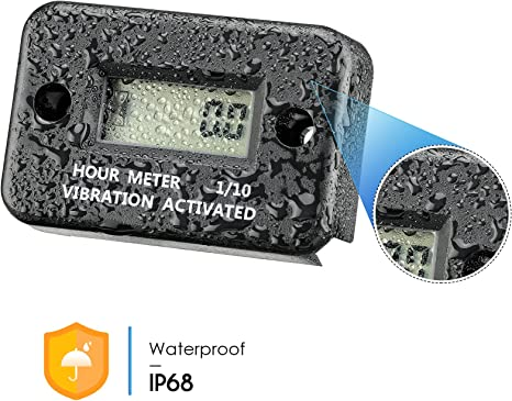

You will definitely have to Disect the Fuel Cap, The B&S EPA Cap, boils the Gas in the Tank.
Next, the Hour Meter may not last, I added 1 of these, with Tach from Amazon.
Grease Zerks replaced with Nipples 6mm
