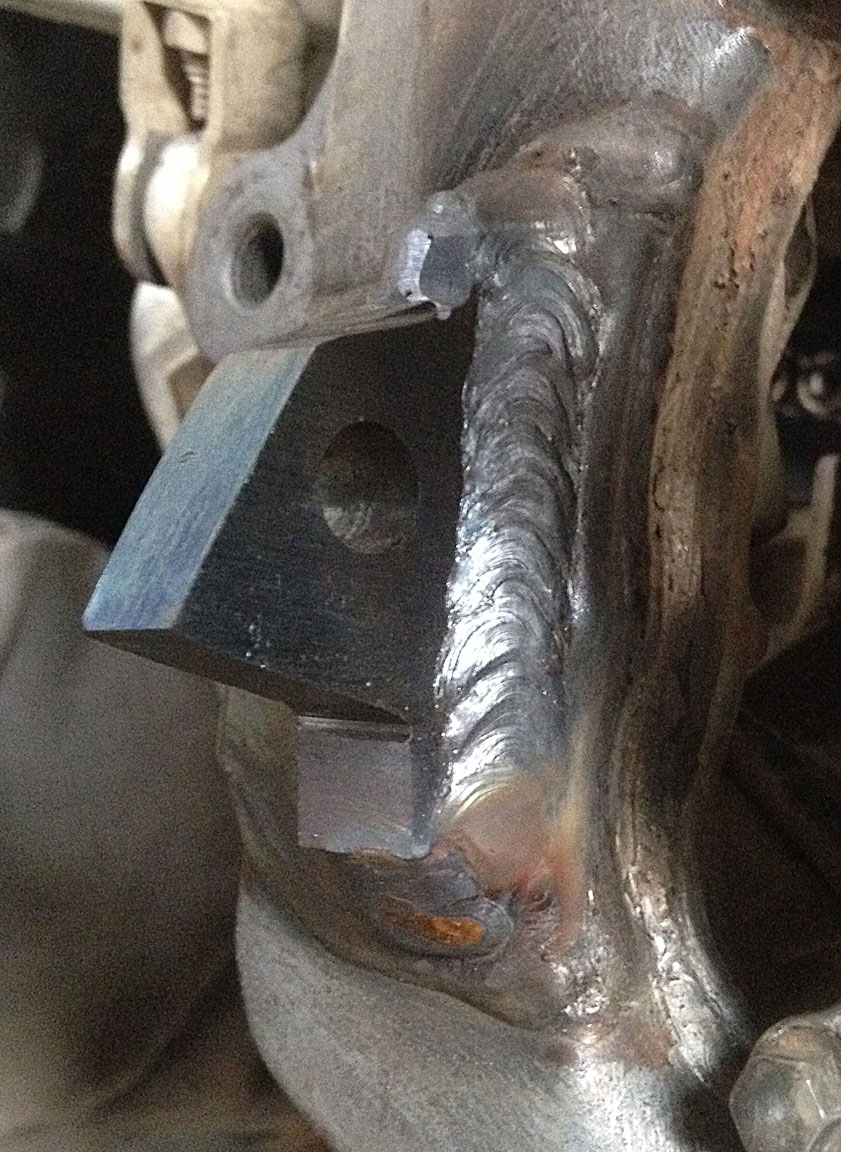

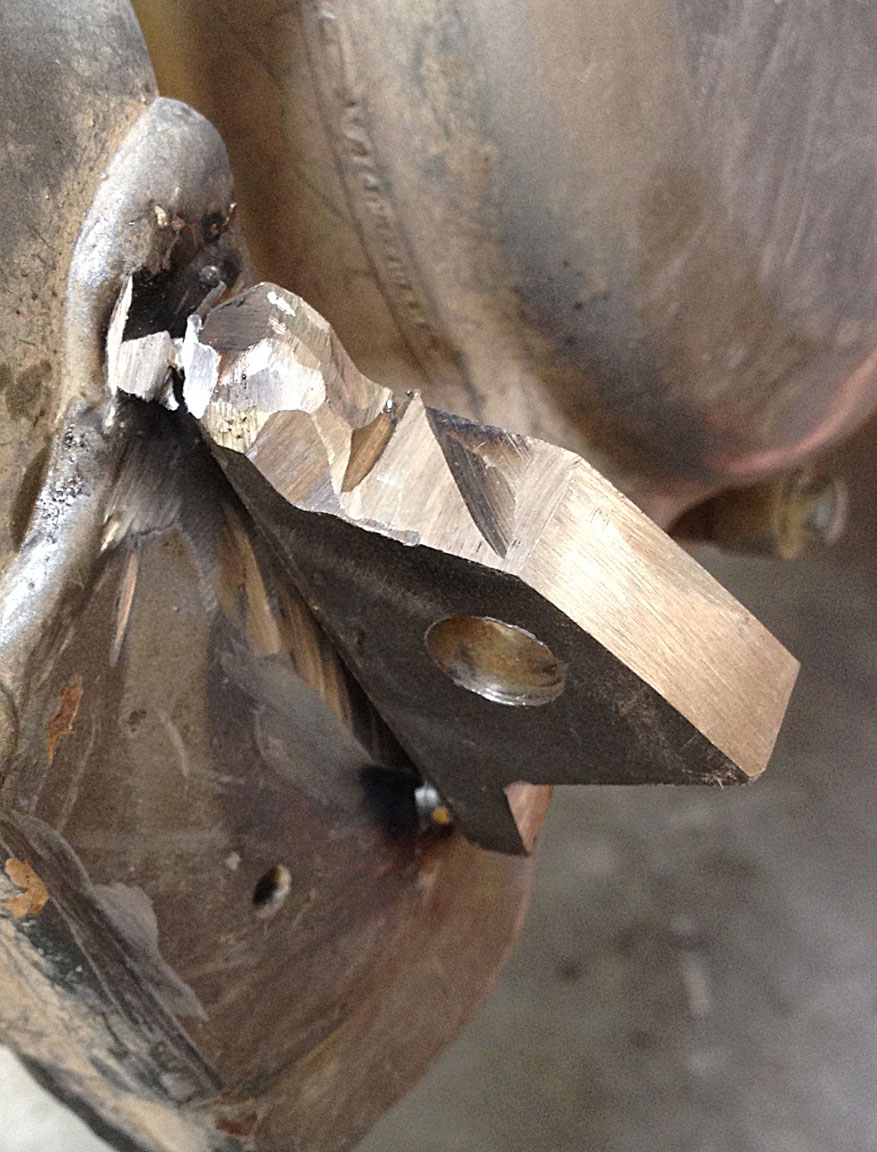

Since you asked, First thing I would do is stop trying to weld metal that is thicker than your machine is capable of. Your machine is dual voltage, use it for what it is meant to do.
Second, I would start listening to to what has already been said on a bunch of different threads. Stop belly aching everytime you post of a picture of your welds and somebody critizes them.. By all means, post more pics of your weld, ask questions, and stop the basted arguing when you have already been told a hundred times your welder isnt designed to weld 1/2 plate on 110v. Facts are facts, every manufacturer of 110v mig welding machines will tell you the machine isnt designed to weld over 3/16 and it will say so right on the welder in most cases. Its a fact, learn to deal with it.
This footpeg bracket (from earlier post) is 1/2" steel, welded with 120v. It worked OK because the bracket doesnt have a lot of mass. The owner was thrilled.
Sorry Mudd, your suggestion doesn't "fit" the program. :laughing: actually I was referring to welding techniques, not the philosophy part.

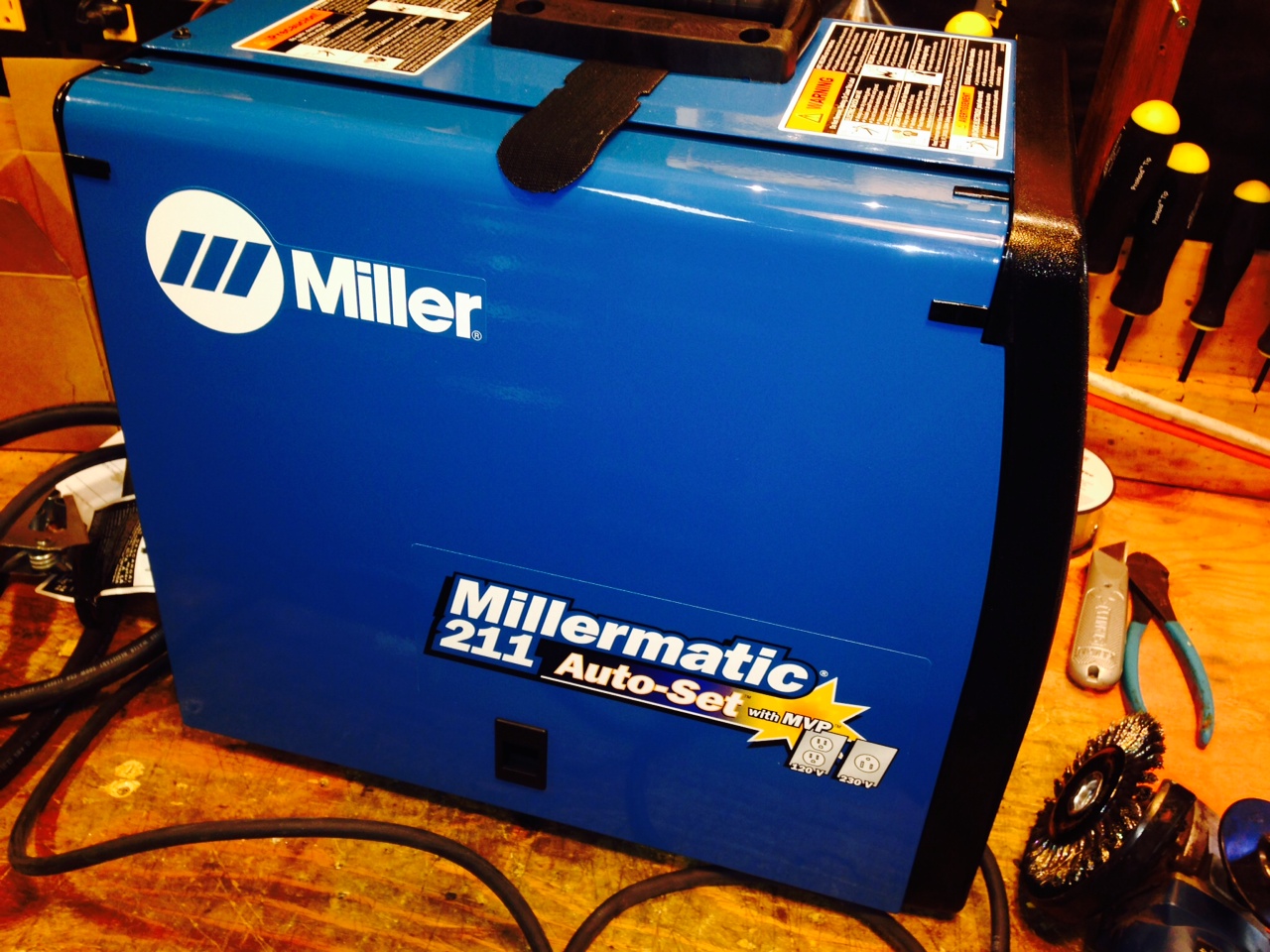

I don't have an axe to grind. I'm curious with Sodo doing everything on 110 volts and trying to justify it so much that he bought a dual voltage machine? I think that's a legitimate question. I do have a bit of a problem when someone/anyone posts a picture of a bad weld and instead of listening to what others have to say, tries to justify it and make excuses for it. We've all done some less than stellar work but if you can't take constructive criticism, you'll never improve. I've had other engineers say they are 3 types of loading, static, dynamic and cyclic loading. The basic understanding I was taught, over 30 years ago, was that static loading is something that just sits there, like a base plate on the bottom of a table leg. A dynamic load is something that could have changing loads but not necessarily cyclic. I would consider something like a spreader bar or a lifting hook a dynamic load and weld it as such. A lot of structural steel is static in use but welded with filler metal designed for dynamic loading. 6013/7014 for example aren't approved for welding structural steel. Even the saddles for large vessels that do just sit there are welded as if they were dynamic loads. For some things you really need to know exactly what to do and for other things all you need is a basic understanding. If a person erred on the side of caution and used 7018 on a project instead of 6013 because they weren't sure isn't likely anything to be concerned with. Welding thicker material than a welder is rated for is cause for concern.
/ Improving your welding? #228
I don't think I've ever heard a more legit question on TBN. :cool: Arc you've asked that several times, do you really want to know the answer and if I can explain it will it reduce the tension?
Actually its fits the program very well. To learn techniques, you look, listen and learn. As this thread has progressed, you have continued to refuse to listen to what other more knowledgeable people have had to say. You inject your thoughts and opinions as if they are fact without reguard to what other more seasoned professionals have had to say. I am only suggesting that if you really want to learn more, you first learn to listen to the pros on the subject. They have most likely already been thru the trail and error parts of leaning their craft and for the most part seem willing to pass along their experiences to those that are willing to listen. I think you want to pass along advice and experiences that you have learned over the years, but the problem is your advice is mostly bad, and inaccurate, and potentially dangerous. Not saying you have bad intentions, or trying to deliberately pass along bad advice, its just that you dont know any better. Advice such as the foot peg examples in your post. Did it work, was the customer happy, is there a reason why some countries are outlawing such repairs. The answer to all those questions is most likely yes. There is a reason some countries are outlawing such procedures, its unsafe. There is also a reason why the customer is happy, and its because they simply dont know any better or the risk they are taking. Did it work, yep, only until it fails.
