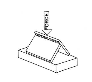

/ Improving your welding? #79
SA - When I go to beat some chips apart with a 5lb sledge what's a good number to stop at and give up?
10 blows, 20 blows? Or do you just beat it into submission?
/ Improving your welding? #80
I'd beat on it until it breaks. Try to keep the same force / swing each time. Remember this isn't a very scientific test! It's actually to see the penetration of the weld, not the strength of the weld. If you put it in a shop press where you can accurately measure the pressure it takes to break the weld you would get better results.
