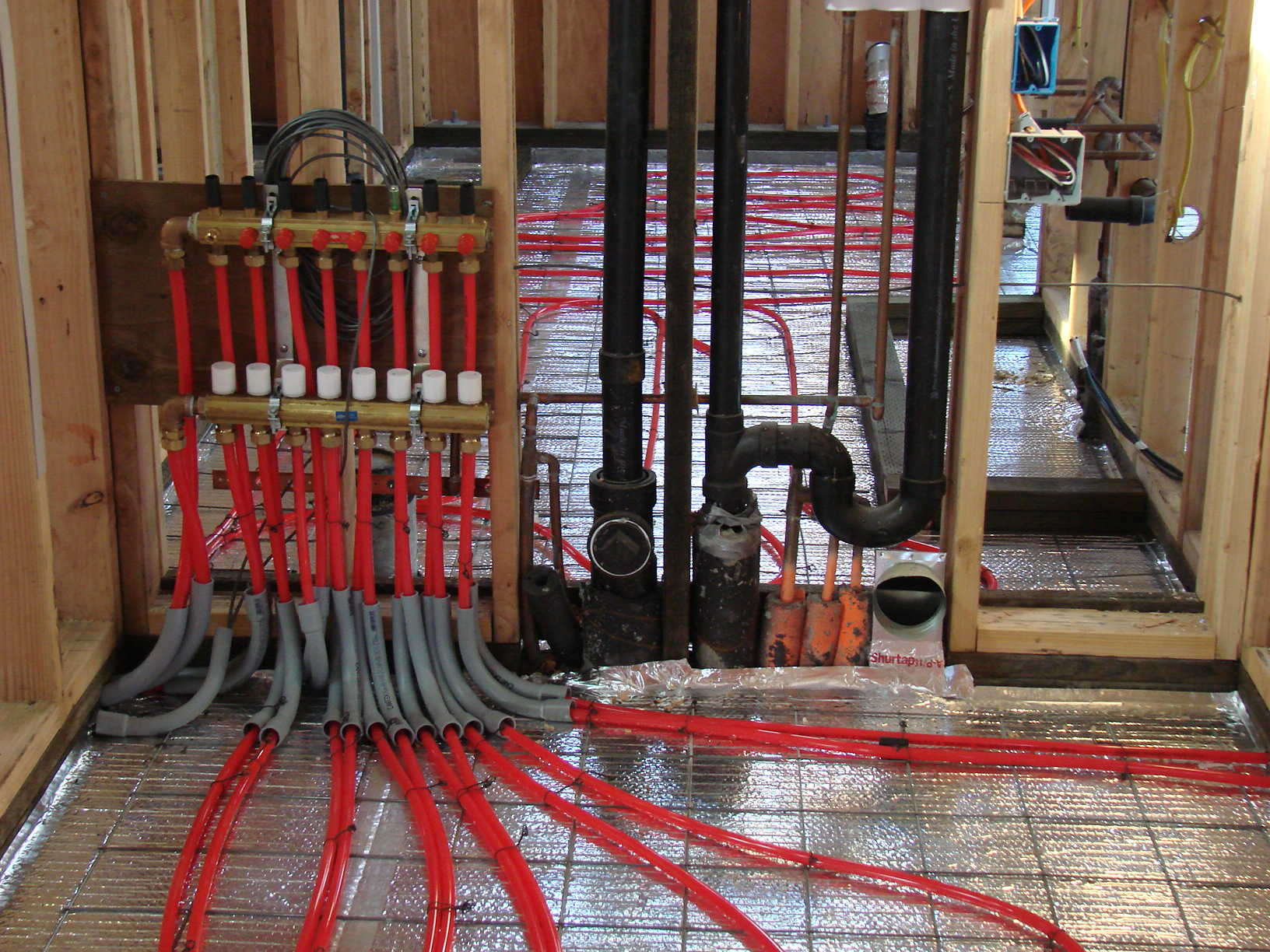

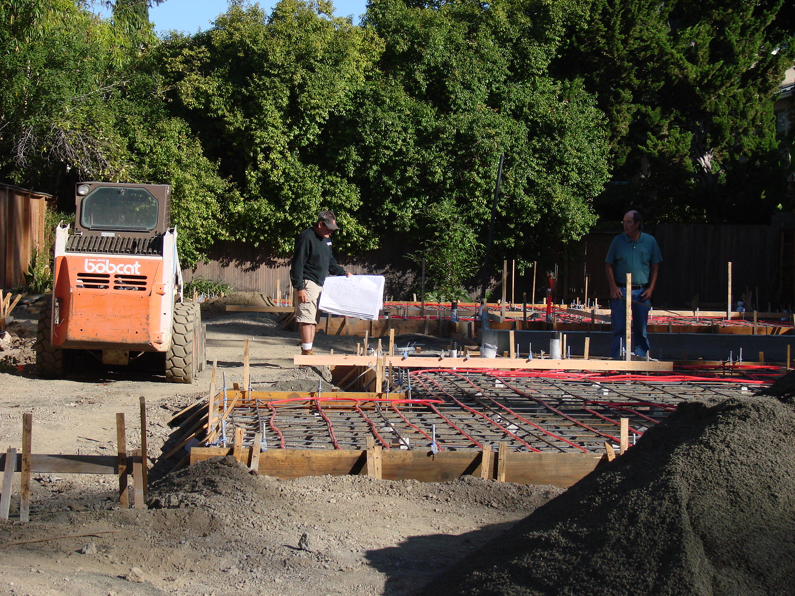

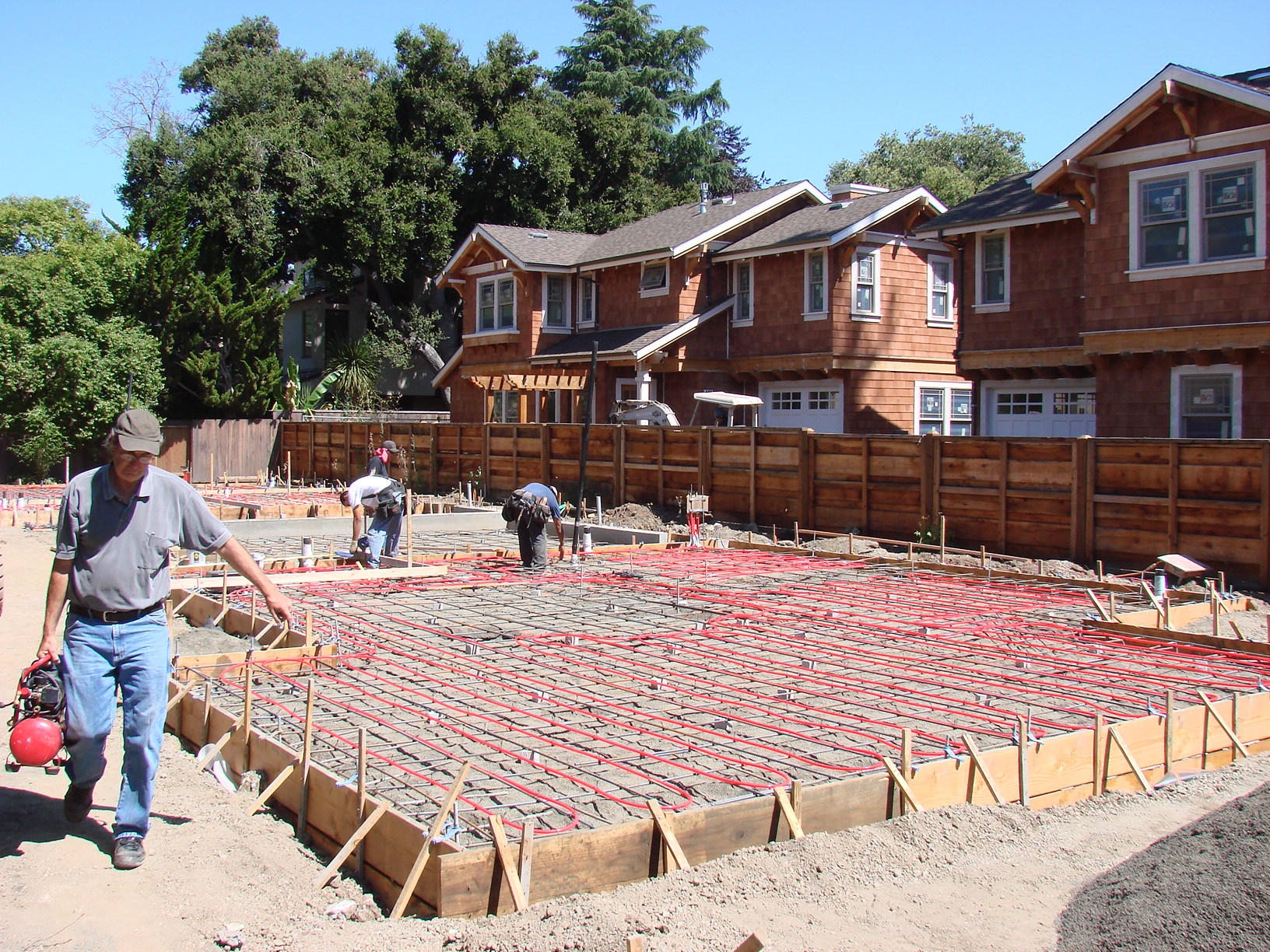

Yes, I do design and install them and have for 30 years.
If you put the tubing in a structural slab you certainly can tie it to the rebar as I mentioned in an earlier post. Easiest way is to use rebar ties and a tying tool. Decide in advance the tube spacing you want and run the bar on that schedule. Near doors run it closer with an extra bar or two. Generally, less bar is used without radiant heating if the bar will not be used to support the tubing. So if the plans call out #5 bar on 24 inch centers, you might go to #3 bar on 12 inch centers to accomodate the tubing and have similar strength and similar rebar cost.
Twelve inch spacing works well for general heating. But reduce it to six inches in bathrooms and near entry doors or shop doors.
The tubes don't need to be any closer that one foot from the exterior walls. They should not go under interior walls if you can help it, but instead go through doors to enter a room. Separate rooms should have separate loops so you can balance the flows to match the heat load in the various rooms. For instance, bathroom floors should be warmer than workout room floors. Kitchen floors run warmer than bedroom floors. This is done by regulating the various flows at the manifold. Separate thermostats control rooms with different purposes and different schedules. Such as the master bedroom and the dining room will have separate thermostats. But within each zone there can be many loops of tube if needed. For instance, a living room, dining room, entry and library could all be on the same t-stat located in the living room, but each room would have it's own loop of tube for balancing. This way you could lower the relative temp of the library while raising the relative temp of the entry, with an adjustment at the manifold, and all could run on the same t-stat.
If you know the rebar spacing, take some photos or just trace the temperature, you can find the lines easily later for drilling.

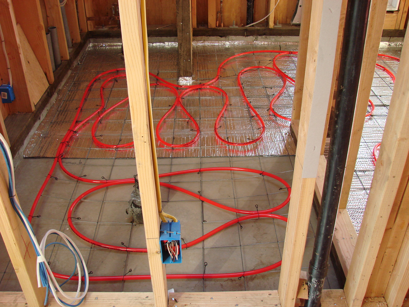

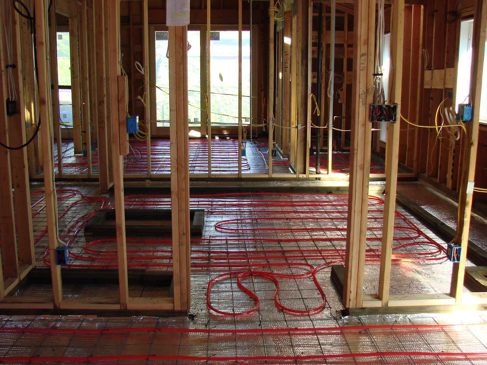

I'll include a few pictures. These show the manifold, the bathroom strategy for getting a lot of tube in with large radius bends and a general view of the layout. This happens to be a house done recently over an existing slab and using mesh to tie to. It has insulation, but I generally don't use it. In this case the general contractor wanted it.

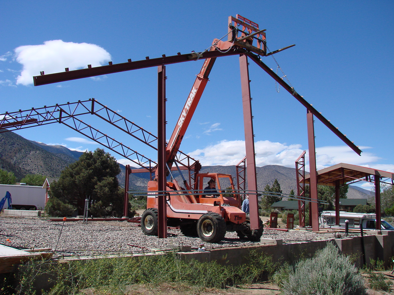

Interesting post Raspy. I have questions about the photos. It looks like you have the walls in place before you pour the cement? Like they are on top of 2x4's and those will be the level point for the pour. Is that correct and doesn't this make it more work for the cement guys? If that what is happening?

In this case, and it is done in a number of different ways, we already had a structural slab in the new house. Before the walls went up they put down pressure treated 2X4 plates to build on. Then the regular plates and the wall framing. We poured only 2 inches thick. The pour was Gypsum concrete. Done in ths way you just proceed as usual with the building and the lower plate disappears in the pour. Sometimes we just put the first pressure treated plate, then pour concrete and screed to the top of that plate, and then build from there. Gypsum requires a different strategy than concrete, but works well in interior spaces. It also gives a chance to cover conduits, low volt wires or water lines if needed, during the process.
I also pour 1 1/2 inches of concrete in this way over old slabs where we want to install a new radiant system in an older home. And on the second floor with conventional wood subfloors where we want to add radiant there.
The best way is probably to put the tubing in the structural slab and avoid the topping slab. These structural slabs are a minimum of 4" thick and I prefer 5 or 6 inches. Some have been as much as 24 inches. 12 is not uncommon. Mine will be between 6 and 8 inches in my new place.

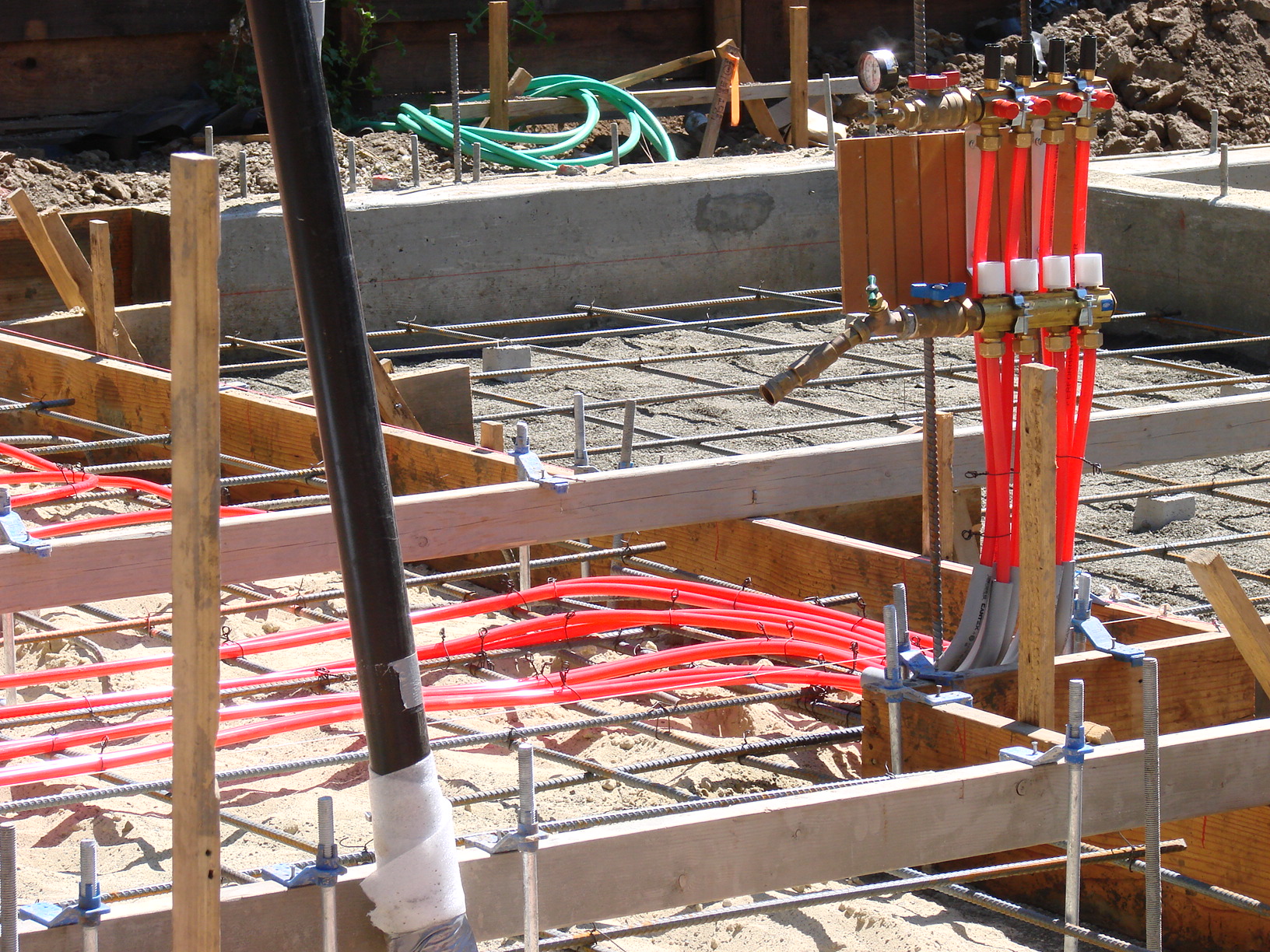

Here are a couple more pix of tubing going into a structural slab. This one has bar on 18" center and tubing on 12" center. I much prefer to have the tubing on the same schedule as the bar. You can also see the manifold, the ties and the conduit 90s.
You mentioned this several times .... without saying why ..... :confused:
Is it because you would prefer to run the tubing parallel to, and tied to the rebar - as opposed to just supporting the tube by crossing the 'bar perpendicularly ?
Less chance of damage by the concrete crew that way ?

The main reason is to help prevent damage from he crew. The pix I posted, with the outside layout, have the bar at 18" and the tubing at 12". The guys will be stepping on and stretching the unsupported tubing.
When the tube spacing gets down to about 9" the guys can't avoid stepping on it because their shoes are longer than the tube spacing.
I've had very little trouble with tube damage during pours. It's important to lay it out carefully to avoid sharp edges, tying it to unsupported bar that might move and stress the tube, kinking it, tying return bends to avoid a snag pulling it up, etc. I use the rebar ties with the loops on the ends instead of the bailing wire method to reduce sharp points. This is part of the reason to use conduit 90s where it exits the slab.
