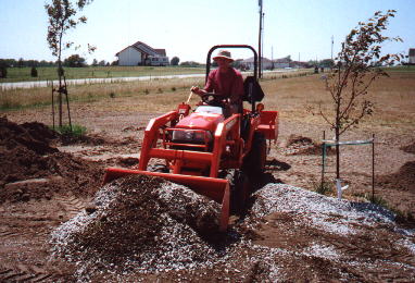

For a comparison see attachment and also attachment of last post. This one is the BX, see that both have a nice bucket full.

Gentlemen,
Thanks for all the info, insights, opinions, and pics.
I'm gonna broaden my horizons a bit and take a look at bigger rigs, maybe a few different paint colors, etc.
Then, I'll sort through it all again and see if the answer comes up BX, B or some other color (unfortunately, the other colors, except for green, do not have nearly the depth of discussion I find here!)
I'll be back with more questions soon!
