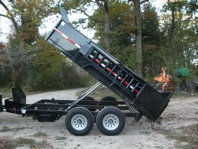

I am dissatisfied with the angle on my dump trailer, another 15 degrees and everything would come out when I dump all the time. I have found a set of longer cylinders and have the room to install them if I modify the undercarriage. Anyone do this?

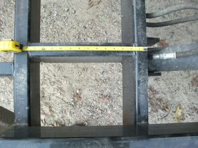

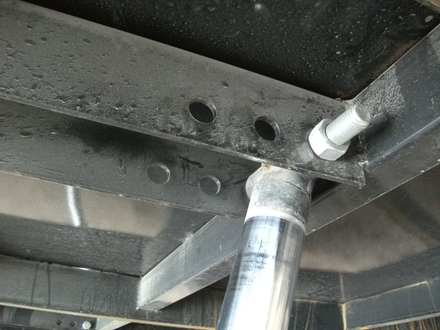

Here are some more pics that show the variables I have to work with without making it a major headache to accomplish. 1st being the inadequate dump angle (for me), 2nd being the amount I could move the larger cylinder forward and 3rd the options I have for moving the contact point on the the bed forward for increased lift capacity given the replacement cylinder has equal or greater specs. And yes my battery was low and I have it on charge!:D

This is one type , you have then the added lift height of your linkage to raise the draw bar which would help a lot .
I see what you mean , the tipping angle is way to shallow . It's as if those multi drilled plates need to be turned around and put on the other side of the cross member to give more lift height .

Without knowing all the measurments of the pivots in relation to the cylinder, the cylinder size extended and retracted, and the bore of the cyls and pressure, it is hard to say exactally how much force you are generating. But it is not hard to measure and figure. I had to go through it all with my dump truck build I did about a year ago. With two 2.5" x 30" cylinders I was able to get a dump force of ~ 19000lbs. Those cylinders look about the same size with similar geometry. That trailer should easially be able to dump 15k if you are generating 2500+psi. In which case I dont think moving the cylinders rearward would hurt. But some of those 12v pump units only produce 1600psi, which may be another obstacle.
Getting longer cylinders shouldn't be too difficult if you are ok at fab work. As to the hyd. capacity, you have two options. 1. You could get/make a bigger resivoir. Or 2. If possible due to your dump/valve combo, you could use the double acting cylinders. This way, you only have to make up fliud for the diameter of to rod for the given length you extend the cylinder, instead of the whole volume of the cylinder diameter.
Here is a link to my dump bed. http://www.tractorbynet.com/forums/projects/158521-turning-1985-dodge-into-real.html
Check out post 9 to see some of the masurments involveed. If you could post some of those measurments, myself or someone else can help you figure your exact dump angle and dump force. And more important, we can figure how much more angle you can get out of a 2" longer cylinder, or what the effects of moving the cylinder will have on your force, etc.

All valid points Dave, I don't anticipate any problems from the debris pile. I would like to have as much angle as I could feasibly get. Real dump trucks have a high angle. I also will go over the floor as I have noticed there are protrusions that the shovel catches on from welding that were not ground. I measured the angle at full dump and it is only 36-37 degrees. My goal would be at least 50 degrees, if not more. My previous dump trailer had a 45 degree angle and I had way less problems but it was too small for my present needs. I appreciate everyone's input and will check in with pics if/when I get to this project.
