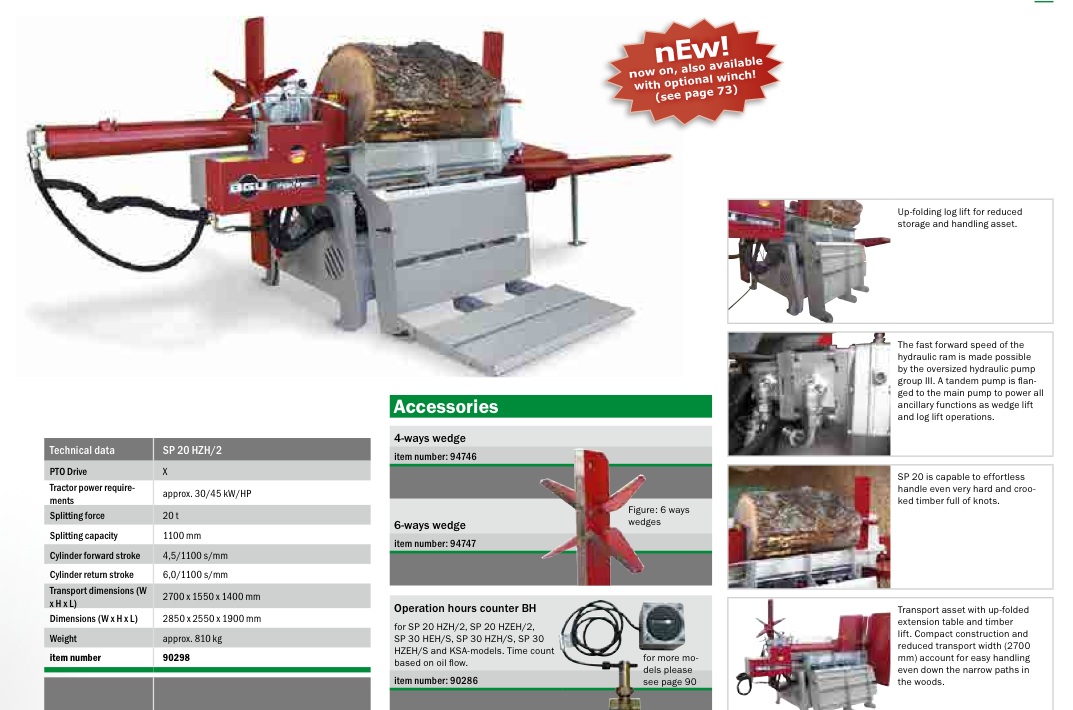

Holy crap ... here's another one ... that weighs 906 kg (with no wheels) and there's even a heavier one (978 kg):
Product Detail: BGU Maschinen
Nice looking kit ...
   / Increasing lift capacity 3pt hitch of Kubota B3200 #22
This may be it. 20T and 810 kg.
Bruce
   / Increasing lift capacity 3pt hitch of Kubota B3200 #23
those really arent what I would call a splitter.
   / Increasing lift capacity 3pt hitch of Kubota B3200 #24
They aren't made for a 3pt surely!!!! If they are it would take a big tractor to move it.

Good evening everybody (or morning in the US),
Thanks for your feedback on my question. Bruce, that's indeed the one I bought. I wil get that splitter within a few weeks.
I hoped my B3200 could handle that splitter but if not, I have to look for a bigger tractor. Maybe an oldie.
If the splitter fits on 3PTH of the B3200, I will try to increase the pressure by shimming the relief valve.
