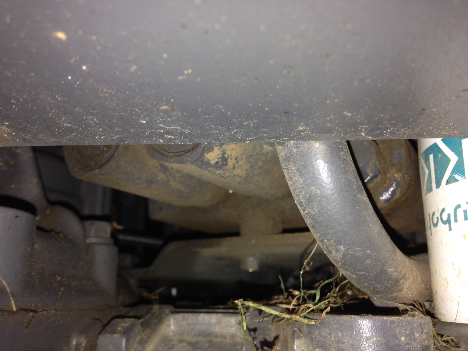

Hello,
Thanks for your prompt replies. My problem however is that only can find one relief valve and that's the one below on the right side. See picture (the bolt closest to the white filter, half behind the tube). Does anybody know where I can find the second relief valve on my B3200??
   / Increasing lift capacity 3pt hitch of Kubota B3200 #37
If you don't have a loader or remote valves, you only have one on the 3pt area.
Your question has been answered in several post.

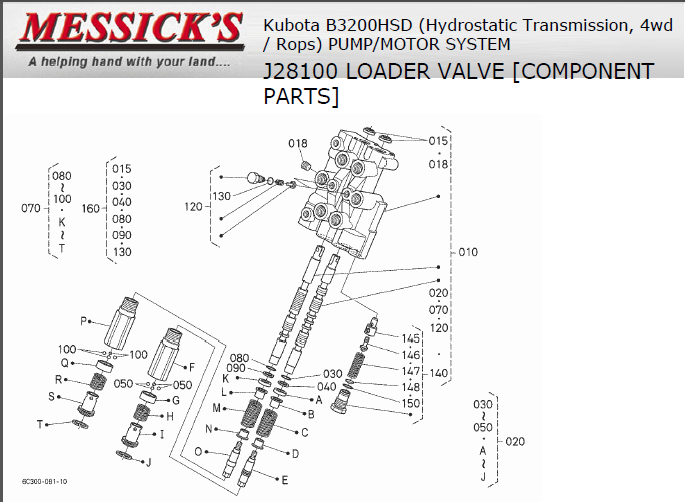

I have also a FEL but maybe the 3PT and the FEL work on the same relief valve?
   / Increasing lift capacity 3pt hitch of Kubota B3200 #39
Give us the loader model number. All the numbers.
Your loader is a LA504 and it has a relief valve.
The flow goes through the loader first and then the 3pt.
So you have to bump up the loader relief and the 3pt if you want more lift, at your risk.
Do you really have a B3209, or should it be a B3200
#40
I have a B3200 and a LA504.
The questions stays where do I find the second relief valve
