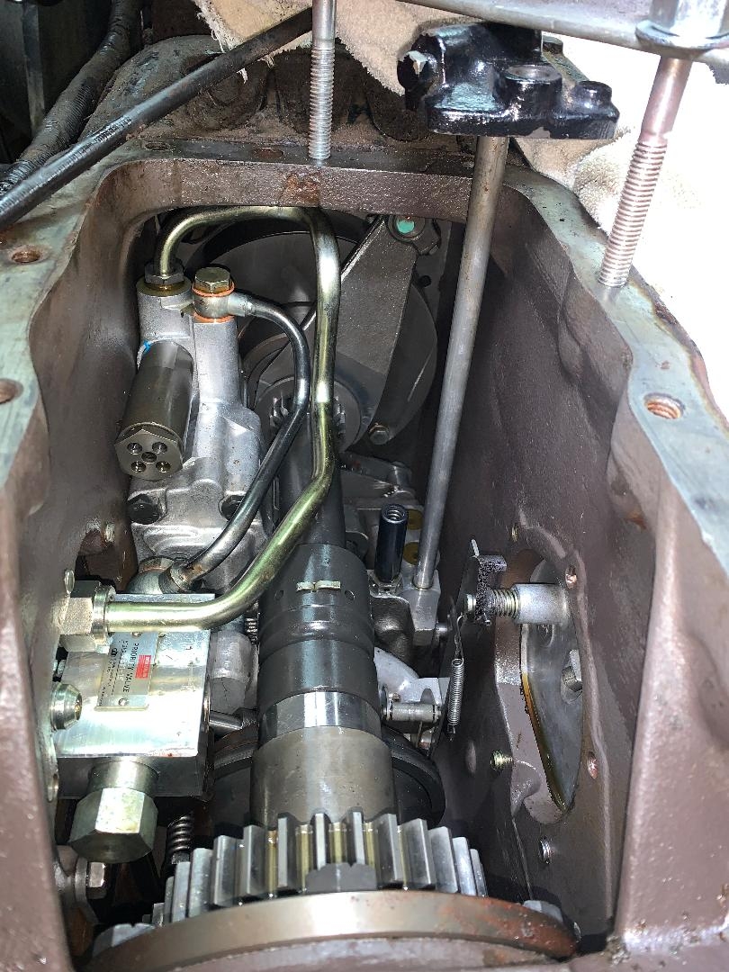

I just put a brand new screen on it and also put new fluid. It's only got maybe 1 hour run time, on it while I was testing it.
/ Independent PTO problems #22
is it a aftermarket screen ? I have been working on masseys for forty years both times it happened it was on the suction side is oil permatrsns compatible
#23
It is a Massey Ferguson screen and the fluid is compatible with Permatran and Permatran III.
/ Independent PTO problems #24
Since I know of nothing else that pulls the lever when it's running and Pto uses suction from three point pump why not pull it brake clean the hell out of it and see what happens
