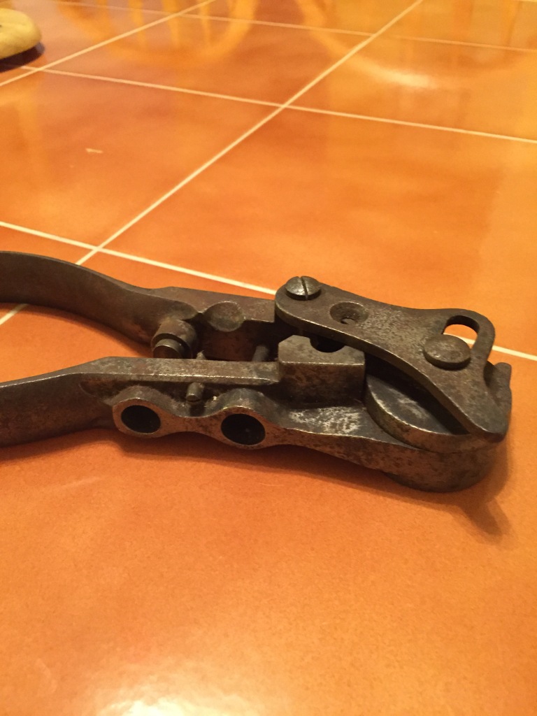

Here is a casting tool that came with the tools from Grandpa. The mold part is easy to understand but there are a lot of other holes too. Anyone ever seen something like this and know what all the openings and tools do?

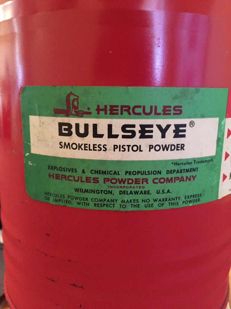

Some Bullseye powder

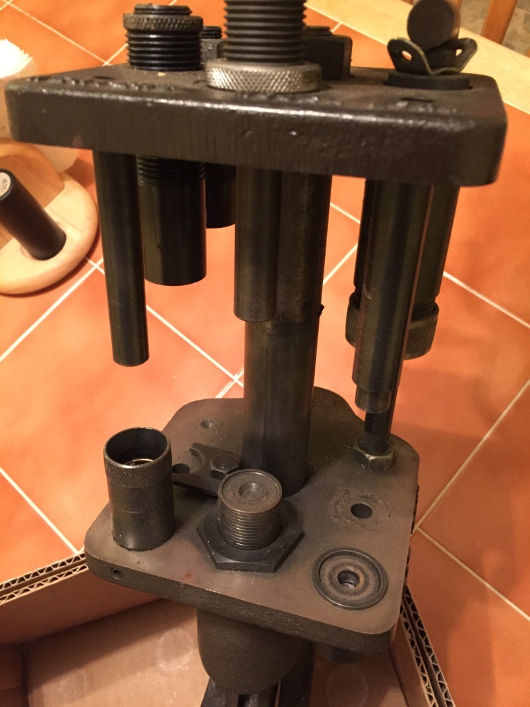

A picture of the powder and shot dispenser on top of the loader

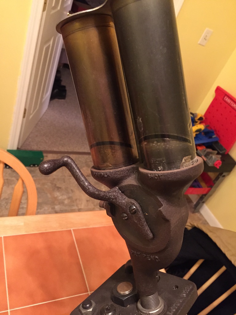

A picture of the shotshell reloader
