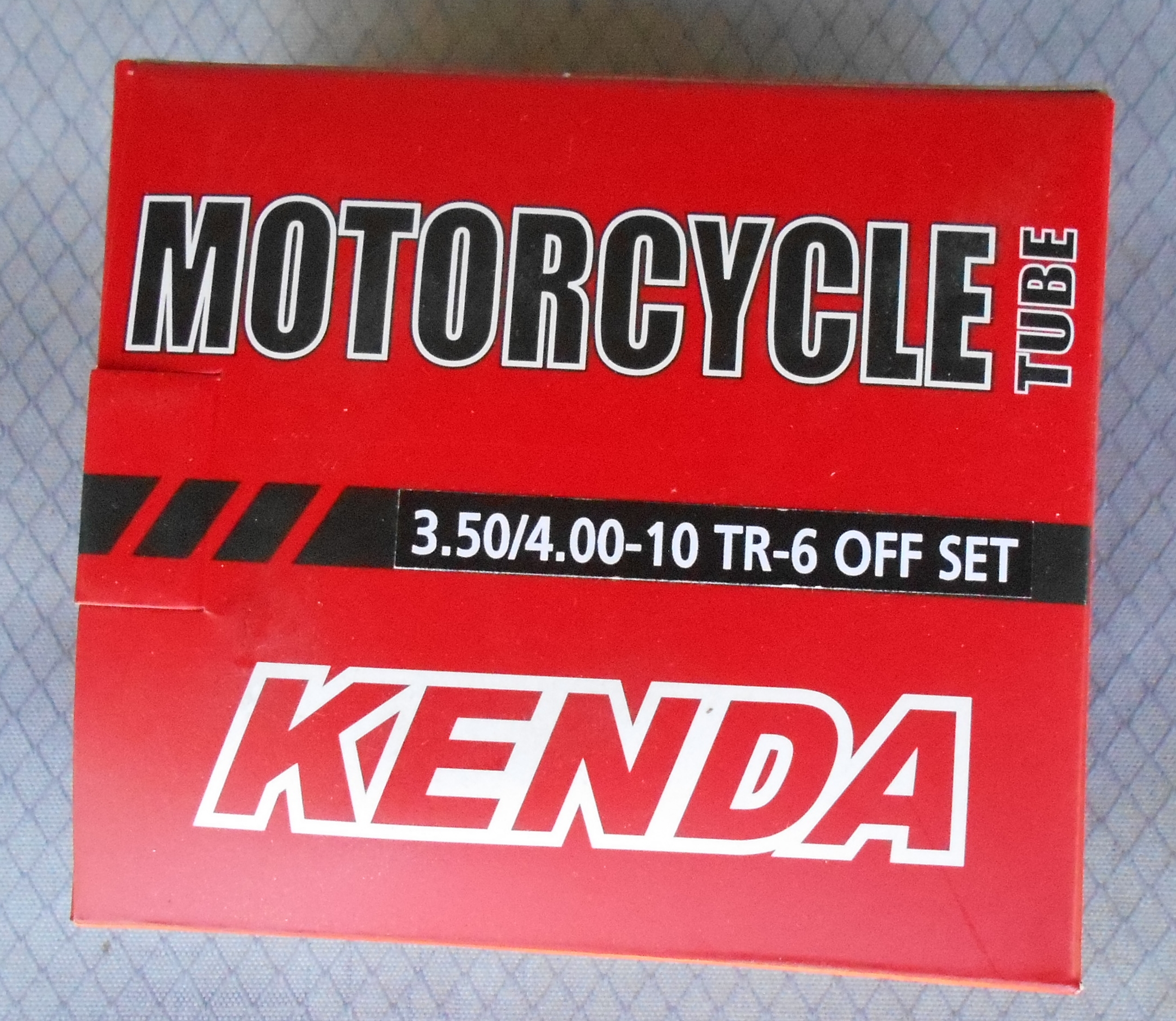

The tubes I have coming have TR6 threaded, offset valve stems, unlike the original TR13 centered rubber ones - not expensive, so worth trying.

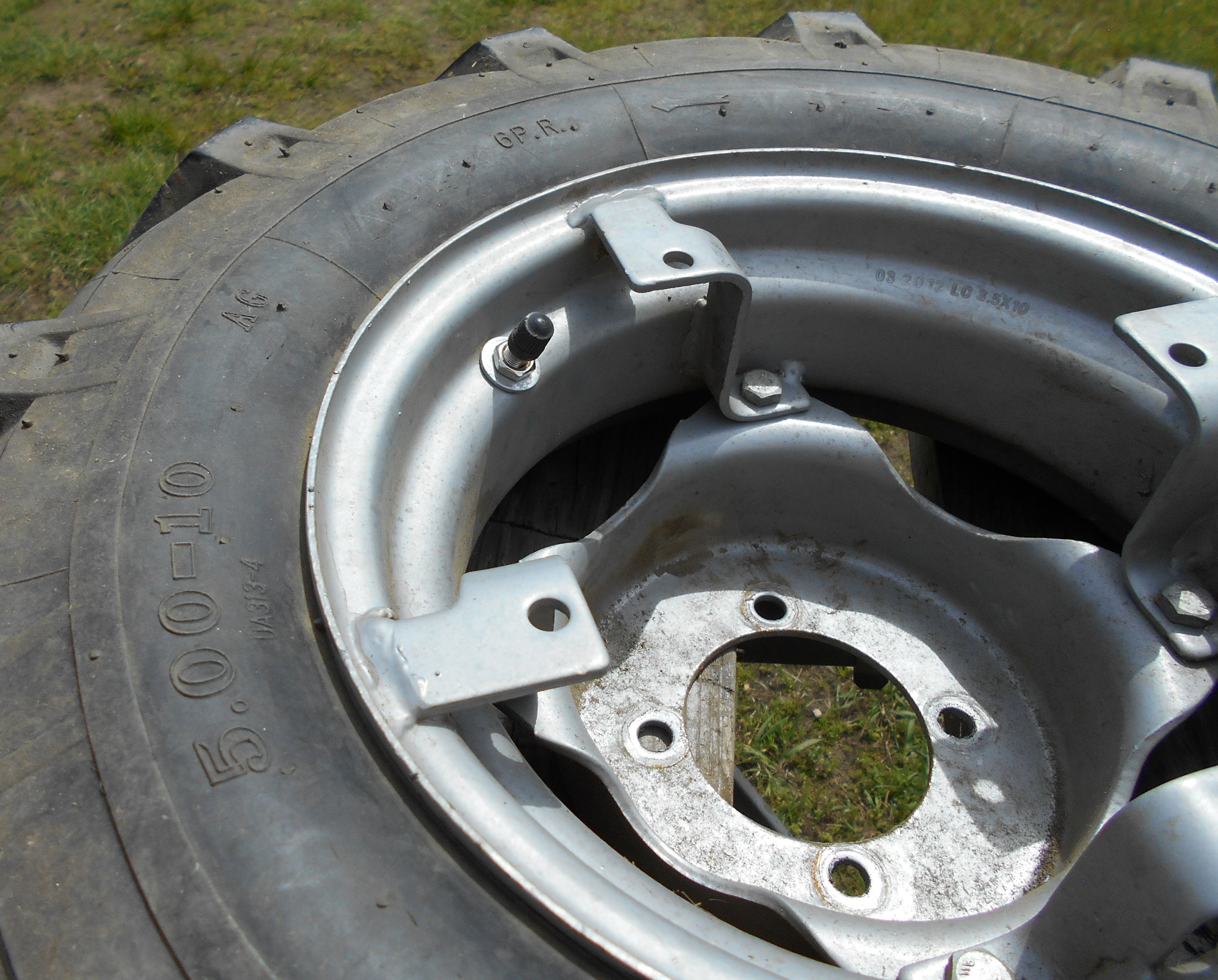

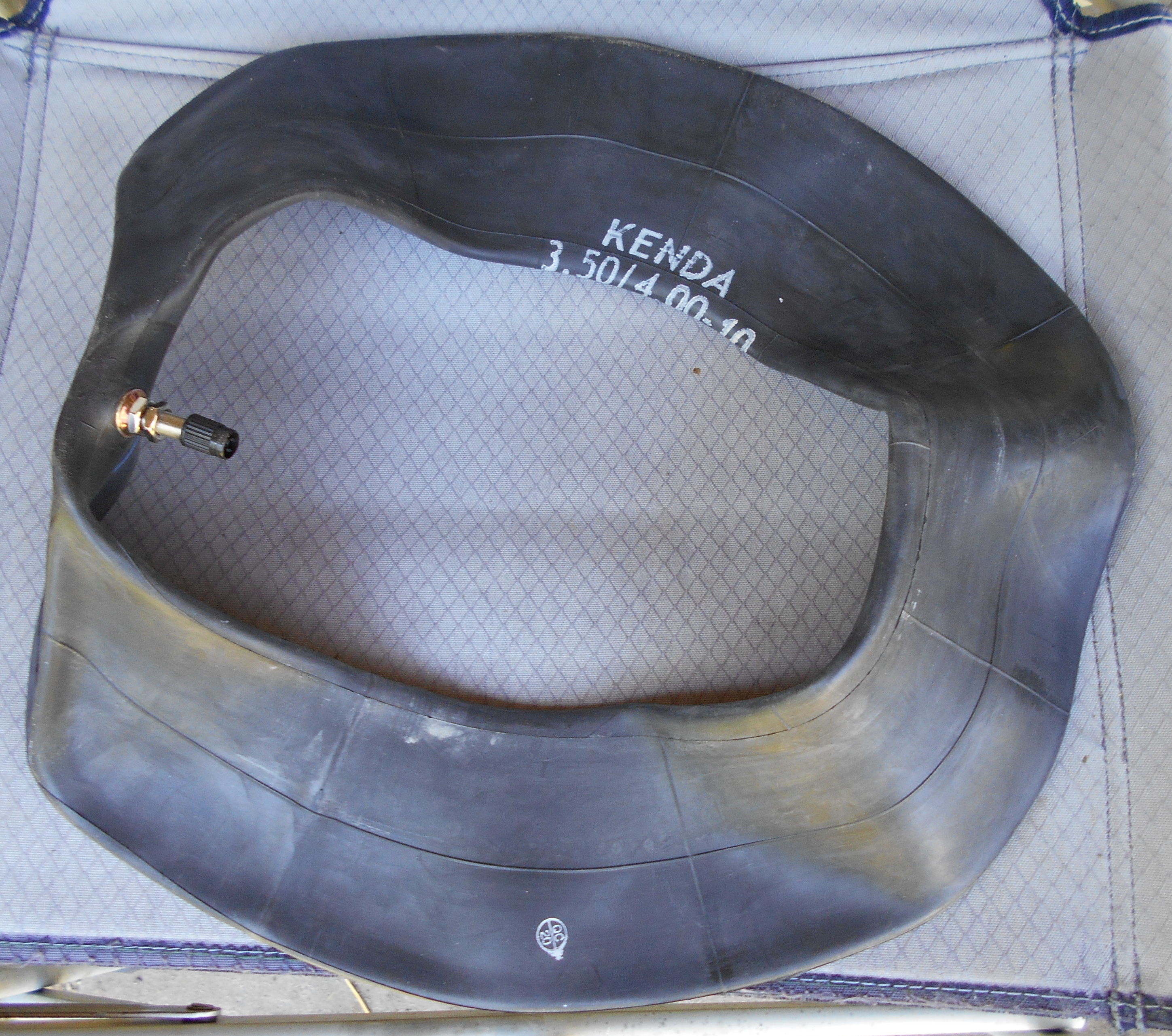

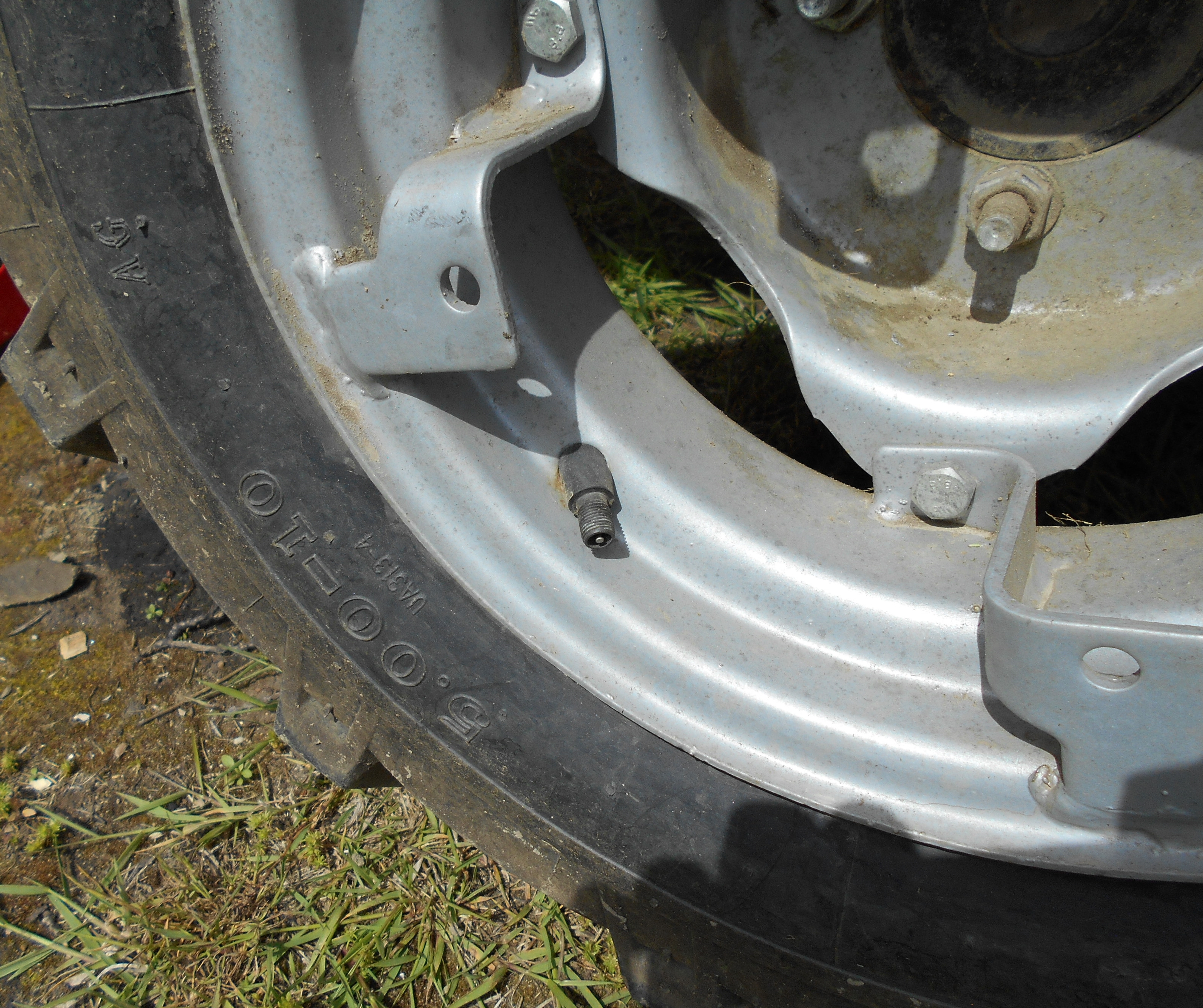

So, the new tubes showed up from an on-line motorcycle supply place - apparently this size is very common for European scooters like Vespa, Lambretta etc., around $13 CAD.
This is one of my original tubes, always slightly over-inflated but still ready to rip off.
And this is the new tube installed. The lock-nut was almost the same diameter as the hole in the rim so I added a galvanized washer.
Seems like an improvement to me? Time will tell.
:drink:
