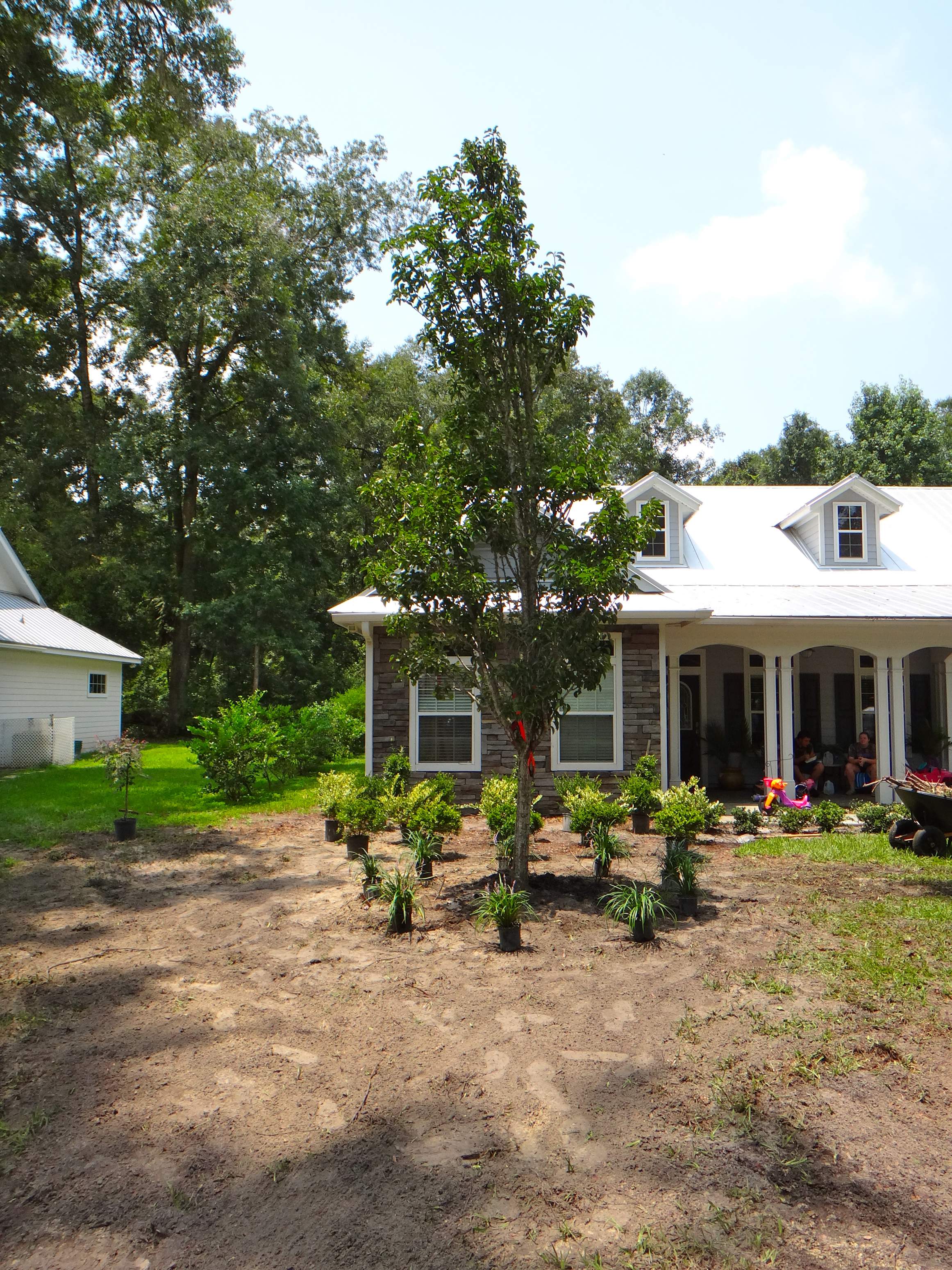

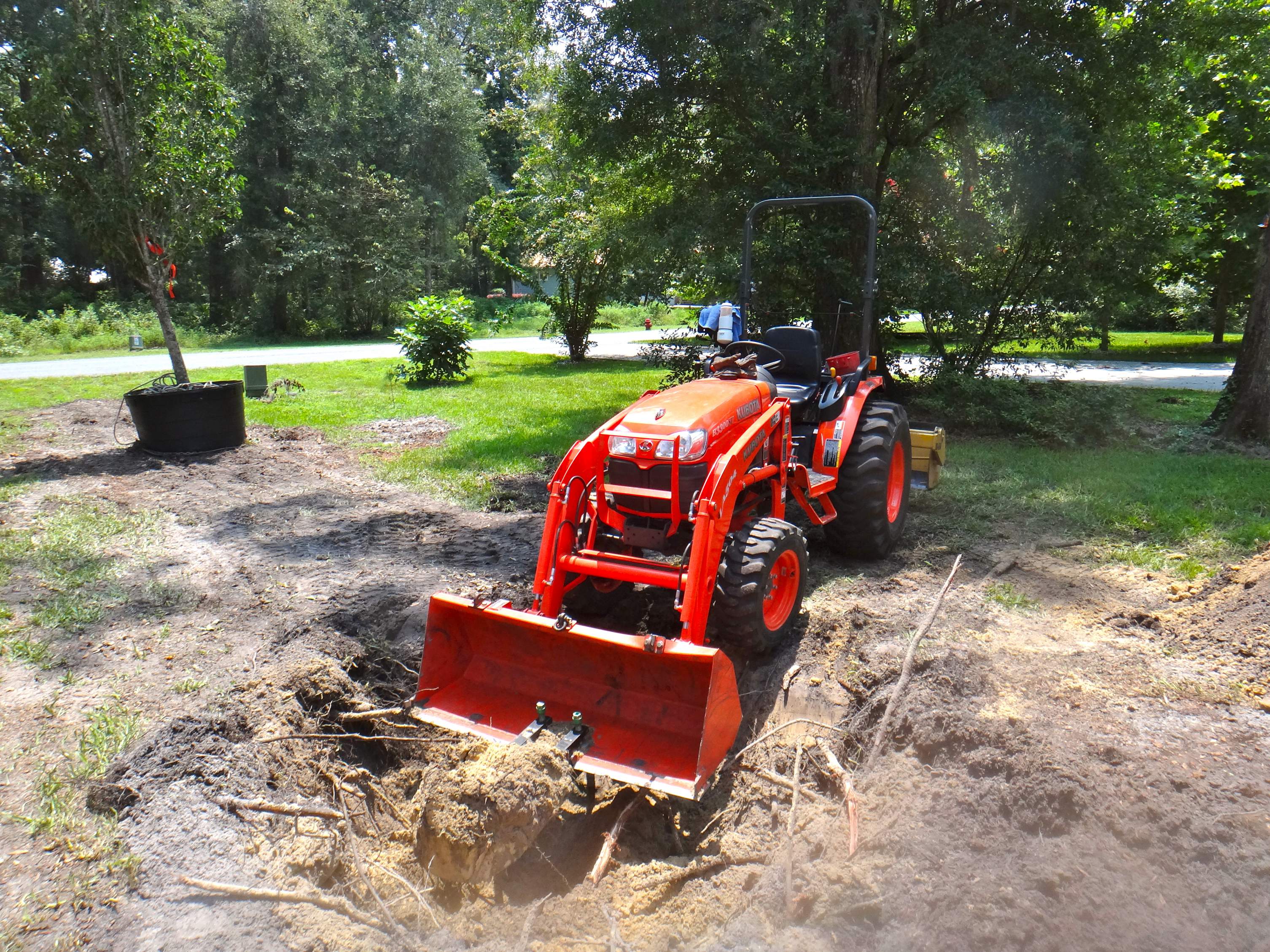

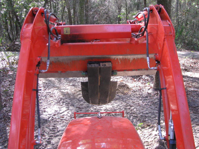

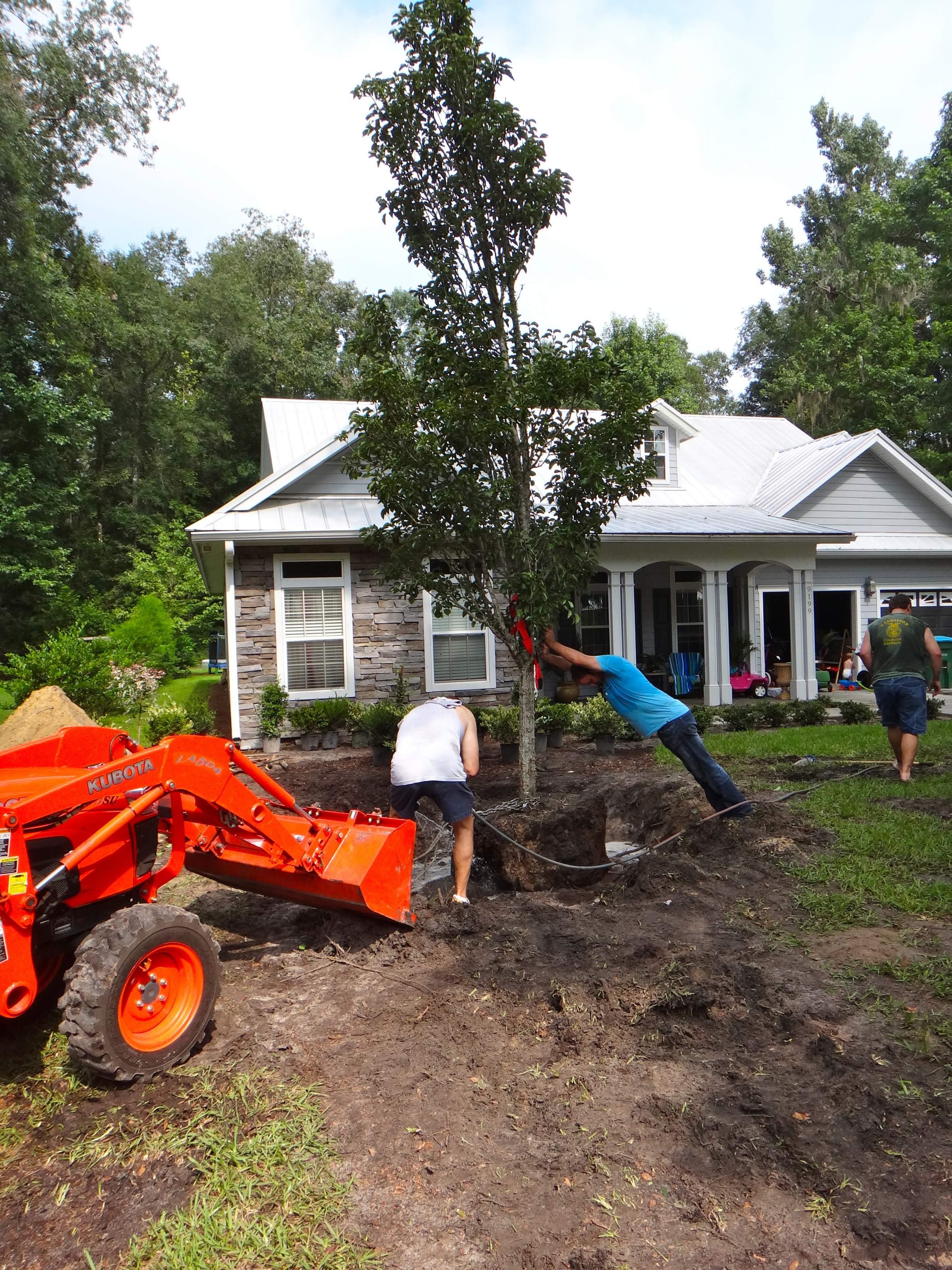

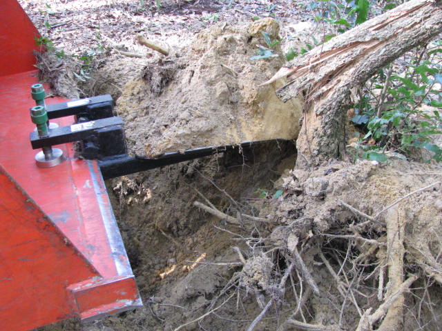

I have used my Bucket Spade to take out Oaks; generally satisfactory up to 3" diameter, then the roots get too hard, too plaited and too deep. I think softwood Pines would be easier. The spade weighs 100 pounds and it arrives sharp and remains sharp; high quality steel.
The Bucket Spade weights 100 pounds. It is rigidly mounted on HDRB bucket which is 397 pounds, which is mounted on LA805 FEL which weighs 1,279 pounds, so total static weight on the Bucket Spade as I position it to go into the dirt is 1,776 pounds, more or less. Then, you can begin to wiggle the FEL, or push the Bucket Spade into the ground with tire traction. You can understand while I prefer the HDRB Bucket over Kubota's standard bucket for mounting the Bucket Spade rigidly.
Bucket Spade is NOT a Backhoe but it does 50% of what a Backhoe does and may be equal for tree planting-----for $400. I believe in keeping attachments simple, and the Bucket Solutions (brand) Bucket Spade is SIMPLE, SIMPLE, SIMPLE.
