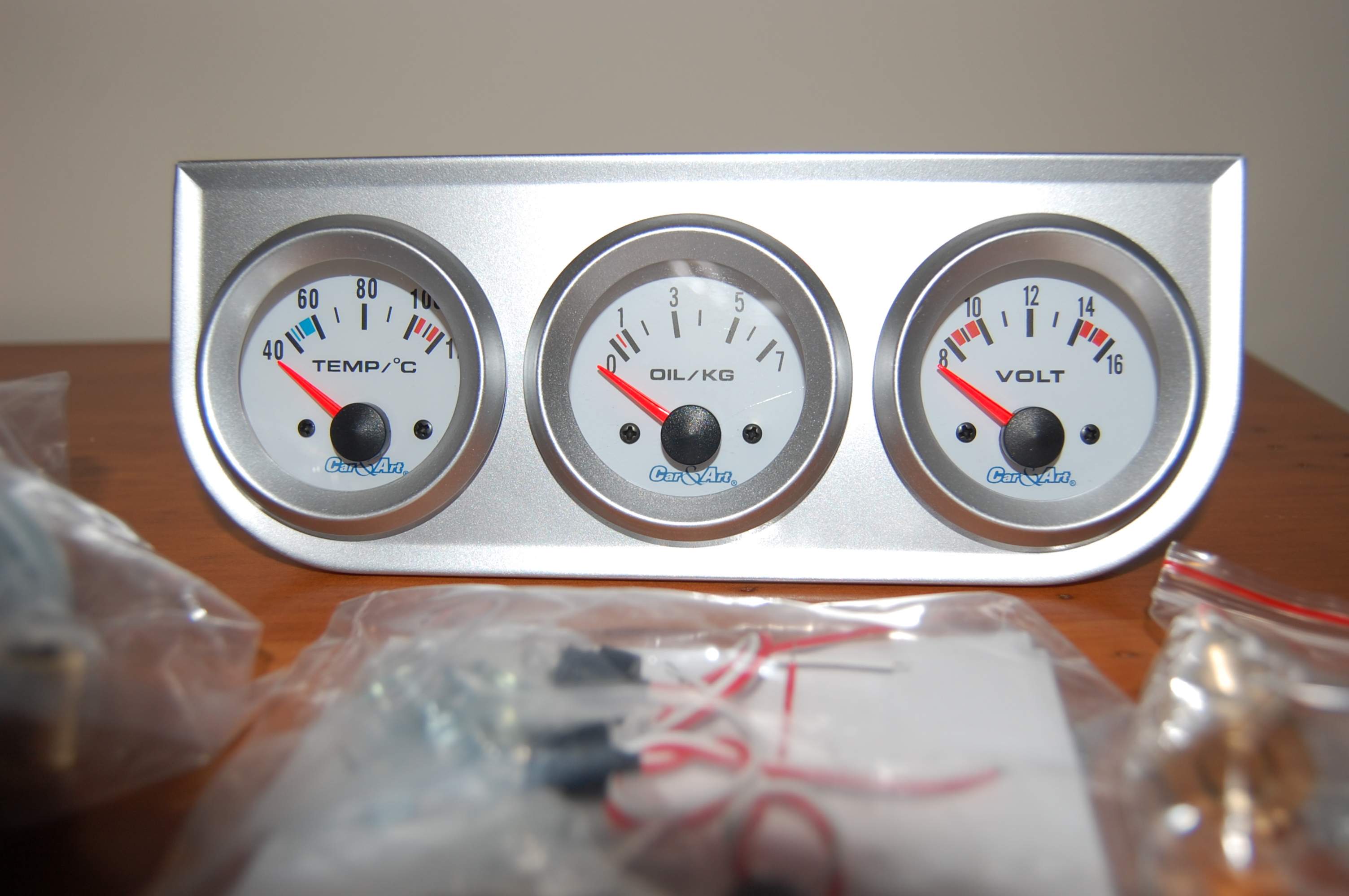

i just bought another set off Ebay but it was from a local seller in Australia,Volt,Oil and Temp. all electric with senders and adaptors for $65 delivered to my door.:thumbsup:

they arrived,same as the ones i previously bought but just a different name on them.comes with senders and all accessories.
Nice looking gauge set and good price. I am going to get a temperature gauge like the oil pressure one I have and leave the charging light as is. I probably don't need the temp gauge but in the summer I would like to know if the radiator is getting plugged up before it gets hot enough for the light to come on. I will have to find an adapter for the block as I don't think the temp gauge comes with one. It might but I doubt it.
Are those 2" or 1 1/2"?

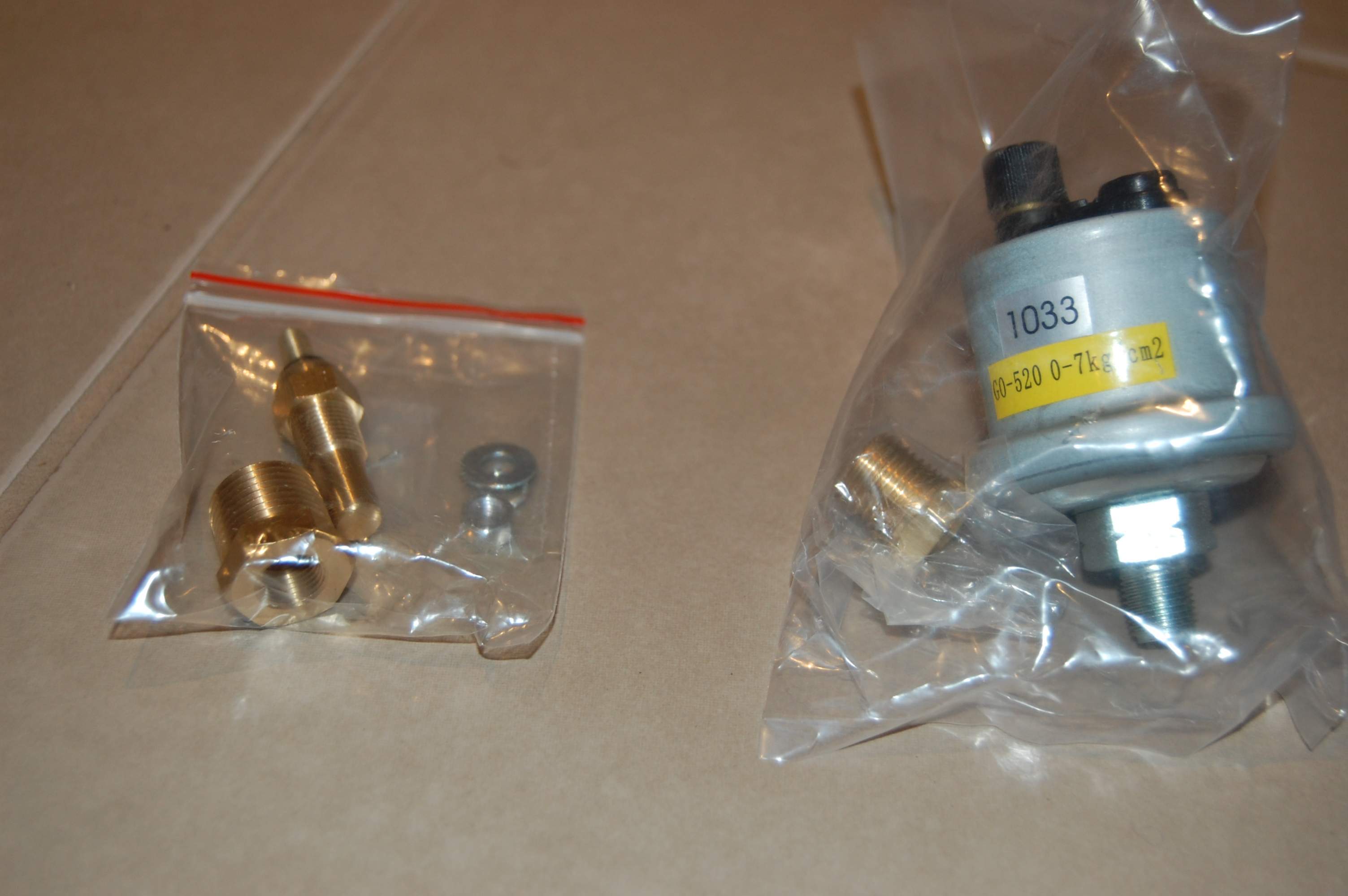

they are 52mm, close enough to 2". the oil sender and temp senders both came with adaptors.
I should have taken the time to look and see if they had a US version set of gauges. Could have gotten all 3 for the price I paid for the oil gauge.
While you are at it - can you measure that adapter and tell us the thread size where the temperature sensor goes into the block? I think that opening is 15mm, not British Standard like the oil pressure sensor. Thanks!
Will do, report back shortly.:thumbsup:
