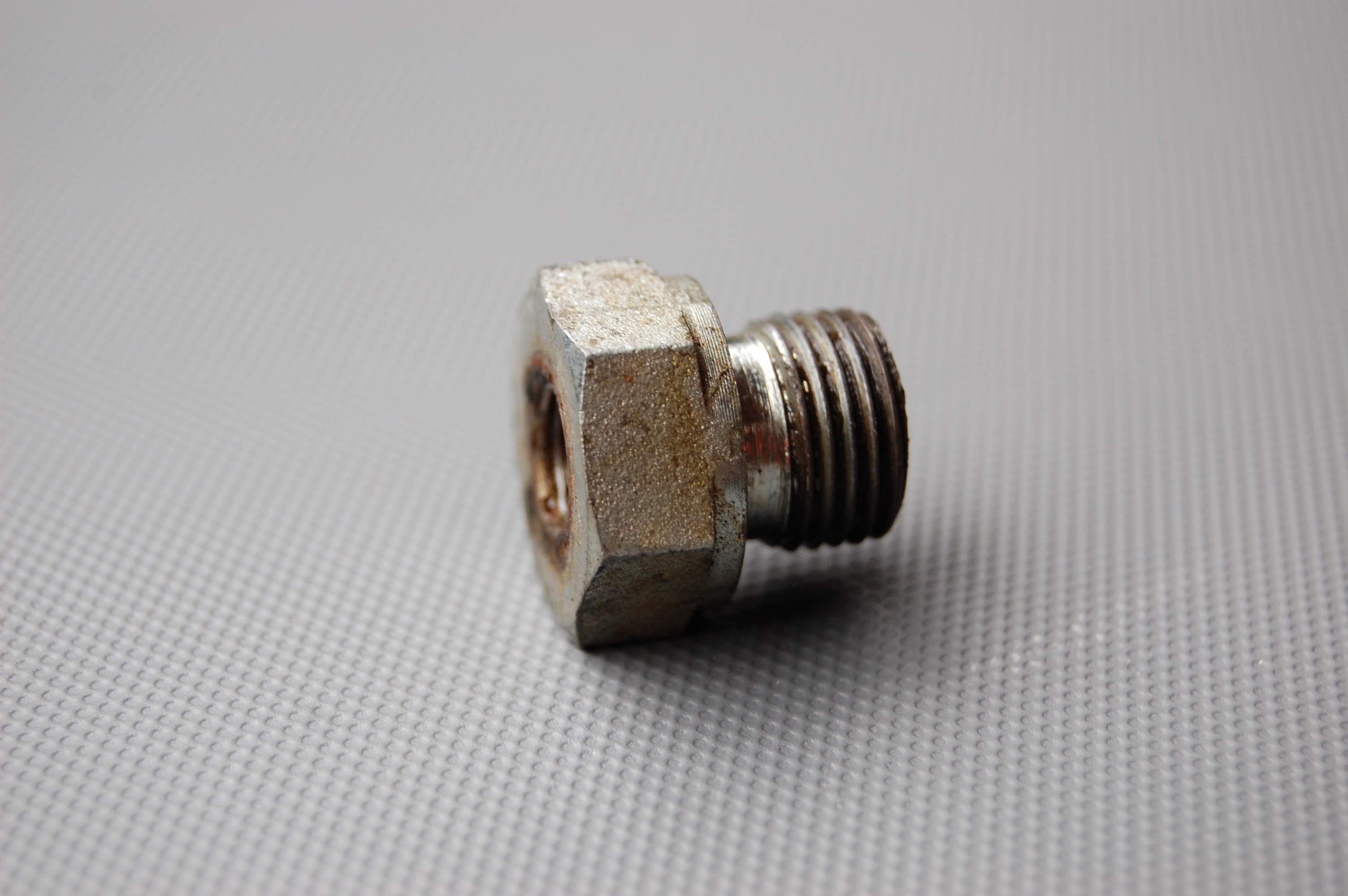

While you are at it - can you measure that adapter and tell us the thread size where the temperature sensor goes into the block? I think that opening is 15mm, not British Standard like the oil pressure sensor. Thanks!
From an old post dated 10/14/01 (not sure what forum--I saved it in a text file) the temp sensor thread for a 1700 is a 16mm x 1.5mm. That's what fit on my 1500. I would suspect yours is the same.
   / Install oil pressure gauge #33
Yeah but ... There have been a lot of posts on here speculating what is in there but so far as I know nobody ever measured one - therefor my question.
Every time I post that I think it is M15x1.5 (the adapter I bought for it after research, then never installed), somebody replies he's certain its BSP.
That's why I'm hoping Neat can settle this for us.
   / Install oil pressure gauge #34
OK, here's the scoop. i pulled the sender adapter out of the 1500 and checked it, pulled the OEM sender out of the YM14 and measured it. checked it with the aledged size die nut and it fitted perfectly.want to know what it is?..................................M16x1.5. i was taking photo's of all of this but my SLR died at the start so i only have the 1 piccy of the adapter from the 1500. i actually swapped gauges around as i know what the 1500 ran at so i am comparing readings with the new set which is MUCH better than the Hong Kong set previously bought. i will put that set in the YM14. the 1500's adapter has and O ring on the back of it so a taper on the thread wasn't required.

Neat, thank you!!
Finally, real data on Yanmar's fittings.
So in summary:
M16 x 1.5 : Water temp sender.
1/8" British Standard Pipe Thread (also widely used on Japanese cars): Oil pressure sender.

Correct. i went to my hydraulic place this afternoon to buy some 1/8 BSPT elbows and an extension piece(the YM14 oil sender hits the belt so need to offset) and one of the guys there wasnt aware oil threads on Jap Vehicles were BSPT but the other 3 did.:thumbsup:
