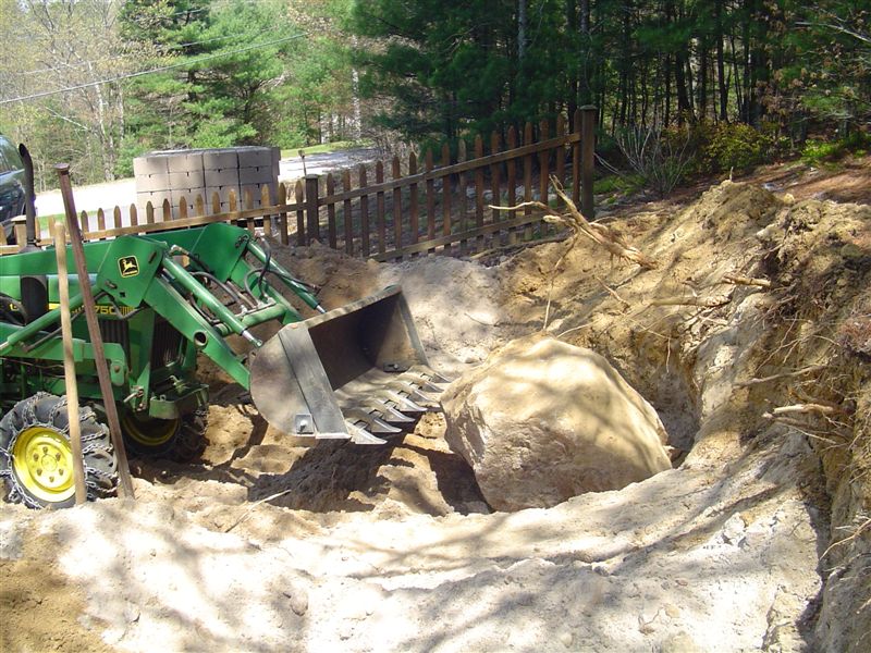

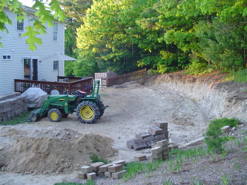

The teeth on the Markham bar seem heavy duty. They are not tines and indeed more like what you would find on a backhoe bucket. In no way would you begin to approach the cost of a toothed bucket with a Markham tooth bar. I had them put 2 extra teeth on my bar and it still came under $250. Prices may be a bit changed as I bought my bar several years ago. Here's a picture of the mounted bar along with the work it helped to do and you can judge for yourself.

I also went with a Markham toothbar and it was not hard at all to drill through my bucket to install it.
