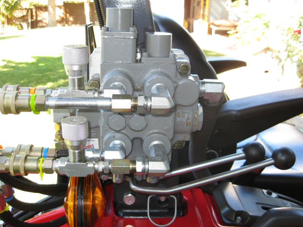

Here are some pictures of my hydraulic top link and side link.

Mtn view, are you using a handle type or electric valve for controls? I wonder if I could use a pushbutton and do it like tilt and trim on my old boat? Jy.
I'm using a mono block with 2 valves, 1 with float position that is used for my side link. Sorry that I can't help you out about the electric valves, don't know why you wouldn't be able to use them though. :confused3:

First, please let me apologize to user rjkobberman for hijacking his thread, but I thought this info might help somebody else who's getting ready to try this:
Here are some step-by-step photos of my "build a side link cylinder restrictor" exercise. The wire-in-a-slot thing was AKKAMAAN's idea, and it worked fine. The side link action is now really smooth and I can feather it to move as slow as I want.
Photo Key:
Photo 1 -- I used a 3/8 NPT male to 3/8 NPT female swivel for the restrictor's body, and cut threads on the inside of the barrel for about 75% of it's length with a 3/8-16 tap, starting from the long (male) end. Then I cut a 3/4" piece from a 3/8-16 mild steel bolt, cut a screwdriver slot in one end of it with a hacksaw, and used a Dremel and .050" thick cutoff wheel to make a fluid relief slot the full length of the threads. Because the Dremel was handheld during this cut, it's not a perfect .050" slot, it's probably more like .060" or so.
Photo 2 -- After screwing the plug in jam-tight in the barrel, I installed it at the rod end of the cylinder. Resulting cylinder action was noticeably slower, but still too fast for my liking and still a little hard to feather. So I clearly needed yet more restriction, and AKKAMAAN's bent-wire idea seemed the way to go.
Photo 3 -- I cut a piece of stiff .033" nichrome wire and bent the ends 90 degrees, leaving it a bit long to allow some movement back an forth to help avoid future clogging. This resulted in a little more than 1/16" allowed back and forth movement of the wire piece.
Photo 4 -- Another view of the wire in the slot..
Photo 5 -- Reinstalling the restrictor plug and wire in the connector body.
Photo 6 -- End view of the completed restrictor with wire installed.
Once you have the plug and slots made, changing wire sizes is easy to do if you want to experiment. In my case, I got lucky and the .033" diameter wire worked out exactly right the first try.
I did notice that after maybe 8 or 10 full cycles of the side link as I was fooling around testing it, the restrictor body was slightly warm to the touch. I suspect if I jacked it around a LOT it would heat up pretty good. Tiny fluid path, lots of pressure, lots of heat generated. Obviously, this idea wouldn't work well on a long-stroke (loader) cylinder, or a cylinder that gets jacked back and forth a lot. For a small side link, though, it works great.
