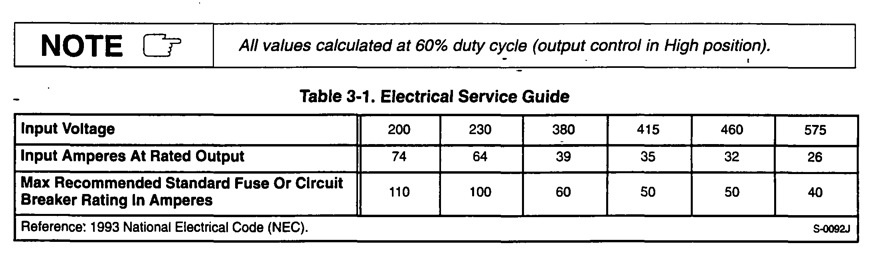

Wow, What plasma cutter do you have that draws 70 amps at 240 volts?
   / Installing 240V Service To Your Shop - Price Breakdowns... #38
Miller Spectrum 700 - and I did not remember correctly - 64 amps draw.
I have it on a 70 amp breaker.
74 amps is for 200 volt service
Only two settings on the old girl, high and low.

Is that an older model? The reason I ask is because the 700i (your's might not be an "i" model) only calls for a 25A breaker. Just wondering, becuase I could see getting a plasma cutter in my future. Thanks. :thumbsup:
   / Installing 240V Service To Your Shop - Price Breakdowns... #40
Yeah, mine is an older 225 lb transformer based machine.
If it ever burns up I'll get one of the new fangled light little machines too :)
