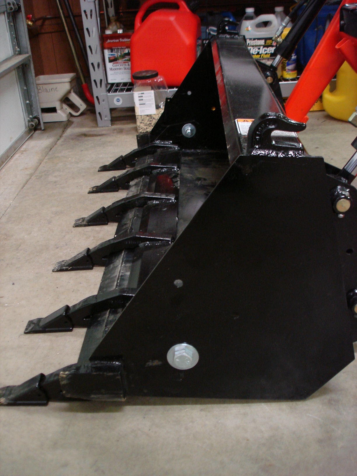

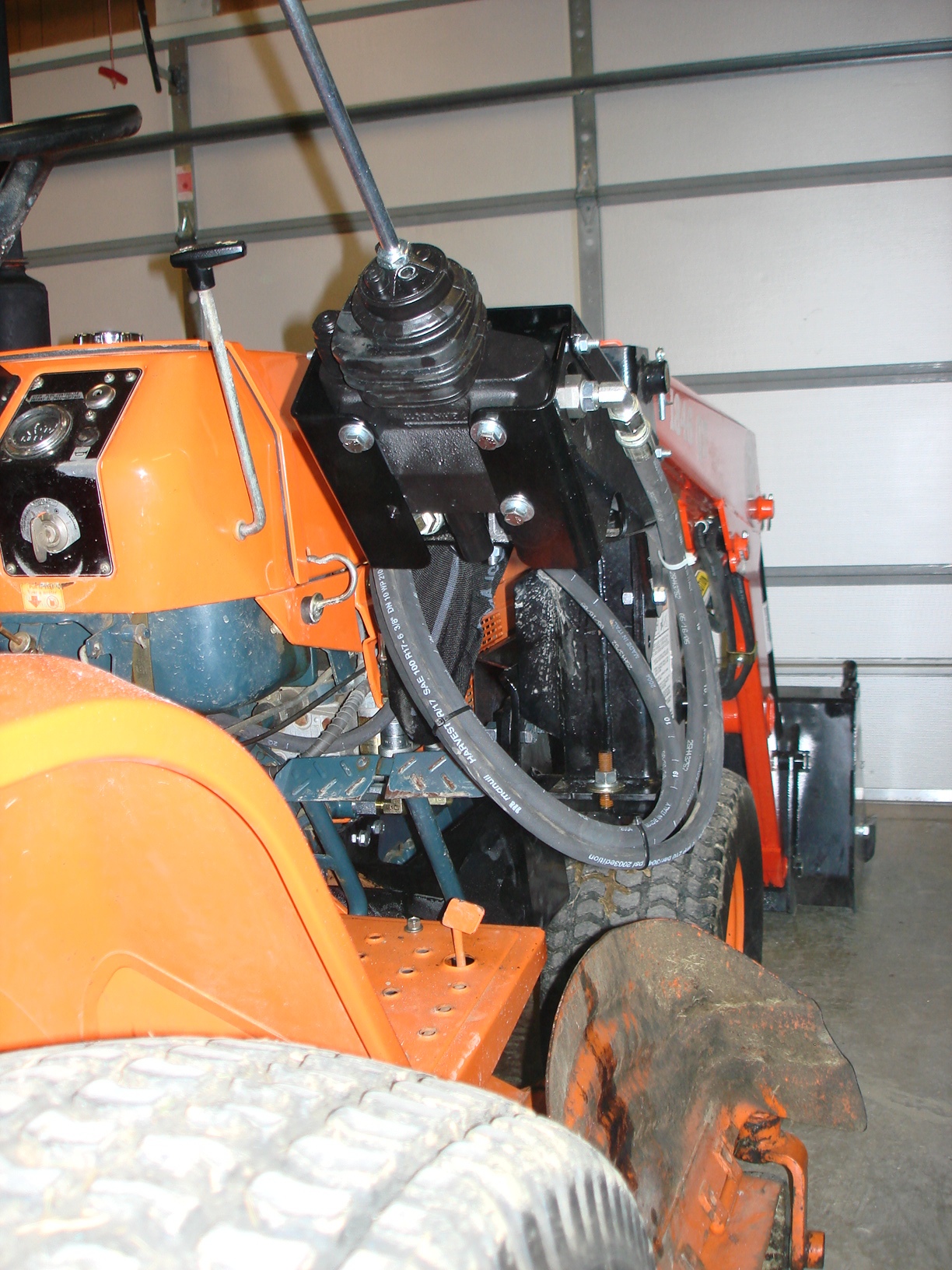

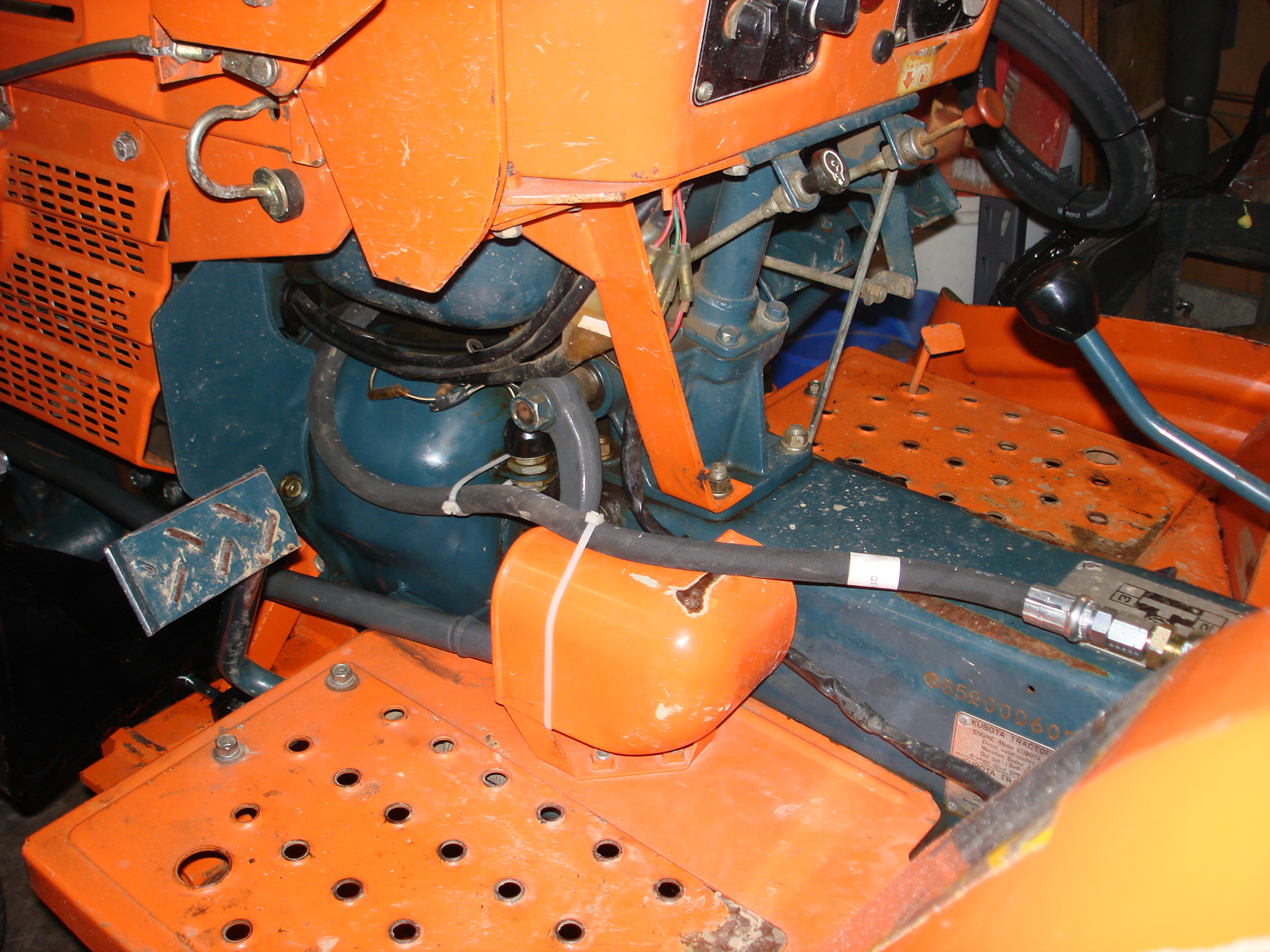

I ran it straight ahead along the back side of the firewall, and out the right side. It looks like a good location, so we will see. Just got the hooks welded on, and toothbar attached. My Easter project.:)

Got tootbar and hooks on today...
Did you weld the tooth bar into place?
Also I read your other comment about needing ballast. We'll all be waiting to see what you come with there. FEL looks nice. I'm sure I'll be a nice asset to have around the house. And since you put it on yourself you won't be intimidated if need/want to take it off.

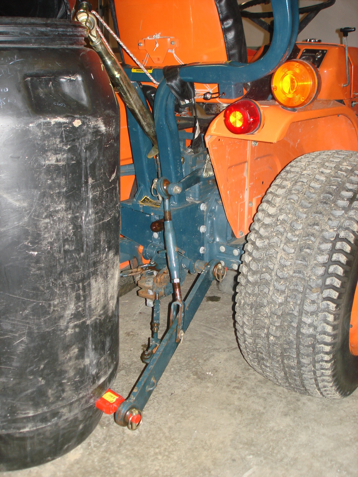

I bolted it on after drilling two 13/16" holes. I've got my ballast in the works in the picture below. I bought a CAT 1 top link that is just too long. I got to return it for a shorter one.
