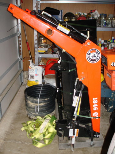

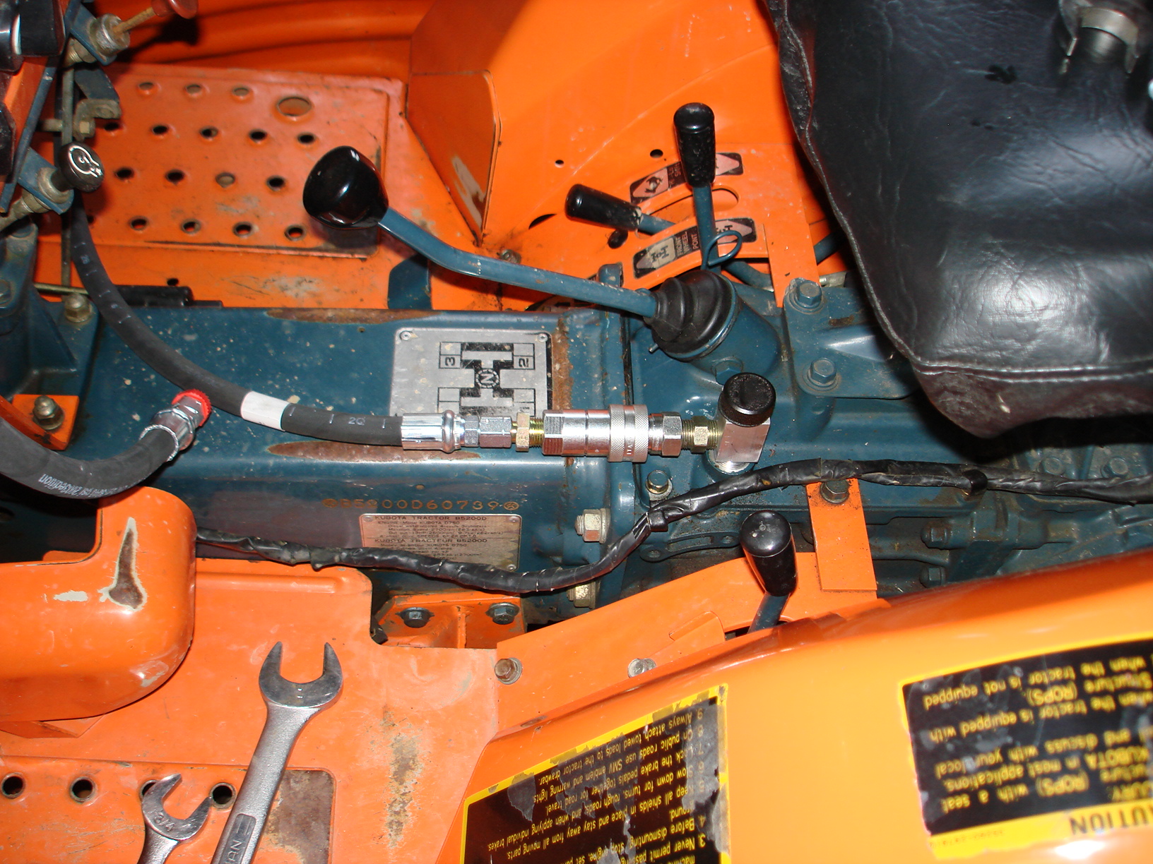

My Bush Hog FEL came in this week, and I opted to install it myself. I'm about 1/2 way done and am glad that I did it myself. So far I have one question. I have the line that goes from the loader valving to the fitting that goes in the fill hole for the tranny. The line is 90" long, which is really long in comparison to the size of the tractor. I read somewhere that it is usually routed under the operator's station. Does that mean that it goes toward the back of the tractor, around the seat and over to the valving, or under the tranny some how......??????????? It is on the left side of my gear shifter, and needs to attatch to my right hand control box.

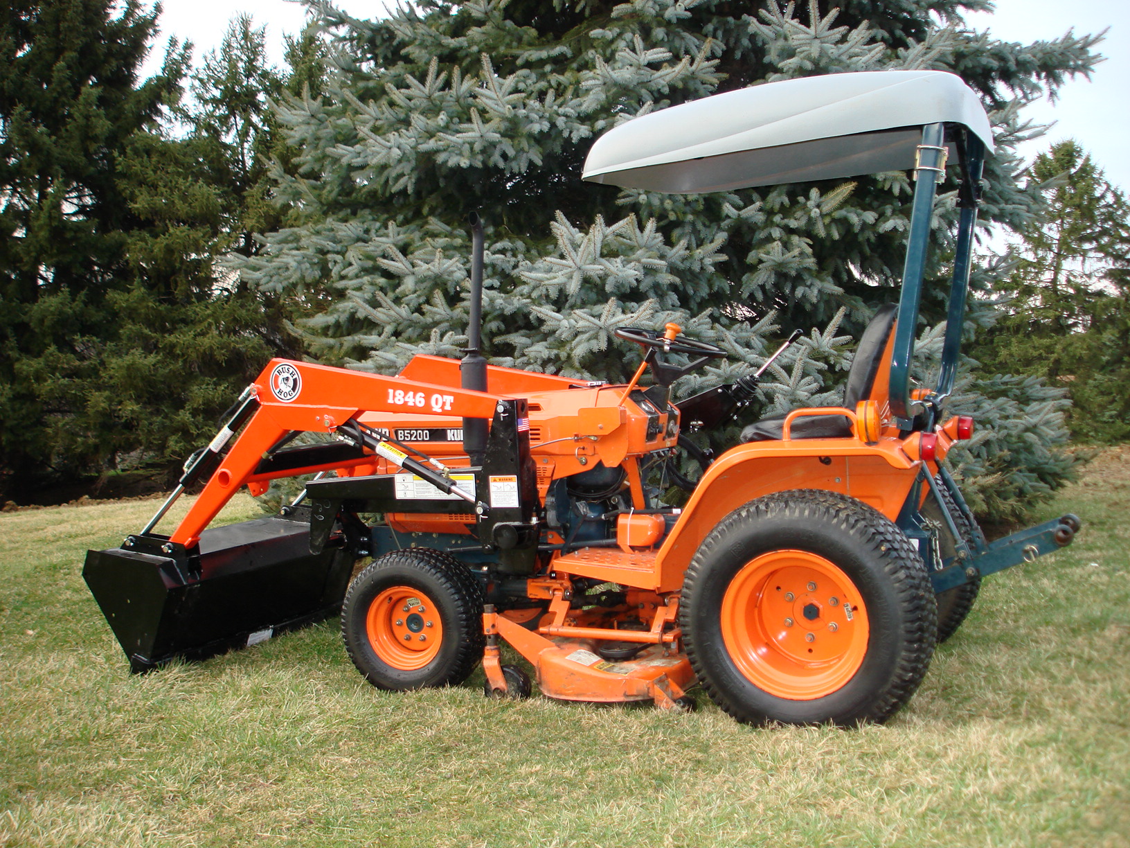

Well I got my FEL installed in about 6 hours. Not bad for a first timer on a FEL I guess. I bled off the air in the system, and added about one gallon of hydraulic oil. I am busy making my ballast weight, and have a toothbar to put on yet as well. It's here, just got to drill the holes and bolt it up.:cool:

Yeah, ya know that sounds like a good pay rate to me! And, I got education in the process.;) I ought to ask my boss if he wants to start paying me that much.....LOL! We all know what that answer would be....:D

It was very straight forward. I was worried at first because the main manual had very few instructions in it. Then, as I unpacked the parts, instructions started appearing with each kit. Very easy to understand, and there was only one time that I used my floor jack to assist. Bush Hog did a great job. All of the bolts, hoses, and fittings were there, except for the one that you are told to buy from Kubota when you order the kit. Great job Bush Hog!:cool:
So where did it go?
