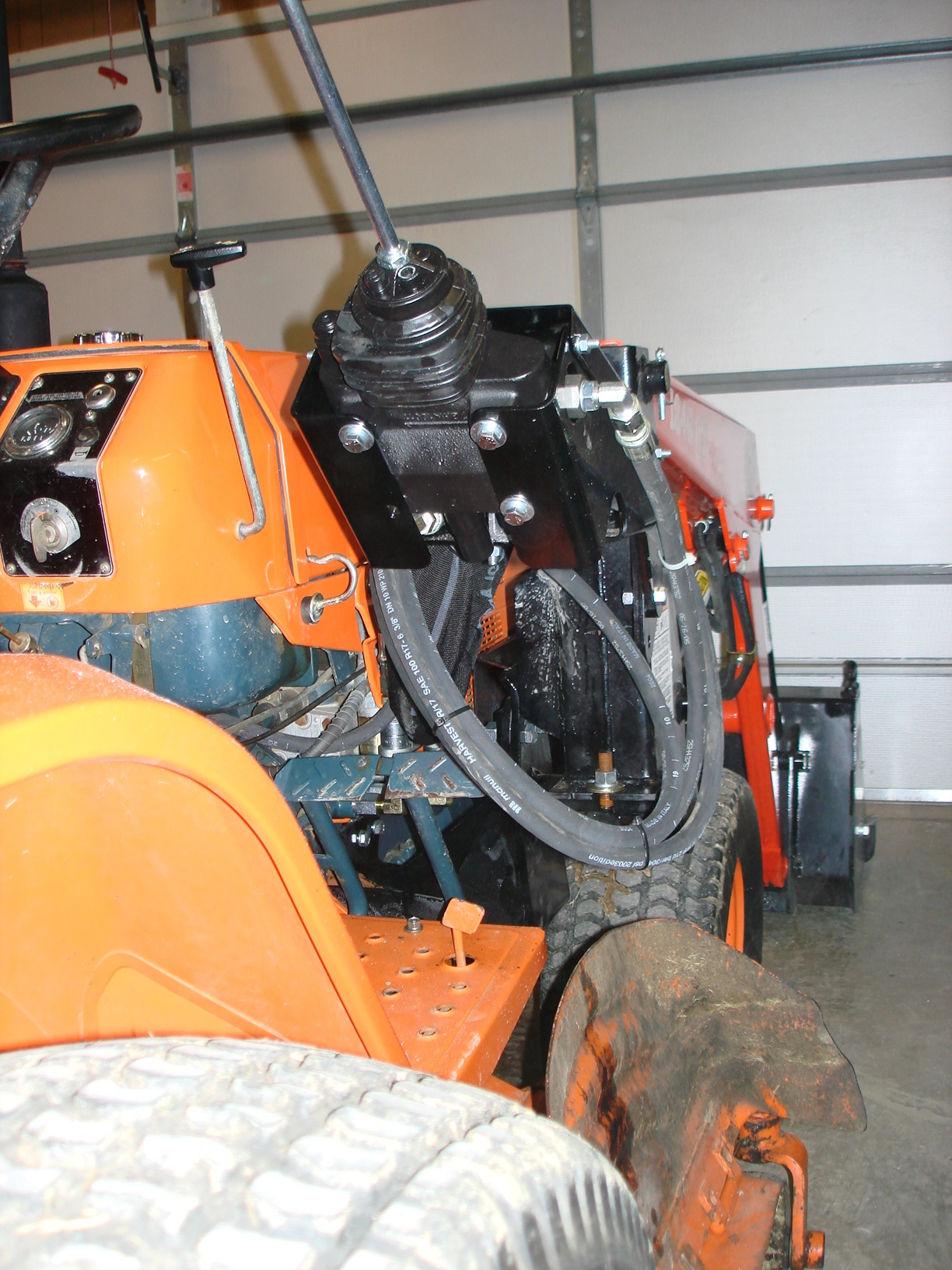

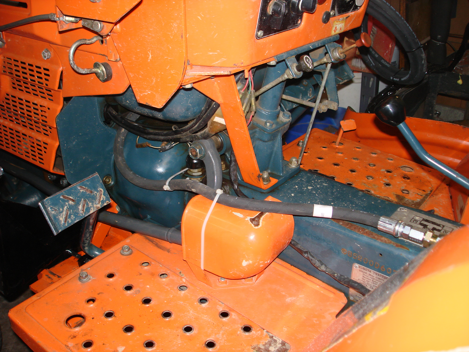

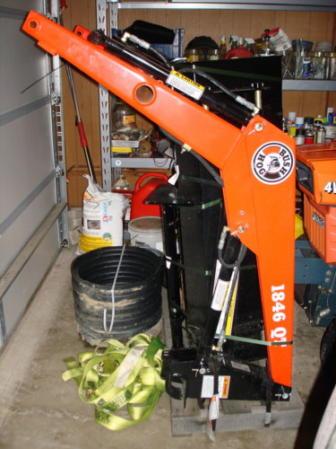

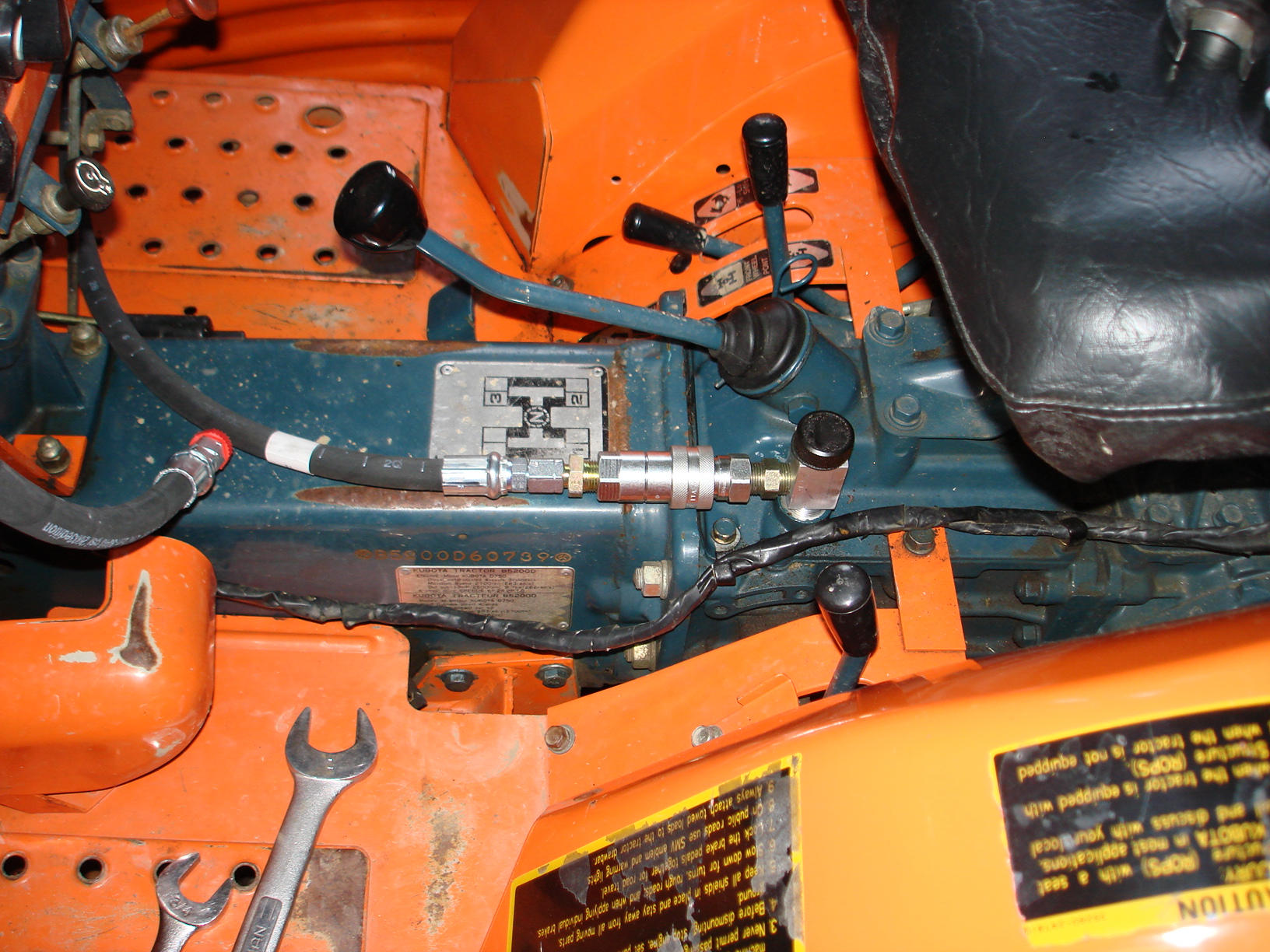

My Bush Hog FEL came in this week, and I opted to install it myself. I'm about 1/2 way done and am glad that I did it myself. So far I have one question. I have the line that goes from the loader valving to the fitting that goes in the fill hole for the tranny. The line is 90" long, which is really long in comparison to the size of the tractor. I read somewhere that it is usually routed under the operator's station. Does that mean that it goes toward the back of the tractor, around the seat and over to the valving, or under the tranny some how......??????????? It is on the left side of my gear shifter, and needs to attatch to my right hand control box.

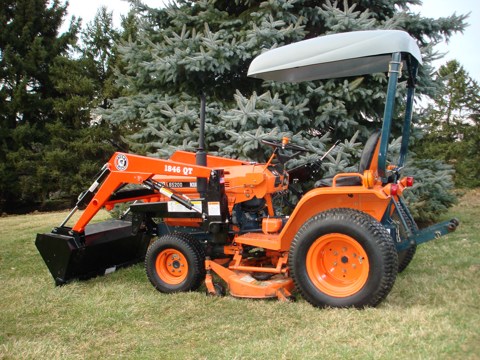

Well I got my FEL installed in about 6 hours. Not bad for a first timer on a FEL I guess. I bled off the air in the system, and added about one gallon of hydraulic oil. I am busy making my ballast weight, and have a toothbar to put on yet as well. It's here, just got to drill the holes and bolt it up.:cool:
So where did it go?

Mike058 said:
So where did it go?
I ran it straight ahead along the back side of the firewall, and out the right side. It looks like a good location, so we will see. Just got the hooks welded on, and toothbar attached. My Easter project.:)

Like this:

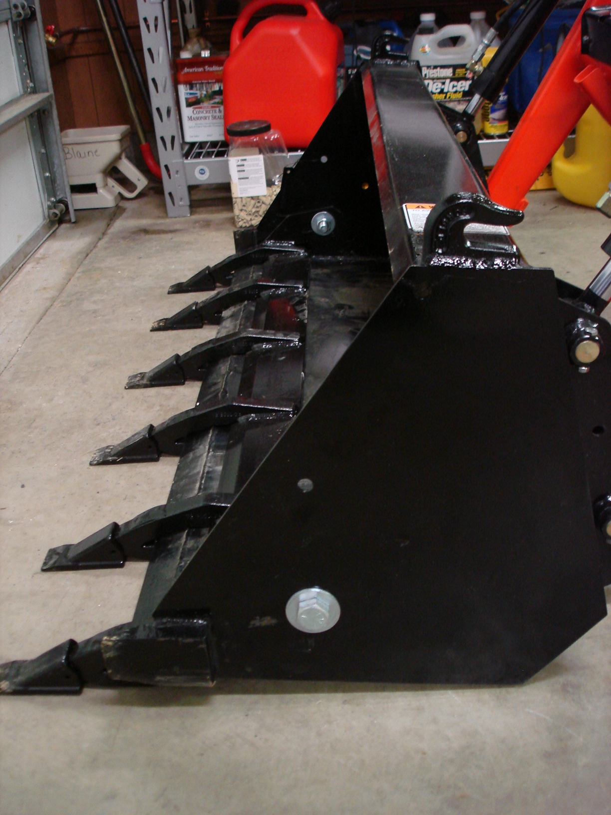

Got tootbar and hooks on today...

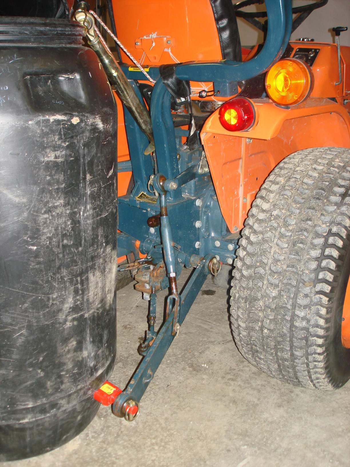

wedge40 said:
Did you weld the tooth bar into place?
Also I read your other comment about needing ballast. We'll all be waiting to see what you come with there. FEL looks nice. I'm sure I'll be a nice asset to have around the house. And since you put it on yourself you won't be intimidated if need/want to take it off.
Wedge
I bolted it on after drilling two 13/16" holes. I've got my ballast in the works in the picture below. I bought a CAT 1 top link that is just too long. I got to return it for a shorter one.
