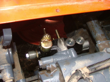

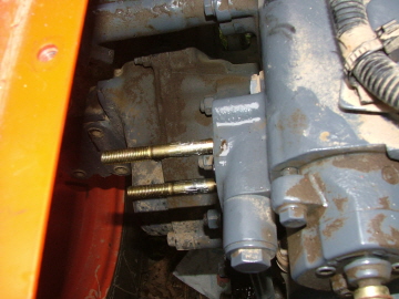

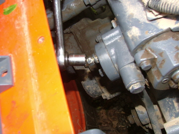

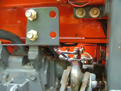

Installed kit, worked slowly, took me about 4 hours.
Don't need to remove tire as instructions say. Not too hard, study everthing a few times before you start and of course keep everthing very clean; the box works well to keep all the parts in until you are finished.
Seemed to work with no leaks, don't have anything to hook it to yet but put load on tractor in both forward and back control positions.
Not sure of order of pics. Got the kit from Rick Wallace for about $290 incl. shipping.

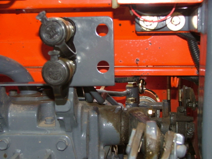

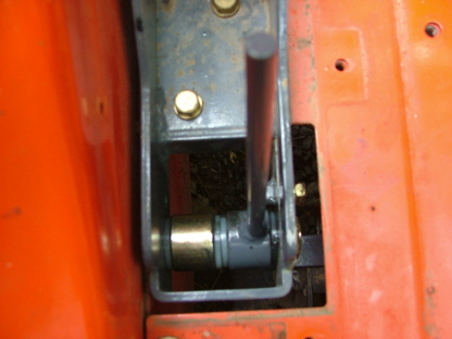

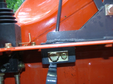

More pics.
I used a little teflon tape on open threads, someone else here said they had a leak without it.
Careful no extra o rings included in kit and you have to re-use the existing ones on the existing big cap held on by the two bolts that are replaced by the threaded shafts...
Do both remotes (a second, different, kit is needed) at the same time as to put a second set on you must remove the threaded shafts (which they told you to put permanent thread lock on) and put the valve you previously installed on the outside position, I think.)
I just got the single remote kit but the mount at the rear of the tractor had space for the second set.

In installing the kit just go slowly, read everything 3 times, don't lose the o rings and tighten everything firmly but don't go overboard (no torque specs supplied in instructions). And note the outlets at the back are bolted in with a lock nut and that o rings go on two places where each output line goes into the valve.

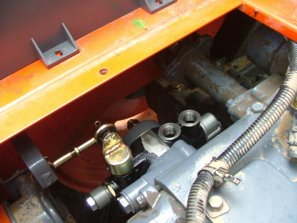

These are for the 2nd remote kit on my 2006 DK45s. I don't know if it will help you or not.
As others mentioned. it is not necessary to remove the wheel. I thought the big loaded tire was more than I could handle solo. Working from below was possible if difficult.
I have the cabbed version of that same tractor. From the instructions, it looks like this kit could be installed without having to remove the cab, right?
/ Installing CK30HST Remote Kit Pics #17
I don't see a need to remove the cab, but I don't have a cab. My kit (that included those instructions) was supposedly for the cab model and there was no mention of removing the cab. In my experience, removing the seat was a pain because it was heavy and hard to access the bolts. If you remove the right rear wheel, there is a removable access plate in the fender that makes installation much easier. But working solo with no safe way to maneuver that big, heavy wheel, I opted to do the work from the top and below. That was tedious but safer, IMO.
