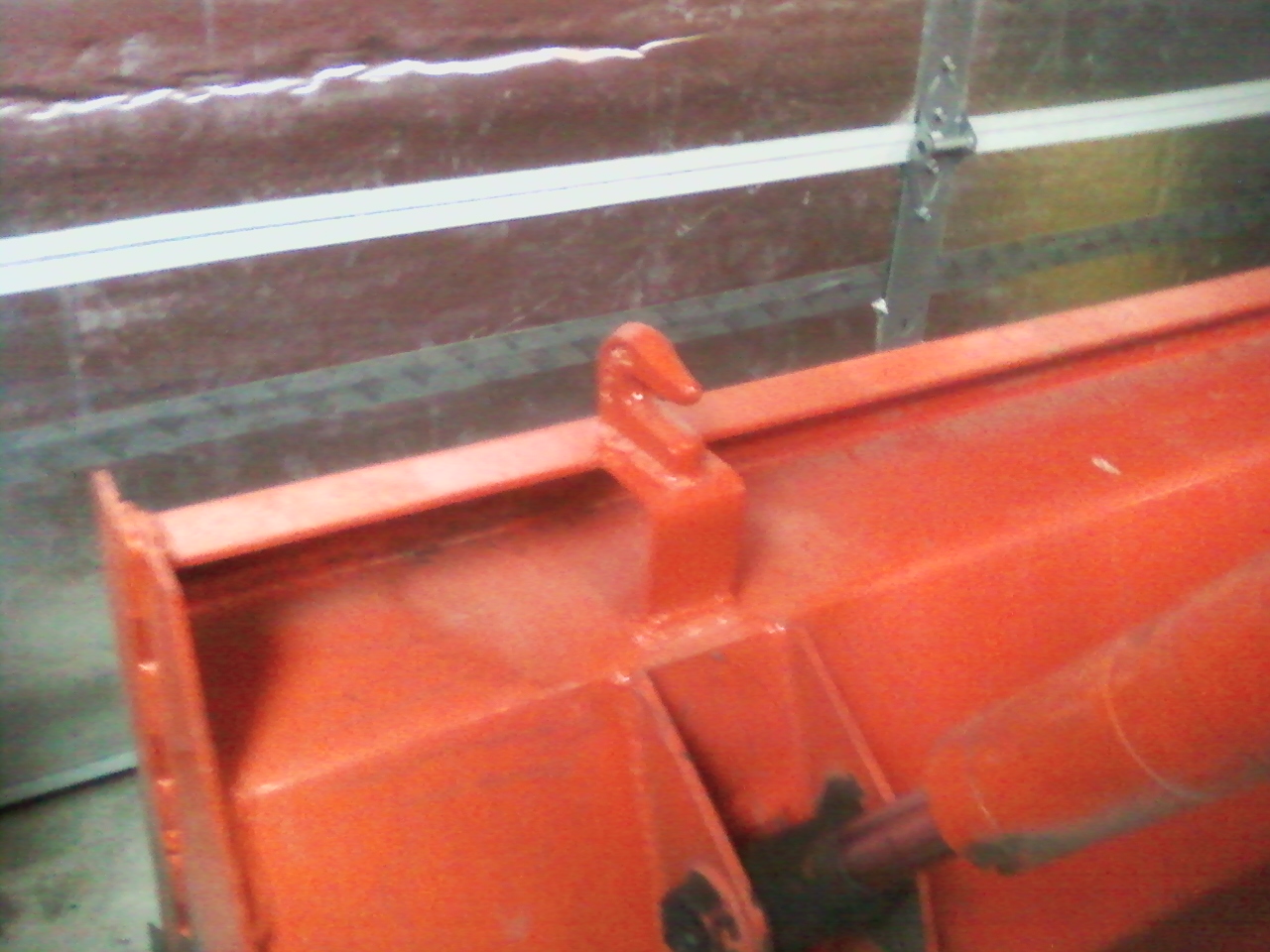

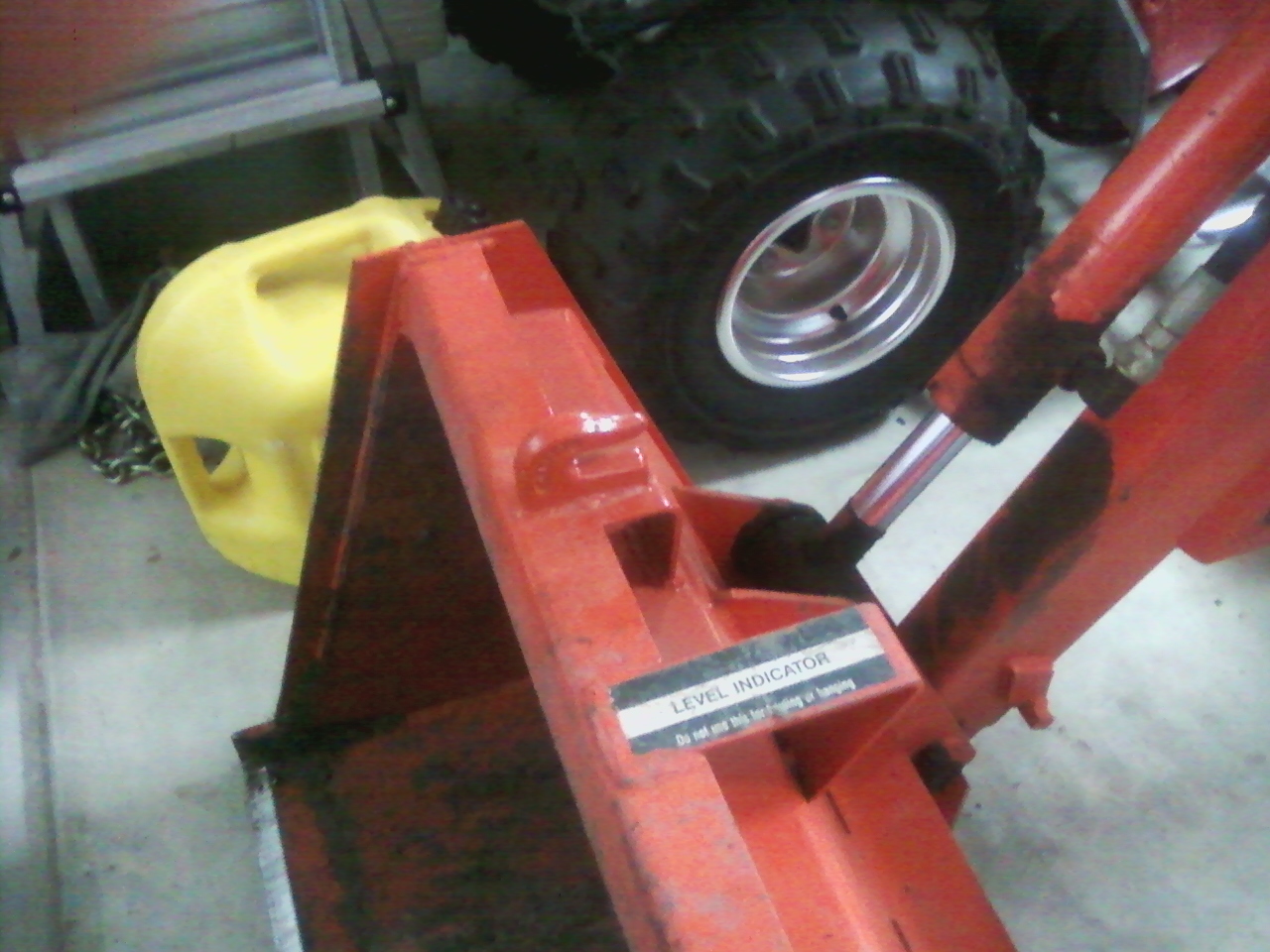

Here is another option that minimizes add-on weight.
yep that looks good too, but I needed top chunk of steel for 2 other reasons, One was to tie into the SSQA backplate I was welding on at the time to tie it all together and Two I have ideas of maybe putting a 2 inch reciever in the middle for other uses.
