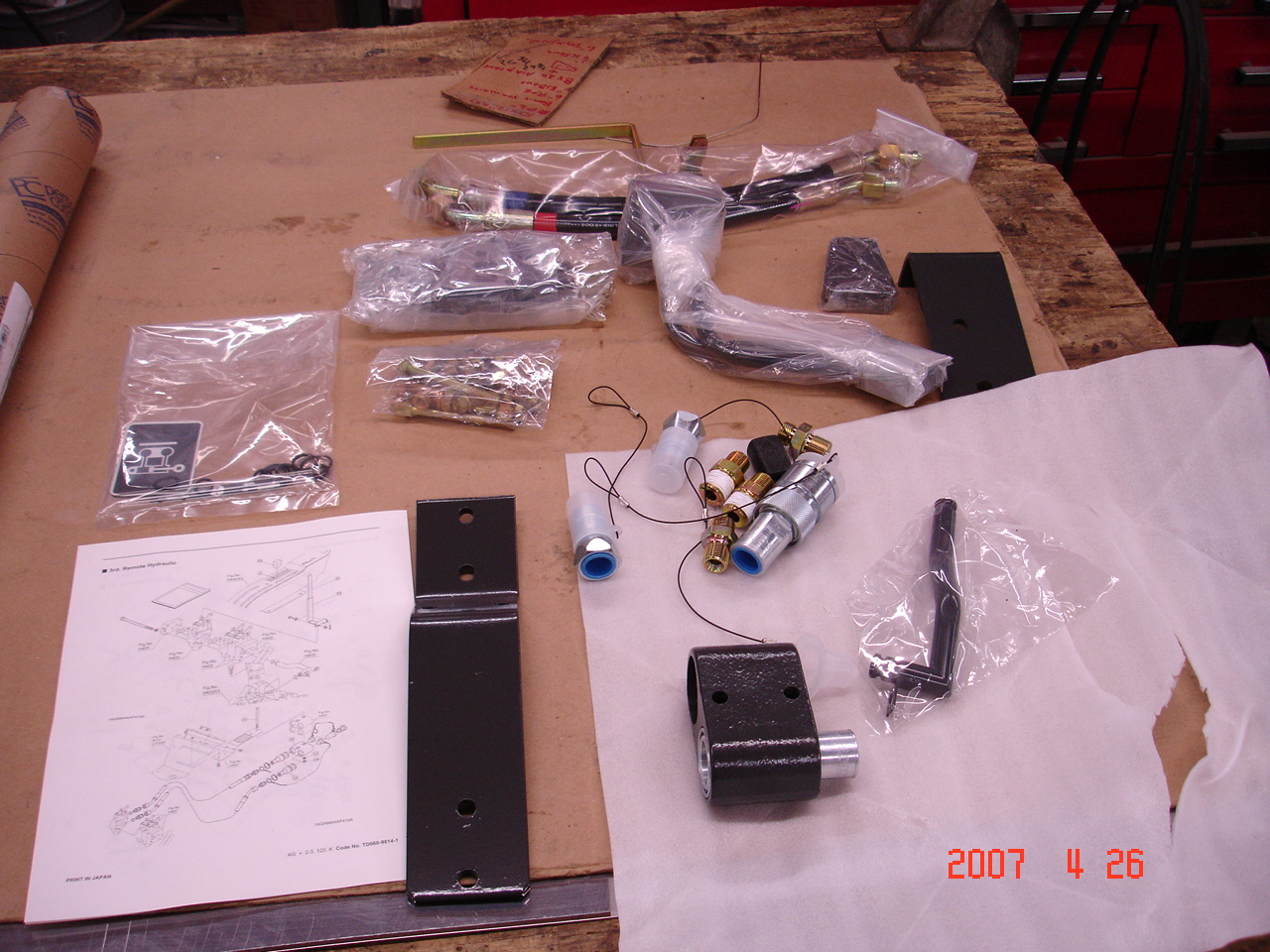

Well guys I'm back! I'm going to upload some pics if anyone is still interested?
I ran into trouble with the install that I will go over. This is what the kit looks like.

Bill,
Good luck with the installation. Glade you finally got all of your parts. Keep us up to date with photos.
An old farmer friend of mine once told me that the difficulty factor for any mechanical project was based on how many sheets of plywood it took to lay out all the parts needed for the job. It looks to me like you have a one sheet project.
RPK

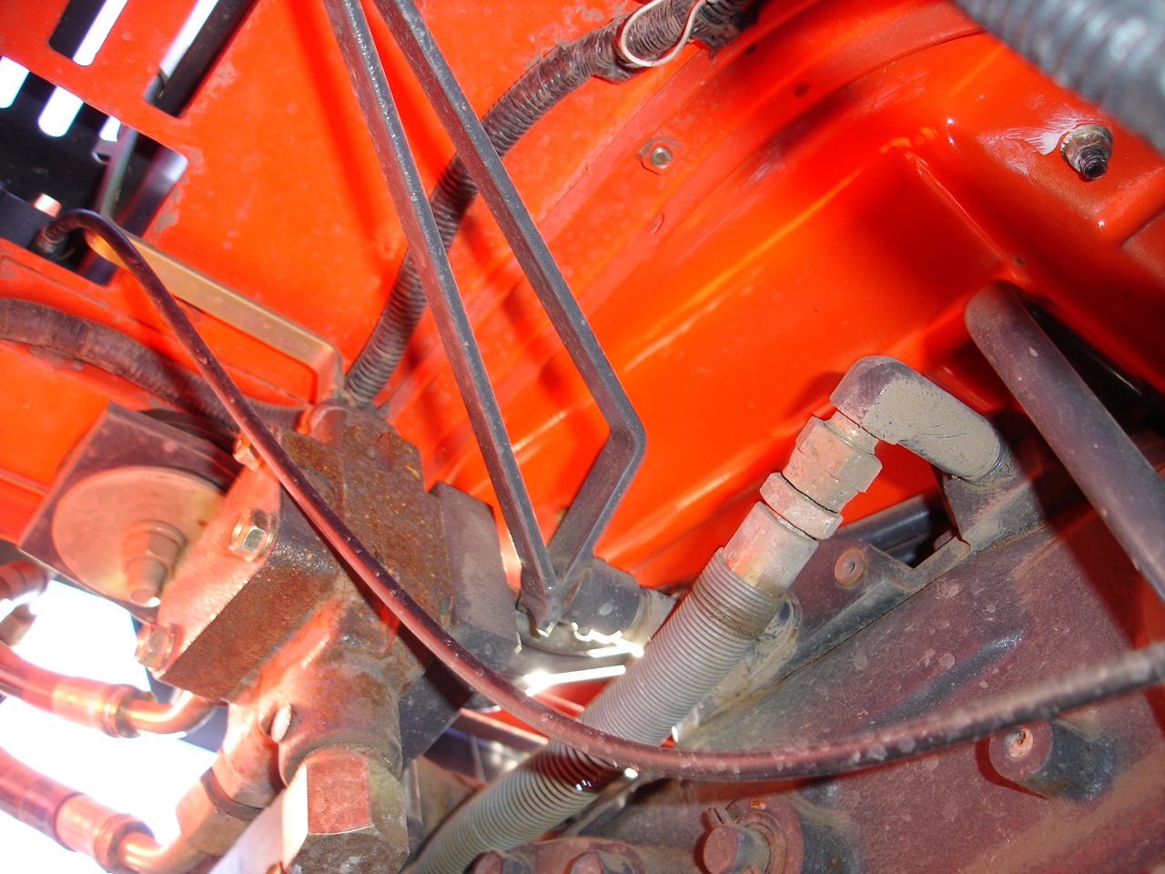

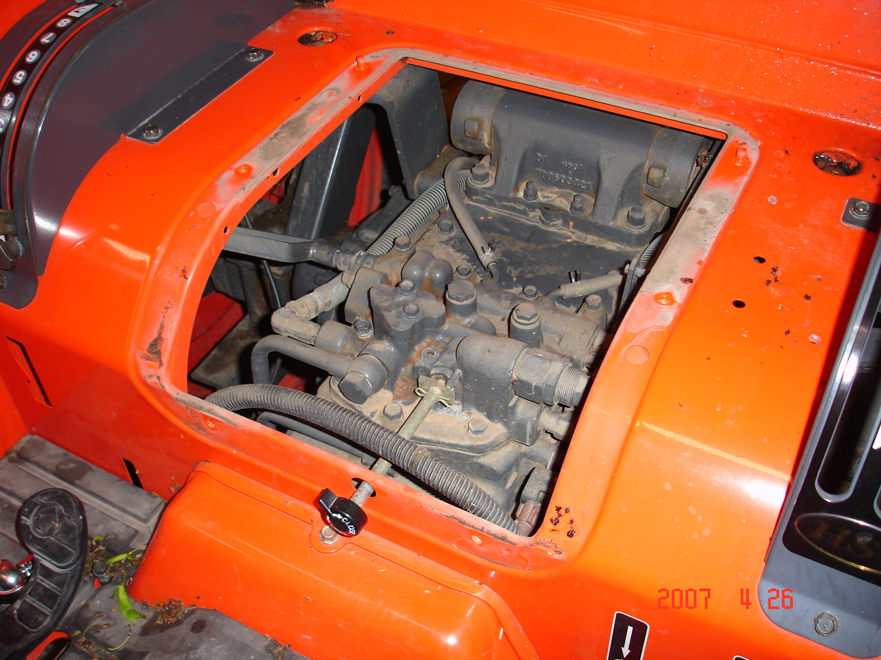

#27
I read the instructions all the way through, then looked at how everything fit. I decided to assemble as much as I could on the bench. I didn't remove the rear tire like some one suggested, I think the little inconvenience out weighed the extra work of removing the tire.

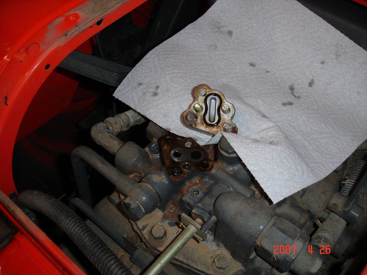

Thanks tex, mine was dead center. My problem was I had a bad casting, or something got under the plate on the cylinder control center and ate the cast, look at the pic with the cover off. It's on now with two bolts and needs three. Dealer is ordering a new casting. For guys that haven't done this, these pic are under the seat where most of the work is done.

Up date, I just got my valve body to replace the stripped bolt holes. I told my dealer that I would change it at my next major service. Also a couple pics for justcountry, and welcome to TBN.
