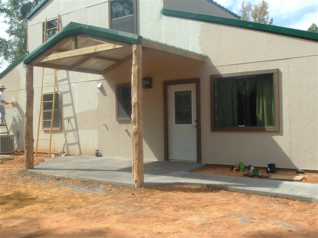

I had a wood pole barn built 2 years ago and chose not to have any ground level windows since I don't live at that property yet. A guy I work with had windows replaced in his house and gave me 16 window sashes (wood frame, double glazed). Any thoughts on the best way to install them? I'll probably want to hinge some of them for ventilation.

I took a stab at making a window jamb last night. I like the idea of having a unit that could be installed in a rough opening. Sort of like the windows used in new construction that have a flange. Cut a rough opening, slide unit in, caulk it and screw it in place.
I used 2x4's for the frame, 1x3 barn wood for the flange and hinged the top of the window to the top of the jamb. It turned out OK but I think I need to use 1x4 instead of 1x3 for the flange so that I have more wood to attach the unit to the barn. If I go with this design I'll use jack studs to help support the unit.

Rob,
Something to consider is that 45 degree miters on windows, and homes in general have a way of opening up over the years and letting water in. If you absolutley want 45's, then be sure to glue them together, seal the heck out of them and keep an eye on them on a regular bases. When the wood shrinks or moves, this opening will let water in.
I like to trim out windows with a straight piece cut to the windows width at the bottom first. Then From the bottom edge of that piece to the top of the widow is how long I make the sides, and the top goes from the outside edge of both side pieces of trim. The way it was told to me was that if the seam comes apart, the water will not be channeled into the window or behind the siding since the top piece of the trim is wider then the window and any water that gets on top of it will go off to the sides.
I don't have any good pictures of any windows that I've trimmed out, but this one shows it if you look close.
Also, from what I can tell in your picture of your barn, it looks like pole construction with purlins. Jack studs are to support a header above the window when stud framing a building, and designed to carry the load over that opening. In your situation, there is no load over the window.
Instead of jack studs, you might consider larger purlins to stiffen up the wall where you cut your opening. In fact, I'm thinking that a 2x6 purlin across the top and bottom of your window opening would also make a good frame for the window itself.
Eddie
Eddie
Eddie, good point about the 45 degree miters. I like the way they look but I don't want to ask for water problems. I think I'll trim them the way you suggested. Also, I used the term "jack studs" loosely. What I really was trying to do is give additional suport to the unit with 2 2"x4"'s running from the bottom of the window unit down to the next purlin.
I thought about using purlins for the opening and mounting the window on them but then the window sash would stand back from the exterior barn wall.
