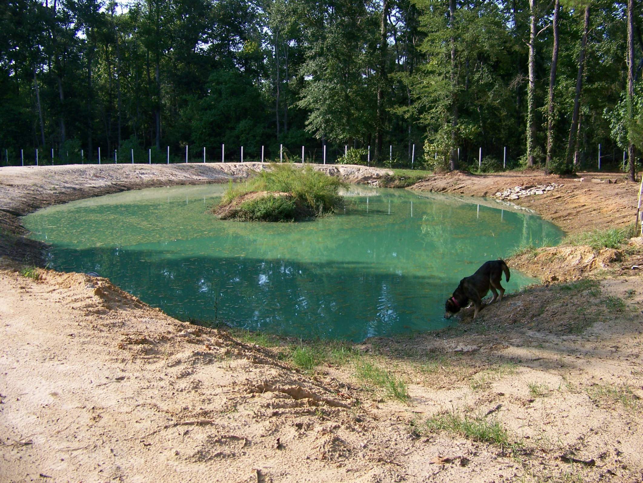

Friday, I knocked down the top crown of the dam so the dump truck has a flat surface to load on. I then started taking out the end of the dam down to the water line. 10-14-16 Taking Dam Out.jpg10-14-06 Dam Coming Out by Sump Hole.jpg
This stake by Fritz is my full water line. 10-14-16 Pond Full Water Marker and Fritz.jpg This is where I'll take the CAT down into the pond's basin.

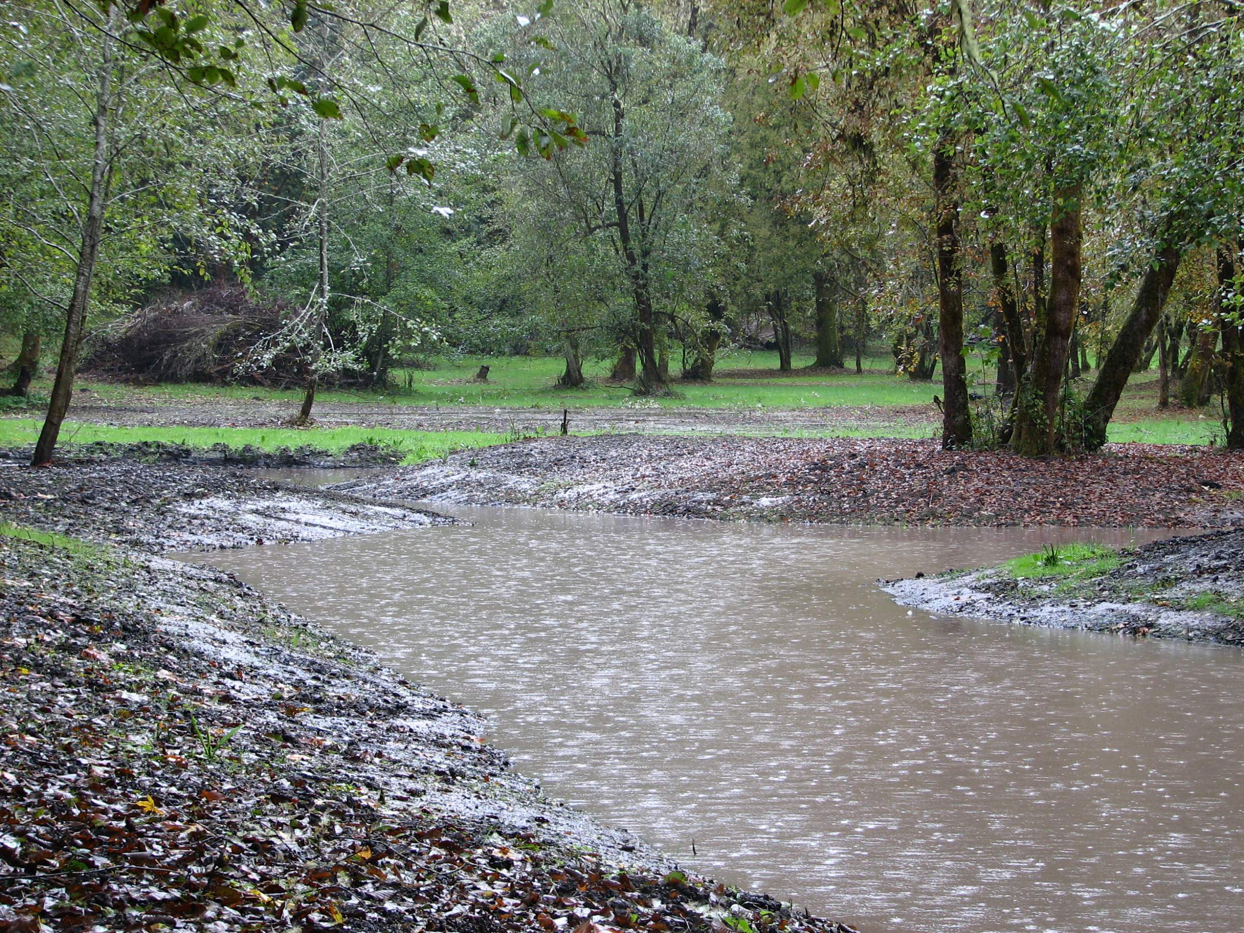

Last weekend I was able to continue removing the dam and giving the bank a rough slope. 10-30-16 Dam Removal and Bank Sloped.jpg Once the dam is cut back, I'll go back and finish the slope.
