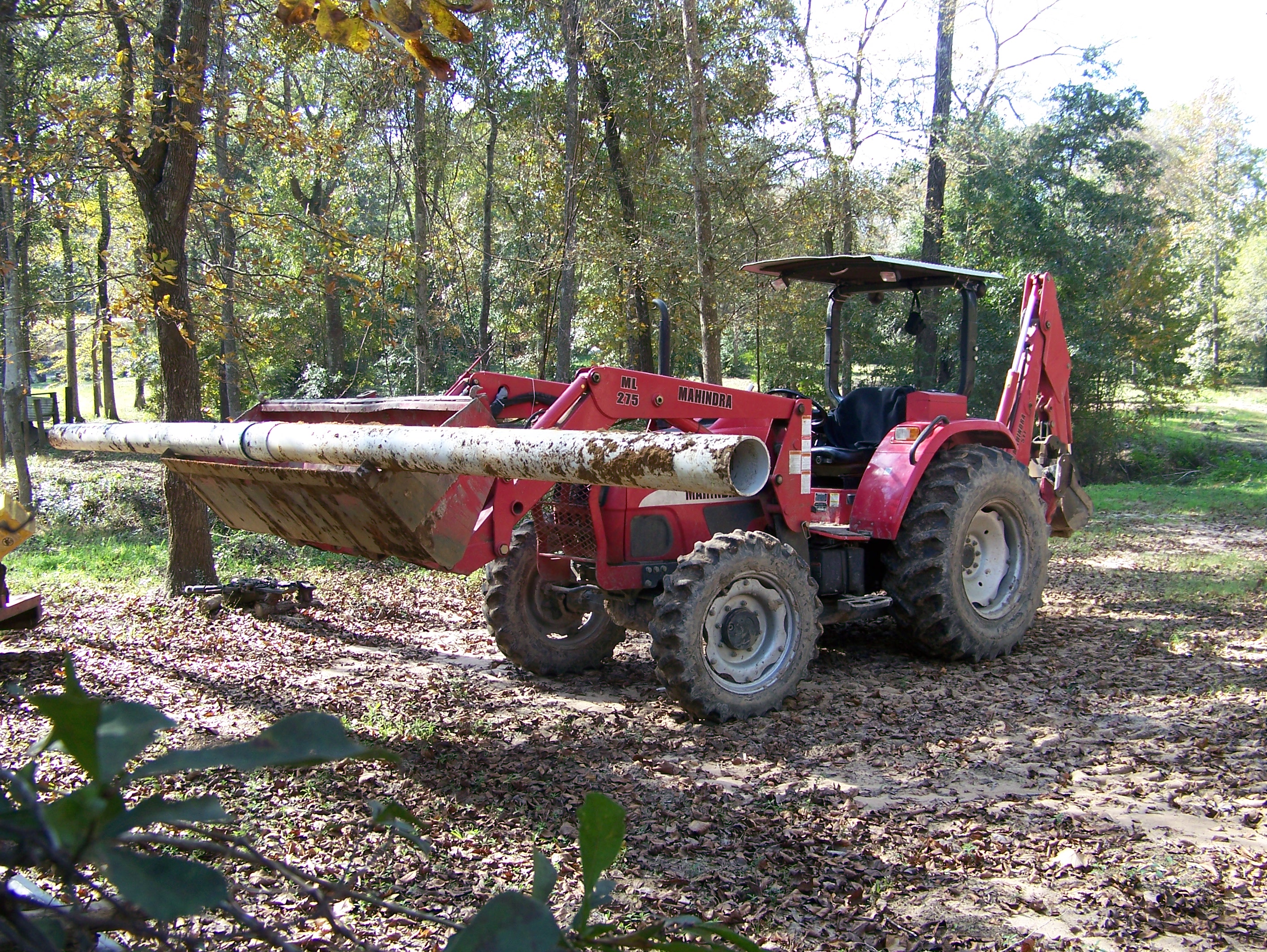

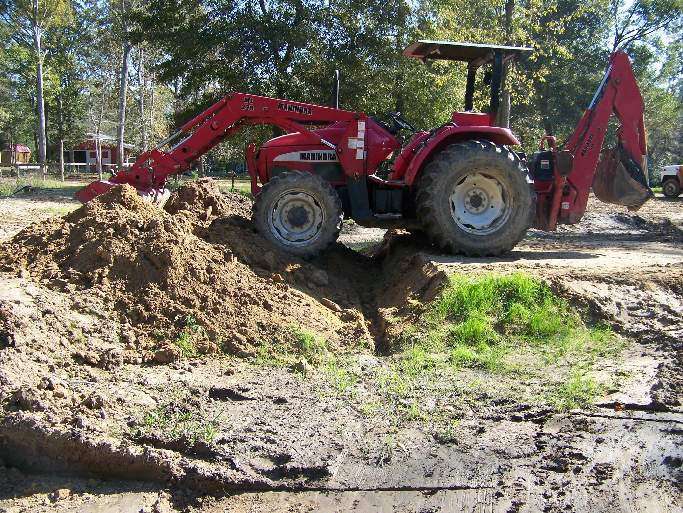

I also went ahead and took out the tempoary ramp culvert. 11-27-16 Temp Ramp Culvert Removed.jpg
...............and played with the Mahindra while filling in where the culvert was.11-27-16 Filling In Temp Culvert Ditch.jpg
hugs, Brandi

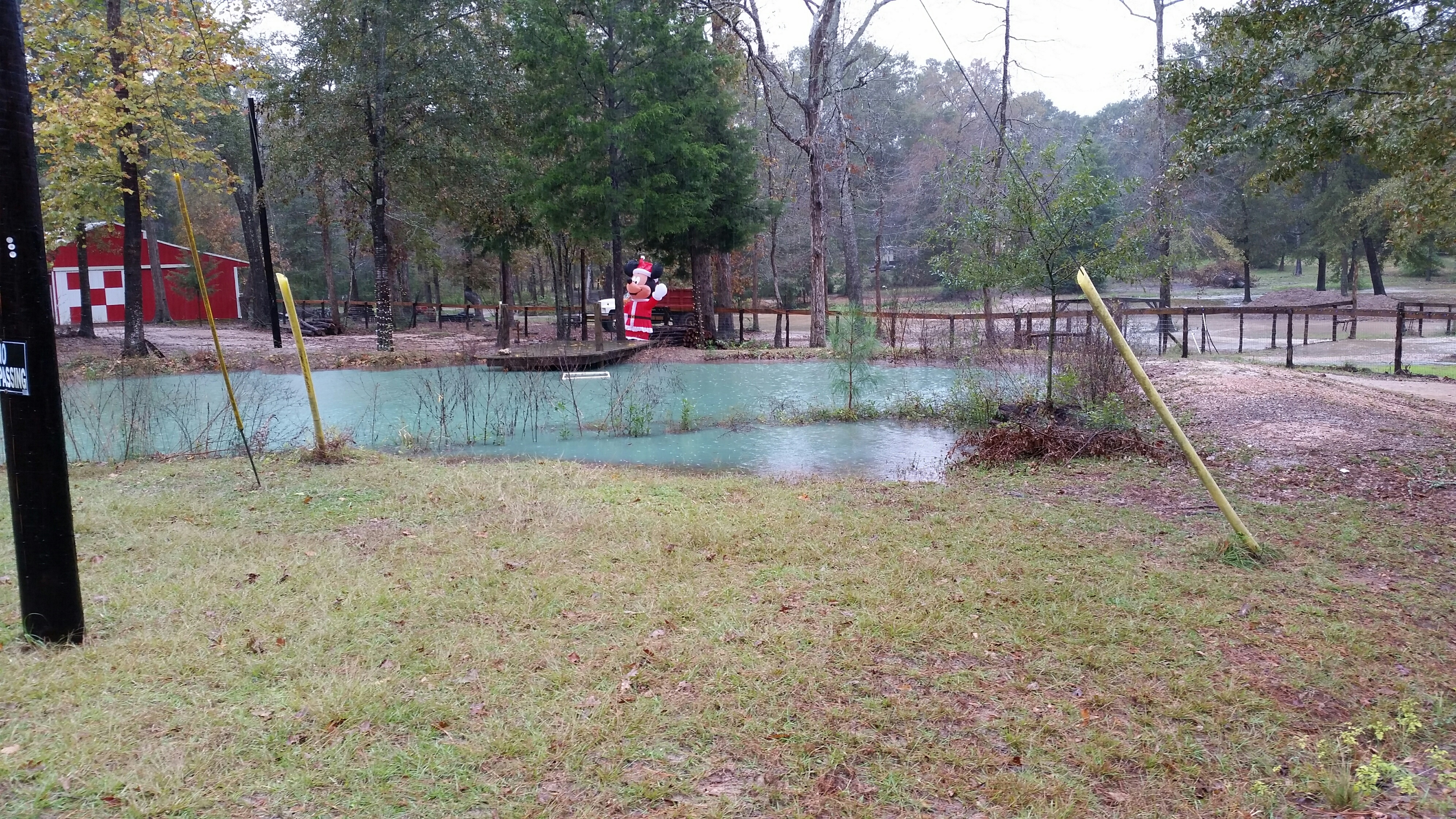

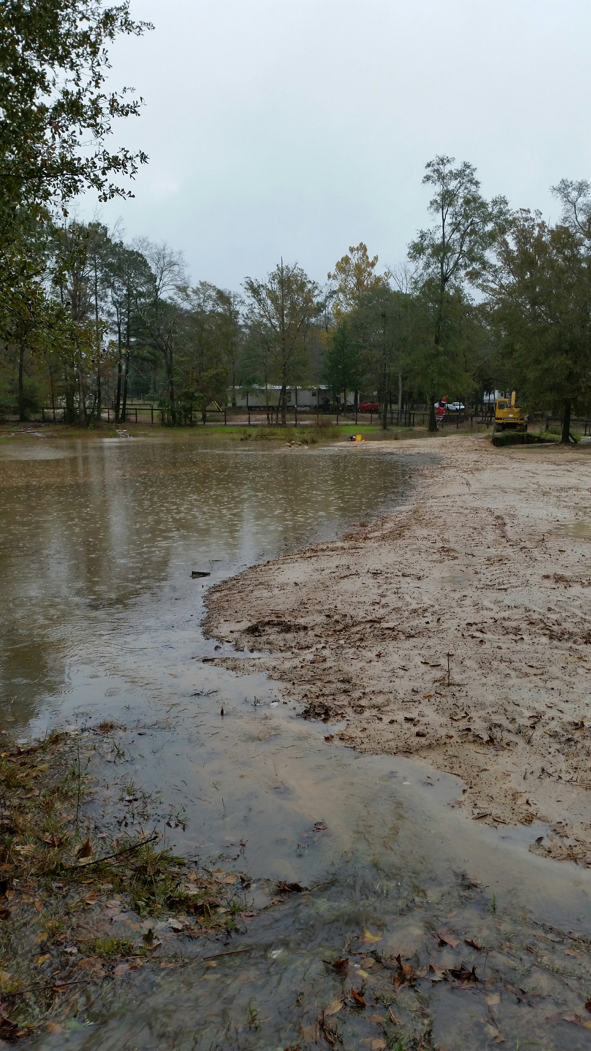

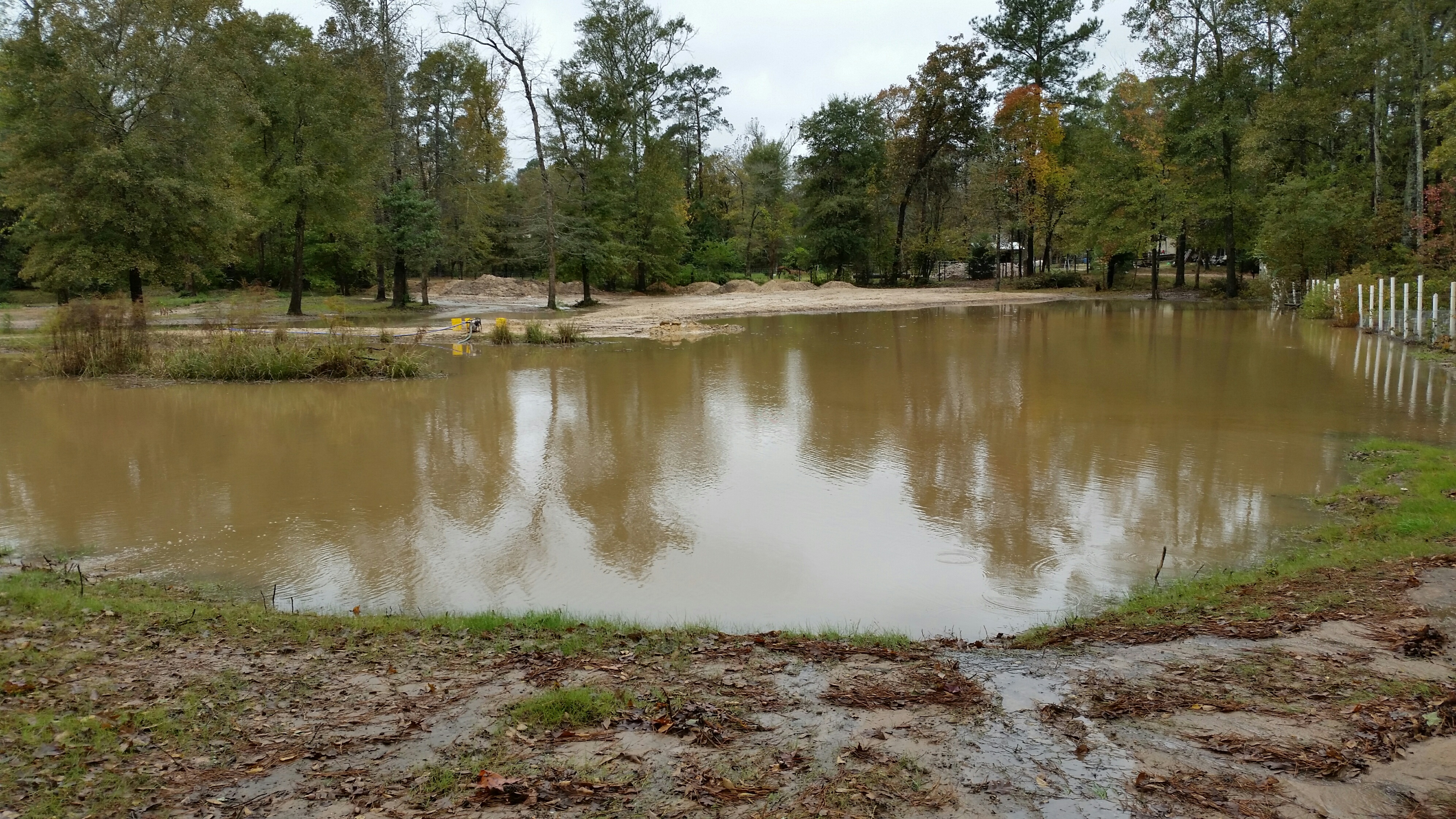

Well, it happened again. Just like back in 2012 when I first dug the pond, rain filled the pond before the dam was finished. Glad I took my time with the Mahindra and packed every inch of the new dam. 5 inches of rain yesterday filled the pond. I woke up and saw the water level and became scared. I was afraid I had made a mistake and it was over the private road at the corner of my property. But when looked at up close, was 3 foot lower than the road.
I am really thankful to the Lord for filling the pond at this time. I can now stake and flag around the new shoreline when the water level drops to just at the full level culvert. I won't have to bring out and use the water hose level to check the water line at full water elevation.
12-3-16 Water Pump and Full Pond.jpg12-3-16 Pond Full Before Remodel Finished.jpg12-3-16 Full Pond From Driveway.jpg12-3-16 Full Pond Best Photo.jpg
hugs, Brandi

Here is a photo from yesterday of the small pond. It is about 30x70 feet. I built it in 2009.12-3-16 Small Pond Overflowing.jpg

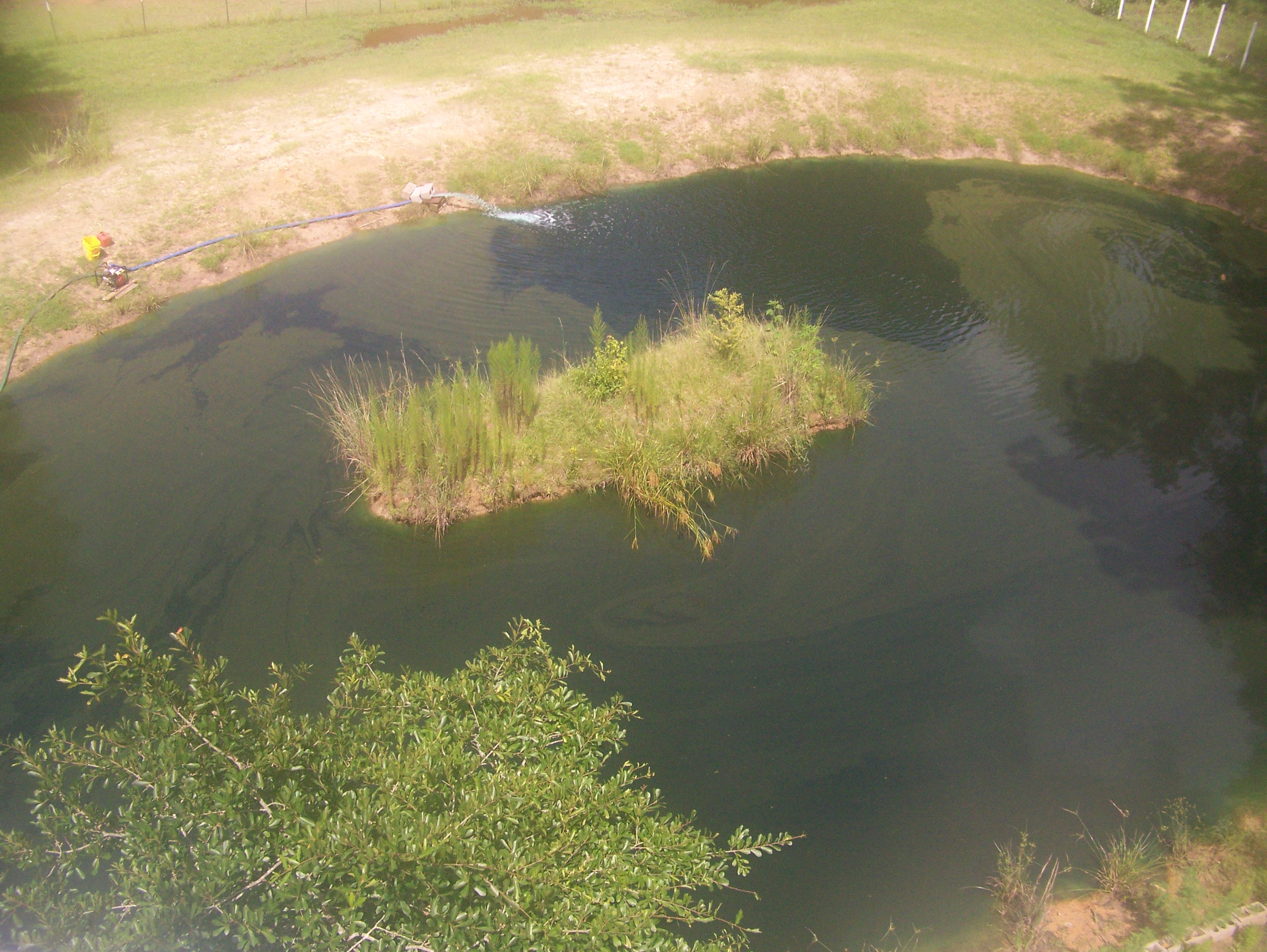

The island pond is my second pond.7-4-15 Island Bird's Eye View.jpg Built in 2012 and dug out deeper in 2013. This is the pond I am working on enlarging now. Basically, I have removed the right half of the C shaped dam and am making a straight dam starting just above where the waterpump is. At the tall clump of grass. This is where the end of the bulkhead is for the tree that you can see it's shade in the upper left corner. The "new" straight section of dam is maybe........250 feet. When finished, the pond will be a huge triangle.

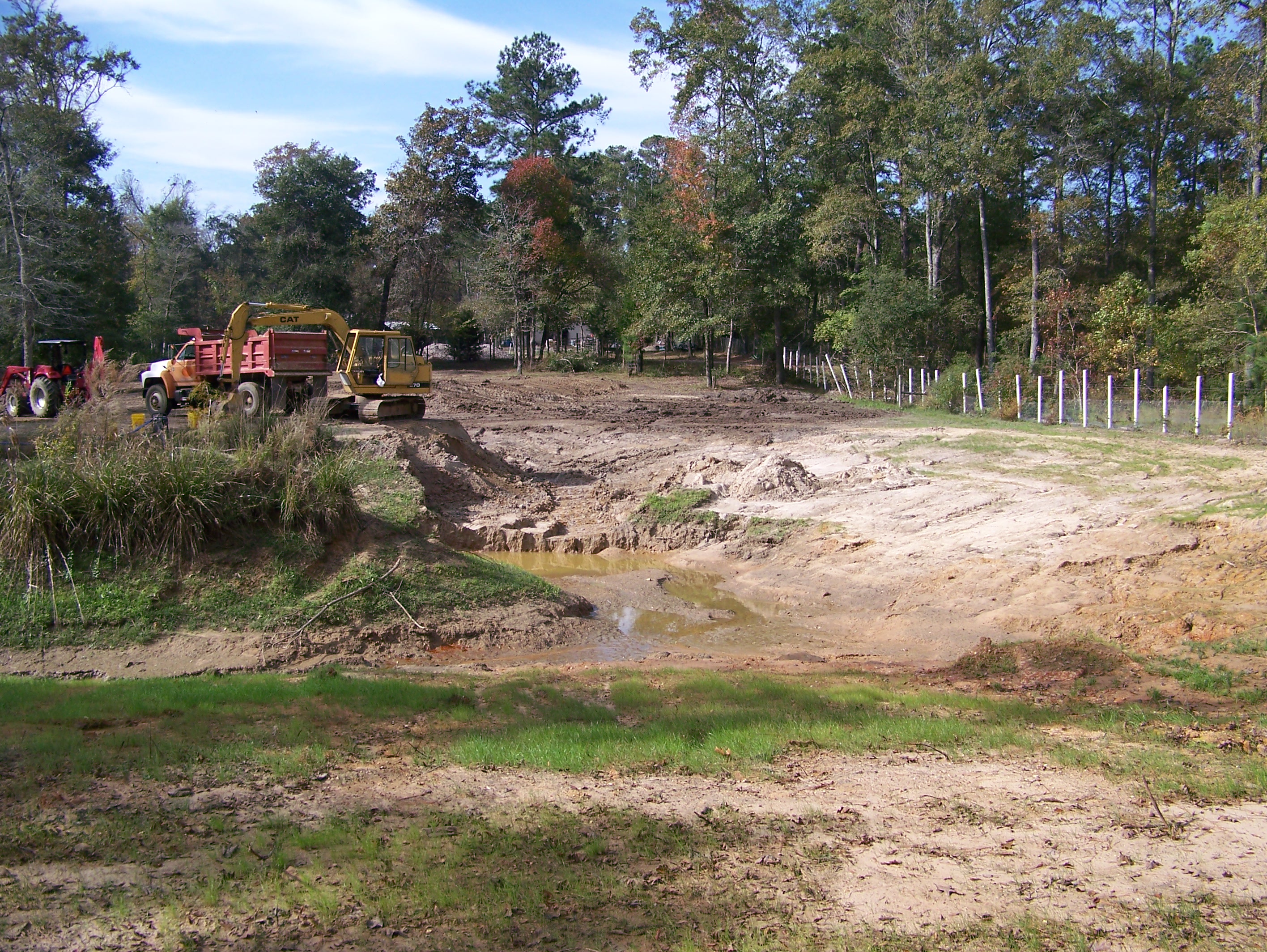

In this photo you can see the island and just a little of the old dam that needs to be removed.12-3-16 Full Pond Best Photo.jpg It has about 30 feet more needing removed. Right now it is about 10-11 feet deep just right of the island. About 8-9 feet deep just off of the end of the dam that will be removed and around 2-3 feet deep along the straight dam. Up in the corner it is about a foot deep. Here it is empty.11-27-16 Pond Getting Larger.jpg
I haven't any clue as to the size. I haven't stepped off any measurements yet. I do know the old C shaped dam was about 300 feet long. I'm guessing when finsihed I will have about 450 feet of dam.

Hahaha...in 5 years I might be "remodeling" it again. Thanks. I am happy. But the water level is a little high and puts water on the neighbor's low spot. I may have to notch out the bottom of the overflow pipe. Water is still flowing into the pond from 4 different routes, so I wait. I have flagged stakes ready to install along the waterline when water quits flowing out the full level culvert, for further reference.
