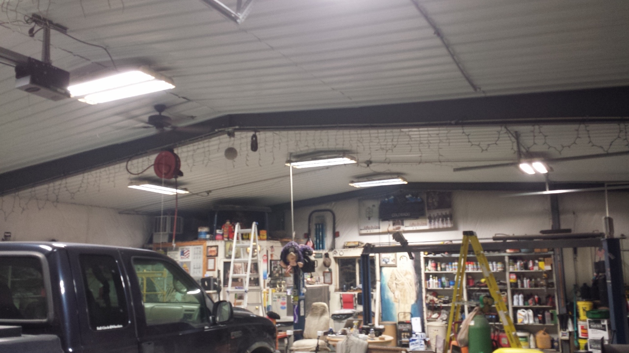

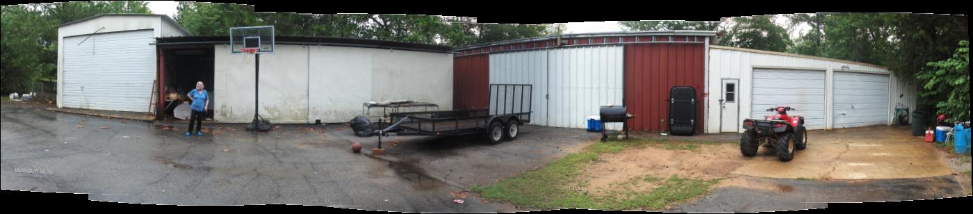

The cost is one of those one shot, swallow hard and do it kind of things. From my perspective, the time you save by not having to finish and paint the ceiling is worth a lot. And you probably won't have to paint it for the life of the building. The upside down install isn't really an issue. A drywall lift will handle the metal and weight is minimal, even with 16 foot pieces. I think the metal will go up in a fraction of time of other options.
Kenny nailed it again!!! I bought my ceiling metal from and Amish shop near here. They call it liner panel. Has cheaper grade paint with no fading guarantee. Pretty hard to get fading inside a shop. As for hanging it, did mine myself with a $150 drywall lift. Cheapest hired hand I've ever had.
My building is 42x50 and I think my metal was around $800. I'm sure it was less than $1000. I'll never touch my ceiling again. And as mentioned looks great.
