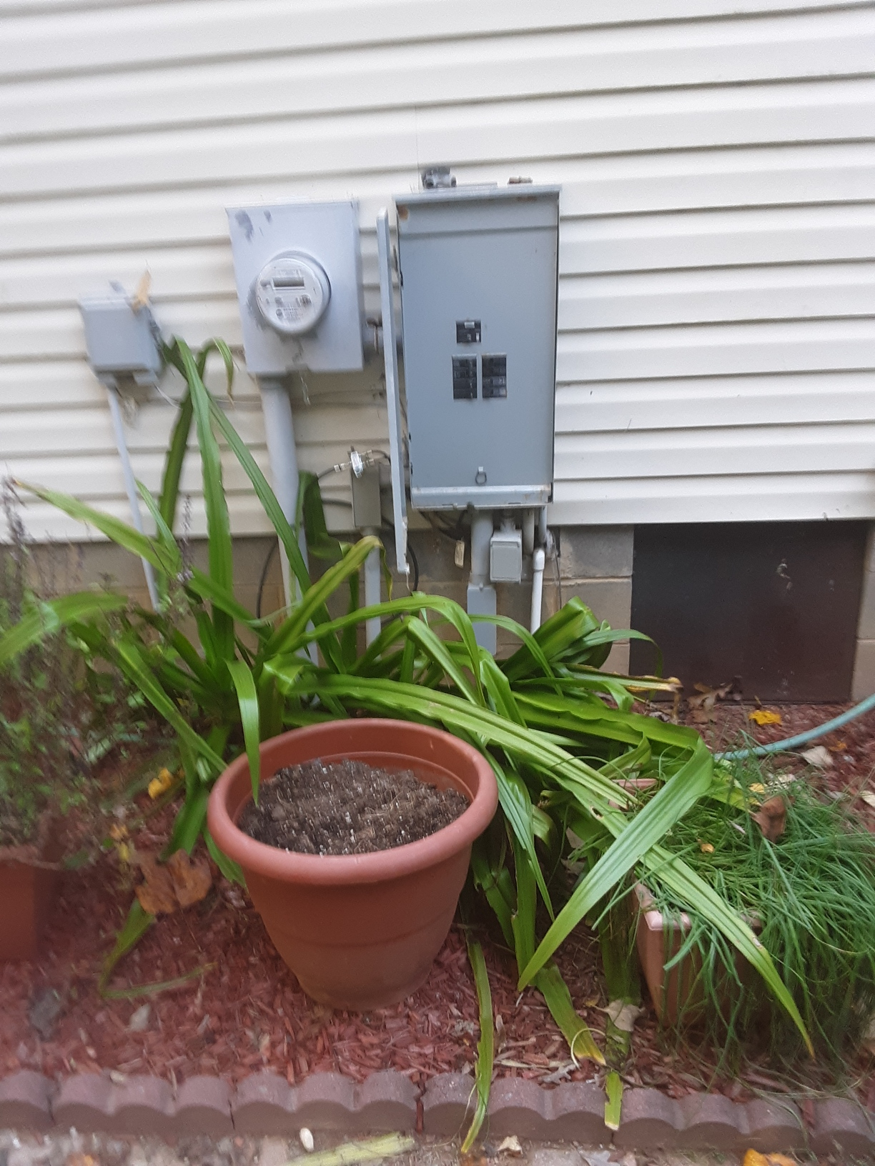

We too have our service entrance panel (with meter) about 350' from our home. Our service entrance panel has a built in generator disconnect that keeps our generator near that panel. Walking up and connecting and starting up the generator is one thing, but wondering when the power has been restored is difficult when we live in a remote area where we cannot easily see if any neighbors are back on. Wiring some easily noticeable lamp of some sort to attach on the panel on the service side of the main disconnect to be able to "see" when service is restored would be awesome, but would be challenging to install without pulling the meter which would also require breaking a seal. Some sort of inductive pickup to "connect" to that would be pretty cool, but I cannot find anything like that.

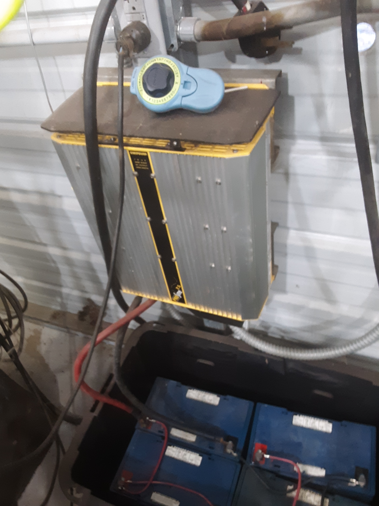

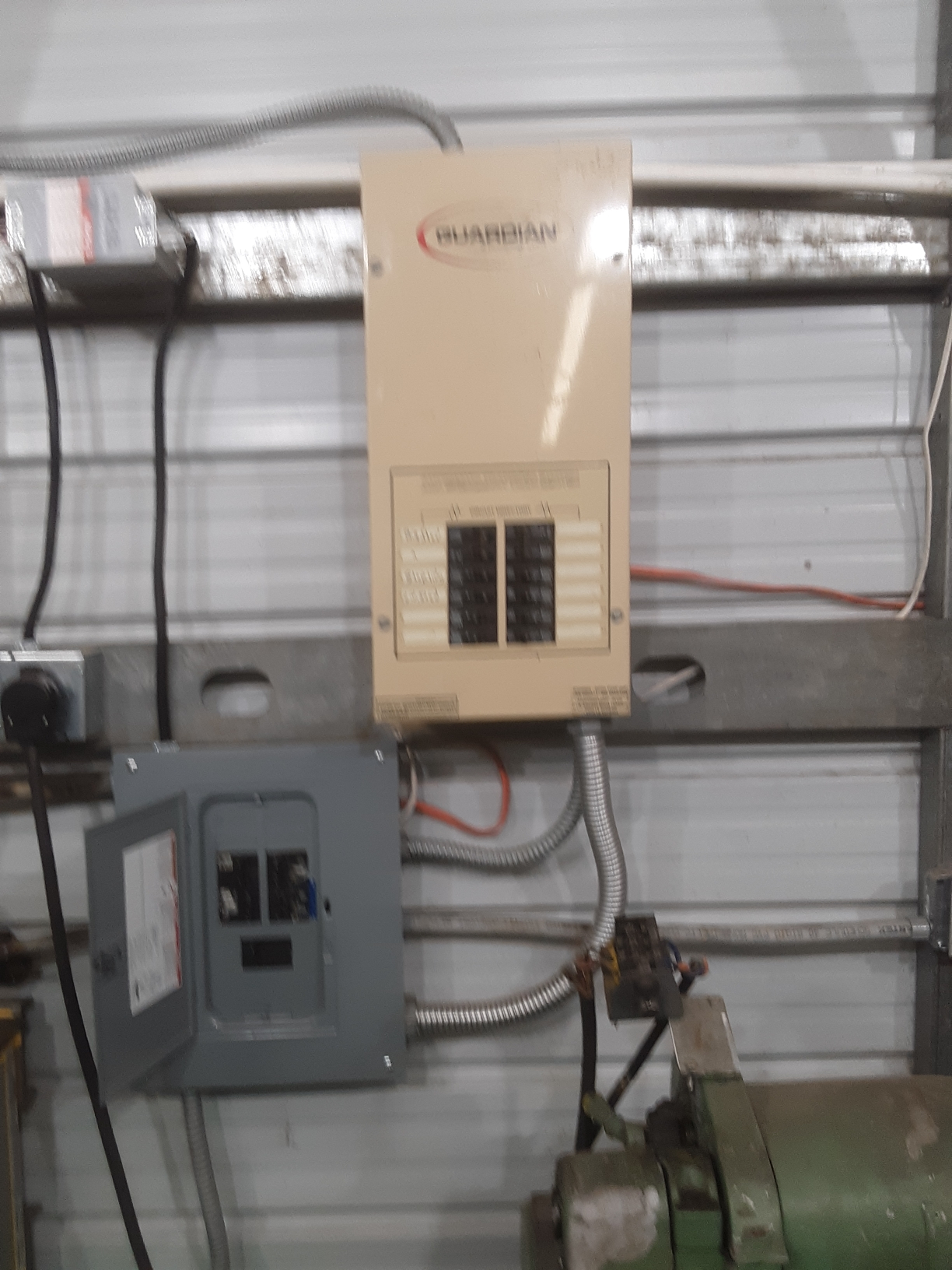

Someone had put in a breaker box and 30amp hookup for a camper before I bought the house. I changed out the plug and now use it for when the power goes out. I have to flip the 200amp main breaker before pluging in the generator. Two years ago I was able to pretty much run the entire house off a 8000w gen. I would turn off things like the hot water heater, well pump and sometimes the furnace, just depending on what we needed at the time. Neighbors where jealous, they could smell the bacon frying in the morning and see the lights on. Power was out for 2 and a half days. Since then, I added a battery backup system just for lights in my shop and sheds. I have a freezer in one shed and enough battery backup for 4 or 5 days to keep the freezer running. The batteries charge using grid power, I have a guardian brand transer switch wired in that cuts power from the main and the charger/inverter converts the 12v batteries to 120vac. I wired the shop and shed lights, as well as wall outlets to the run on grid power, but then battery via the transfer switch. I havent had to use the system yet, but I can test it by just flipping the main breaker that feeds the shop.

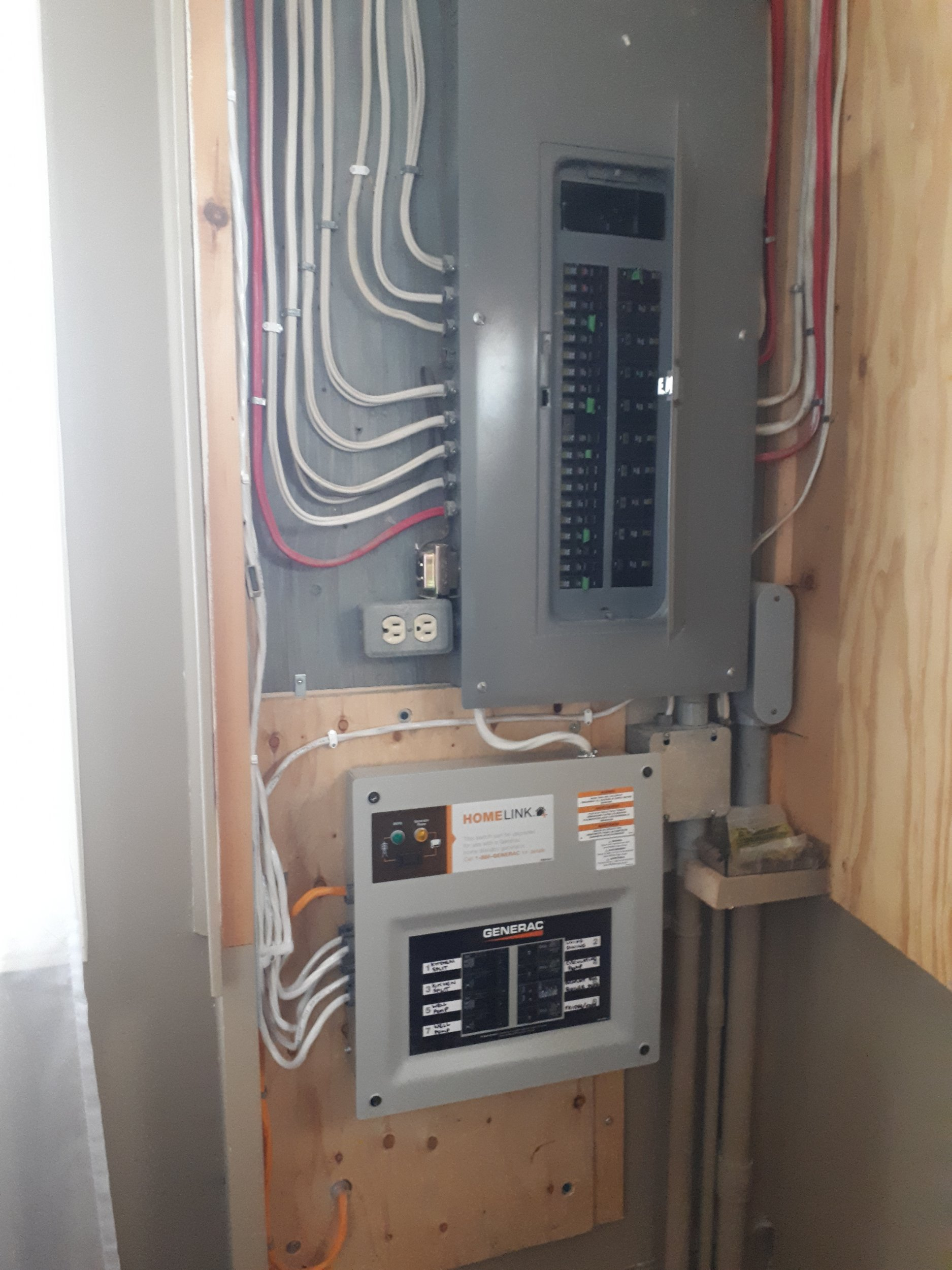

I went the Generac route due to my ignorance about availability of the Generlink meter plug in my area . So Generac did the pony panel seen with 8 circuits of my choice and switchover with lights so I will know when power comes back on. With 10,000 watt Generac Gas Generator ( elec start) It took two electricians 8hrs to complete, included drilling thru 12 inches of basement concrete wall . So far only one power outage to try it out for real, and that was only 30 minutes :) . But still having it is like an insurance policy and peace of mind it gives to know that a Canadian Winter power outage is feasible to get thru now. 20220223_122230.jpg20220223_122256.jpg
