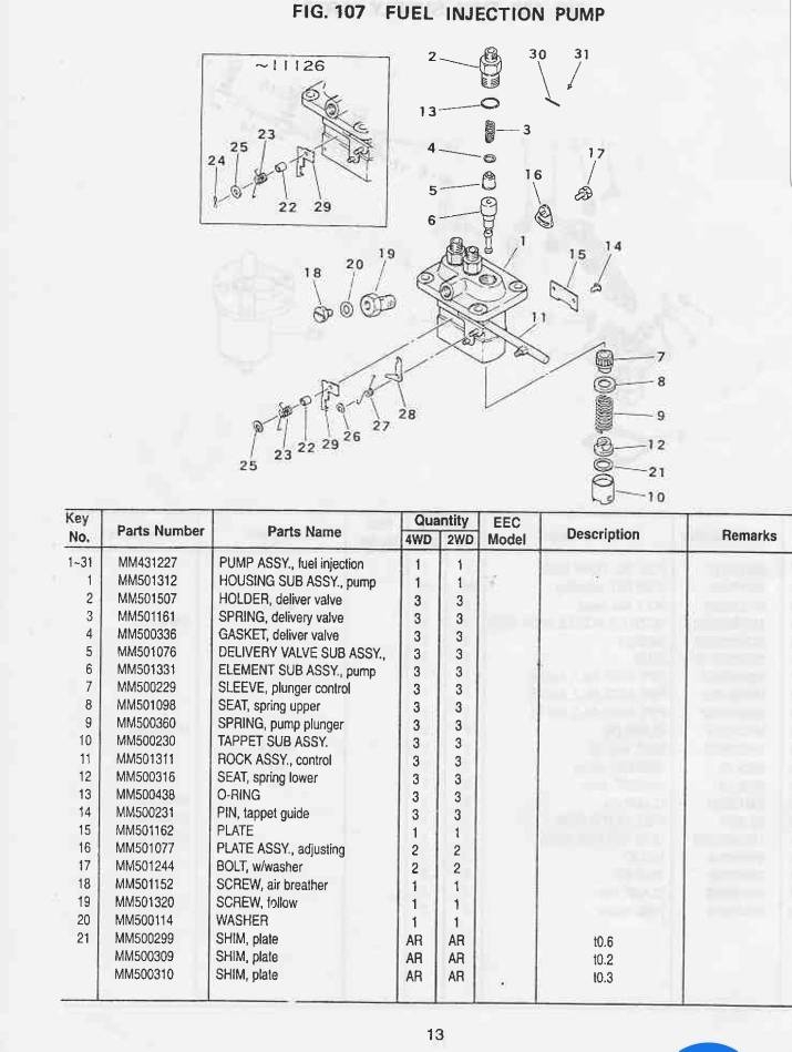

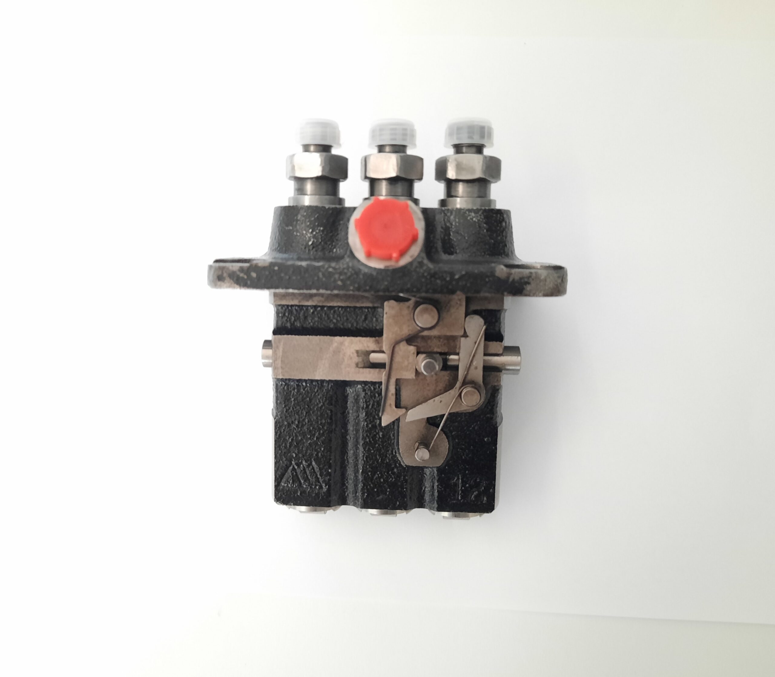

Hi all, I have a international 234 compact tractor with a Mitsubishi K3B 3 cyl diesel. had a external leak at the injection pump, replaced all 3 Orings which solved the problem, now the engine won't shut down and runs wide open. I removed the pump and cleaned it up, inspection shows no broken or stuck parts. I need info on how to time the 3 small gears that turn fuel off and attaches to the rock shaft. I own a shop manual but it does not cover that part. the # on the pump is #094500-2190, they call it a cambox pump. THE 2 PARTS I NEED TO TIME IS # 11 (rock shaft) & # 7 sleeve-plunger control

Two things. Not only the timing to set, you need to ensure the governor was not affected by the removal or install of the fuel pump. This would make the engine run in full throttle. I think item-11 you had pointed out could be the issue here.
The Yanmar fuel pumps are very much the same in that era. Likewise the Shibaura too.

thanks for the input. I did find the timing marks on the rock shaft and the (gears #7). I just assembled it and now waiting on the anaerobic- sealant I ordered. will reinstall monday and cross my fingers. everything seemed to look and go
together pretty well. I am got to keep the master pump builders Email. just in case and for future problems. also thanx on the heads up on the Mitsubishi section.

installed the pump this morning and hooked up the Tie rod inside the pump and noticed the rod will not move. how to free up the Governor? I hope I won't have to pull the timing cover off the front of the engine. looks like a huge job.
   / international 234 mitsubishi K3B engine,
re inspected & somebody hooked the tie rod from the Governor to a pivot post for a lever instead of the pin for the rock shaft. Im not saying any names !! fired it up, ran great, no more running wide open.. running on 2 cylinders. now no fuel coming out of the port of the pump for # 3 cylinder. pulled the pump again and getting ready to inspect # 3 port on the pump.
